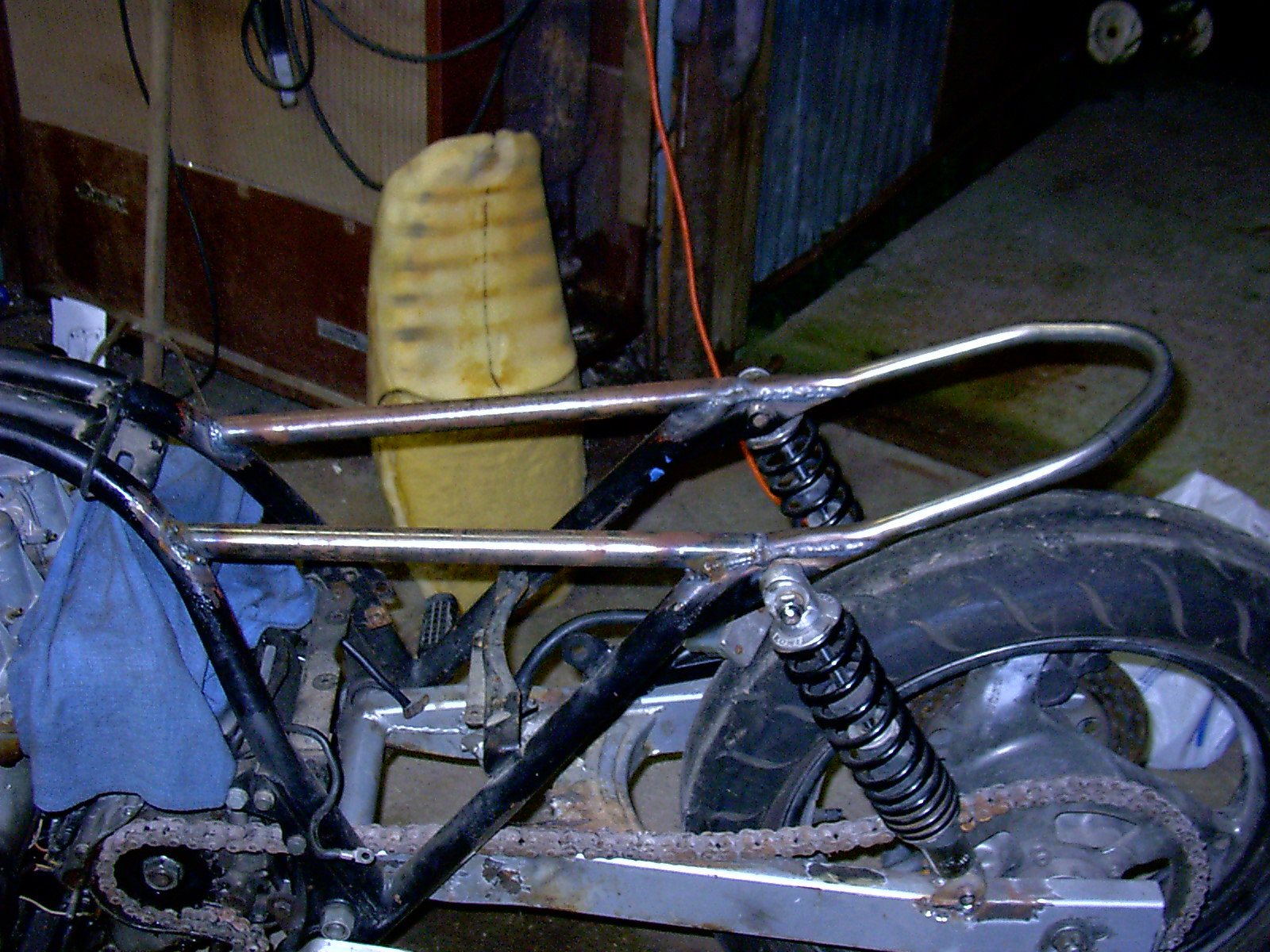

Well Im not shy to do some cutting and welding. Def had to do it to get the rear shock and arm in there. Right now Im just waiting on my axle and tire to show up. Also a few odds and ends. Does anyone have some pictures and measurements of the mounting system? It would be a great help if so.

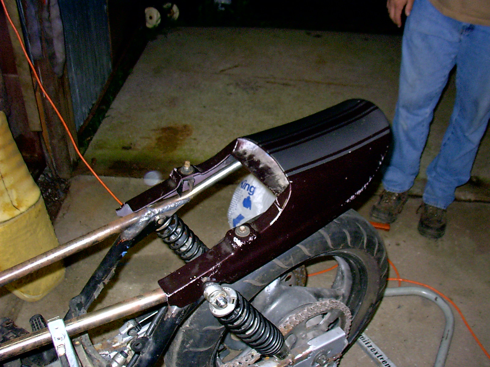

I still wanted to retain the original seat, ole lady loves it. So I made some changes to the under half of the frame and also cut out some plastic from the tail itself. I will have a buddy of mine do some glass work for me so that it looks better and more "original" This is how she is sitting as of last night, pardon the garage. lol.
Zero
Zero
