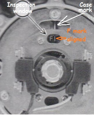

DesmoBro wrote: ...revs good in neutral but when I take it down the street it won't rev past 5k....
Might be a malfunctioning timing advancer, which is supposed to look like
And NOT like
Good Fortune! :)

is this what your speaking of? this is what mine looks like if it's the same thing...

DesmoBro wrote: is this what your speaking of? this is what mine looks like if it's the same thing...
Is that from the Titanic? :lol:
Appears to be a stock Kawasaki electronic ignition (used with a separate igniter).
The timing advancer unit is mostly hidden behind the mounting plate.
The timing marks on the advancer are viewed through the window on the mounting plate.
