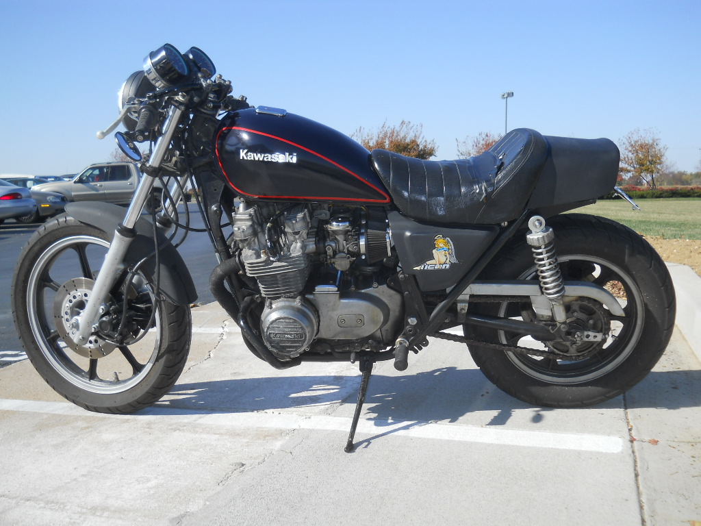

Welcome jaredthegeek, looks like you have a 1980 KZ750 H1 (LTD model with 2 pc seat).
The changes look good.

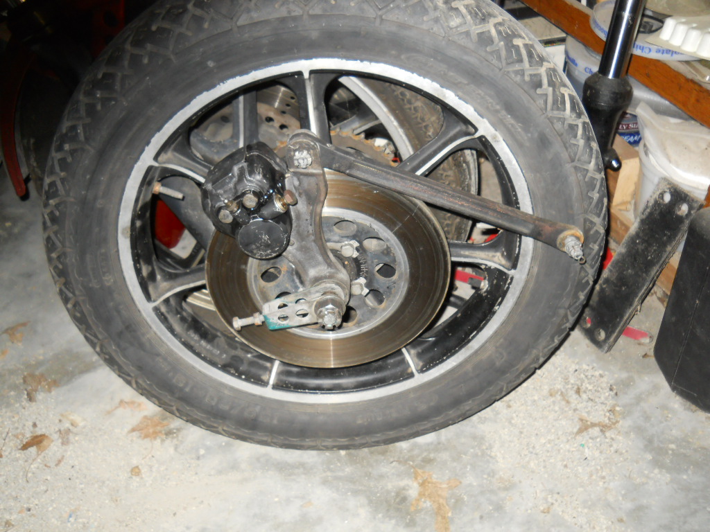

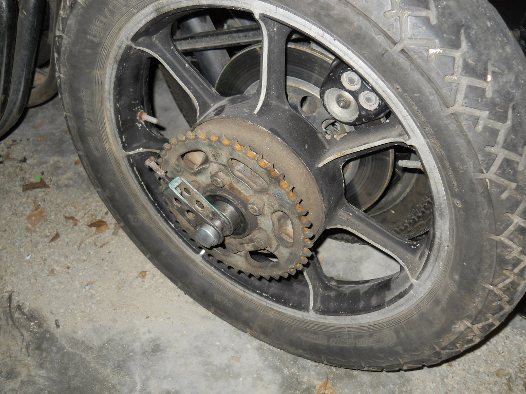

For the 18" rear wheel, look for one from a 650. Complete assembly (left spacer, cush drive, wheel, right spacer, disc and caliper with bracket and torque rod) will slip right in the swing arm and use the same axle diameter. The 750 has a 630 chain and sprockets and the 650 uses a 530.
I am using an assembly from a 78 KZ650 that I have test fit and am going to change the sprockets and chain to the 530 size.
I will post you some pictures tonight for ref.
