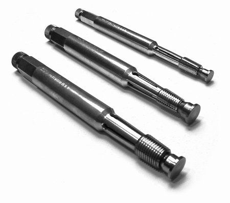

Thanks for the advice ! I have pulled the plugs and sprayed with PB Blast-just waiting for a new battery and the manual has already been ordered. Is there a way to prime the motor via the oil pump before cranking it over ?? I may have to pull the head anyway as the #2 plug was cross-threaded into the head :-(

rixtrix wrote: ... may have to pull the head anyway as the #2 plug was cross-threaded into the head....
Would consider a reverse tap (aka back-tap) tool that starts the re-threading at deep end of the hole where the threads are still good.
Does not require removal of the engine head.
Good Fortune! :)
