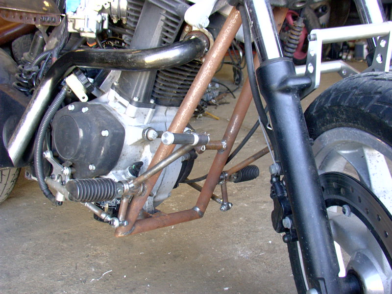

My engine mounts aren't in the ideal place to put some on, so I was going to get someone to weld a plate to my frame, then I was going to tap a hole, install TC brothers universal controls:
www.tcbroschoppers.com/store/index.php?m...ge=index&cPath=24_12
Weld up the seams, point the shift and brake levers straight down and cut off the excess so I have about 2"-3" hanging. then I was going to drill a hole through each one so I could and install the linkage, (like in Leon's pictures above). I haven't done it yet because I'm broke, but it's on the list!

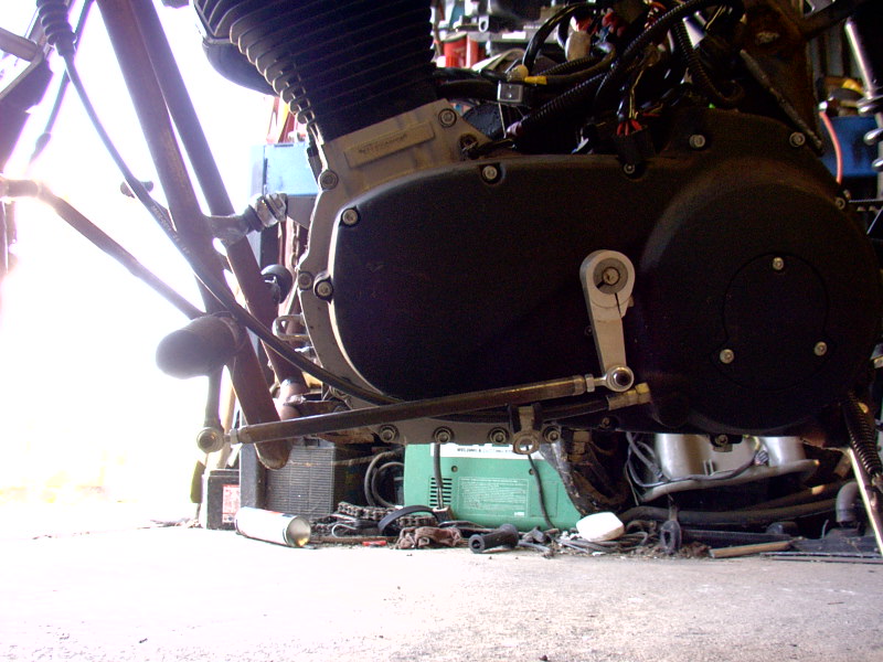

Here are some pics of where my motor mounts are, so I completely understand the issue which is partly the location of the exhaust pipes. The PDF file is one I got from another forum which was actually for Yamaha XS650's. I think I am going to try and use it to create a mounting plate for my forward controls and fastfromthepast.com has lots of parts that can be used to build the actual controls. Any other suggestions or plans would be a great help. Thanks to all that have posted.
