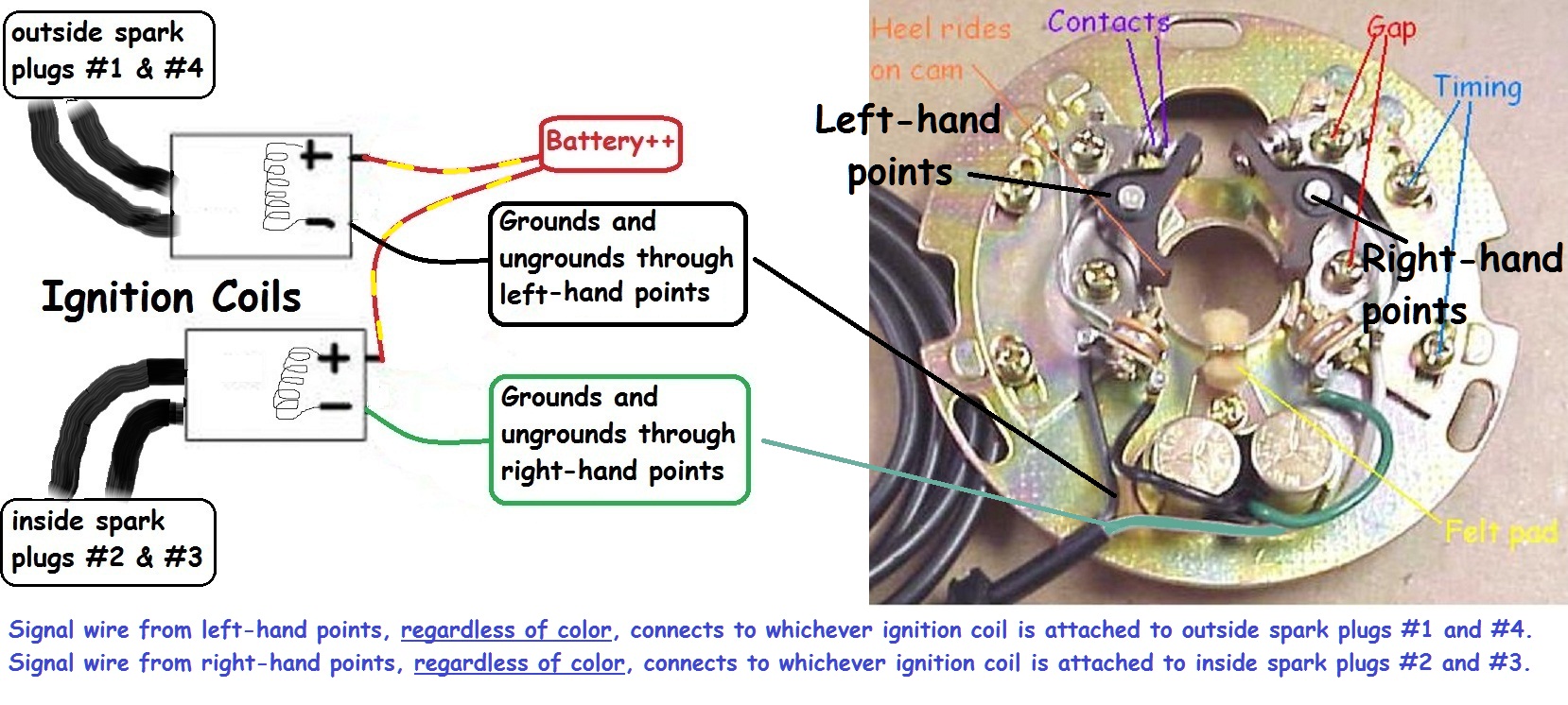

I've rebuilt the carbs and petcock with kits from z1, new pulgs,changed the oil, gapped the points and cleaned em with emery cloth, both are fine and firing with a good white/blue spark, plugs are wet so its getting fuel, after cranking for about thirty seconds wit the petcock on prime and the choke full she will fire once with a woof and puff smoke out of the airbox.

it may need to have the timing messed with some...are you getting the right point set opening for the right spark plug...do you have a manual...

I have that bike as well. Is it possible that the coils are wired up backwards? The right side coil fires 1 & 4. The left coil fires 2 & 3. The power wires are yellow/red with a green wire triggering the right coil (1&4) and a black wire triggering the left coil (2&3).
Good Luck

Yeah, I was gonna say... sounds like you have the coils wired in reverse, or the crank sensor pickups backwards, or the advance rotor 180 degrees out... you see where I'm going here :whistle:
Just move the plug wires and see what happens - swap 1 and 2 cylinder, then swap 3 and 4 cyliner, and try to fire her up again.
Also good to check the voltage the coils are getting, and make sure the air/fuel screws on the carbs are out to stock setting (1.5 turns approx), also check to see that you didnt drop a rag in the air intake :laugh:
Good luck.

Thanks Patton! I called the power connections the grounds. I fixed it.

kzcsi hit the nail on the head with the firing order coil/ lead swap.
as soon as i got that right she fired.
