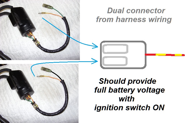

drfantastik wrote: Anyone have an idea why I might have blown a coil (1/4) for the second time? I have a '77 kz650C1 with dyna s and the coil mod. That all ran great for about 2 yrs then I blew a coil, replaced it, seemed to be good and now that im trying to get ready for the new season im getting no spark on 1 or 4 again. Im not positive its blown but im not sure what else could've gone out that would only affect one coil. Any help would be greatly appreciated.
Besides a mal-functioning ignition coil, there are several other possible causes for lack of spark on #1 and #4 plugs.
Would begin the diagnosis by using a volt-meter to confirm existence of full battery+ voltage at the dual connector (shown below) with the ignition switch ON.

Add this to the "dead Dyna" pile.drfantastik wrote: First thanks for the responses. So... I have ruled out the coil and I have good voltage to both coils. When I switched the wires on the coils I got the other coil to spark on 1 and 4. So im fairly sure that one side [1/4] of the dyna went bad. So unless someone thinks it may be something else, im going to have to replace it
