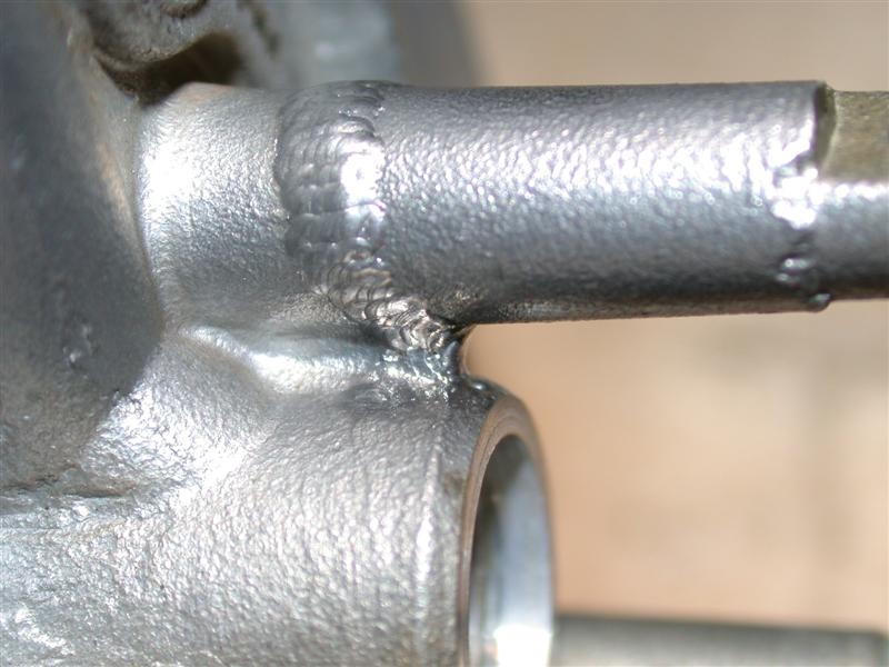

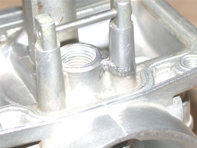

kzrider.com/forum/3-carburetor/535889-br...post-can-be-repaired
www.jmfmicroweld.com/MicroLaser.php

maybe jb weld is the only answer, aluminum is not easy to weld. another alternative would be a screw or small bolt with a helicoil.

It probably could be welded also but jb weld should be sufficent.

I bet a bit of molten melted aluminum dropped on there wouldn't have worked that well.
