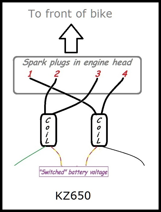

Where there's compression and fuel and spark, the spark may be occurring at the wrong time, which might be caused by incorrect routing of the plug wires from the coils.
Would first double-check to assure that plug wires from the left-side coil with the small green wire are connected to the inside plugs.
And that the plug wires from the right-side coil with the small black wire are connected to the outside plugs.

Thanks Patton. I'll check the wiring order by I'm fairly certain I have them right.
