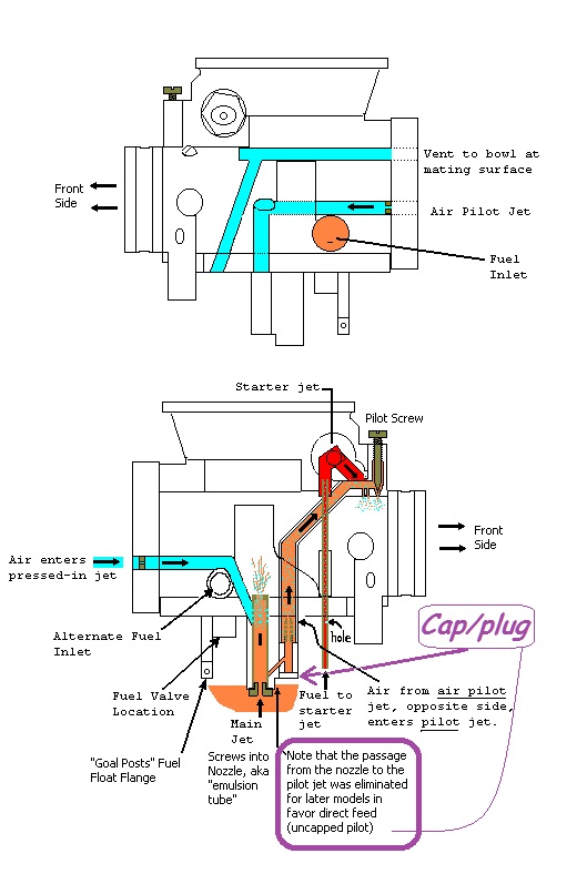

Does anyone know if the 82 GPz750 carbs would work on the '85? the set that a gent has for sale locally are from an '82 (KZ750R1) and I note some pilot-jet stuff that looks different (a plug) but the dimensions otherwise seem the same.
I opened the tubes to atmo last night and tried to get it started: no joy. It had worked briefly at first but I didn't have enough time on my second dedicated attempt to get it warm enough to idle so I could balance the carbs.
(vent)I am getting pretty tired of the process of taking these carbs off, and I have a sense that I'm going to F something up that will be costly to replace. Buying stuff that the PO had monkeyed with is a pain. (/vent) :sick:

Might be wrong, but thinking both '82 and '85 GPZ750 use BS34 carbs.
My understanding is the earlier BS34 has a plug under the pilot jet, and the later BS34 doesn't have the plug.
Could check parts info at kawasaki.com for differences in jet sizes.

so it looks like mechanically the 1982 GPz carbs would be the same, and should go right on.
Do I do that (Grab the local 82 set) and see if I have a truly cursed set as they are on the bike?
