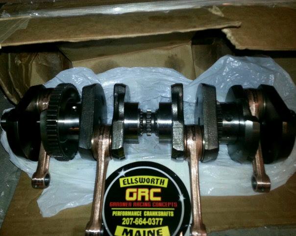

Only thing i see (besides the shiny) is that must be a J crank. ELR?
Yes, you 'could' do it on your own, kawasaki had special tooling to do it, have no idea if there's a crank manual for the big kz, there is one for the H1/H2, but once again they had special tooling. Not aware of who or where to get bearings, would have to measure and contact a supplier I'd assume, and make sure they're the correct series and grade.

Some guys on the XS650 site have done their own cranks. Good reading. I'm pretty much a maniac about doing everything myself but don't think I'd mess with a big KZ crank. Send it to a pro and get it welded when done.
