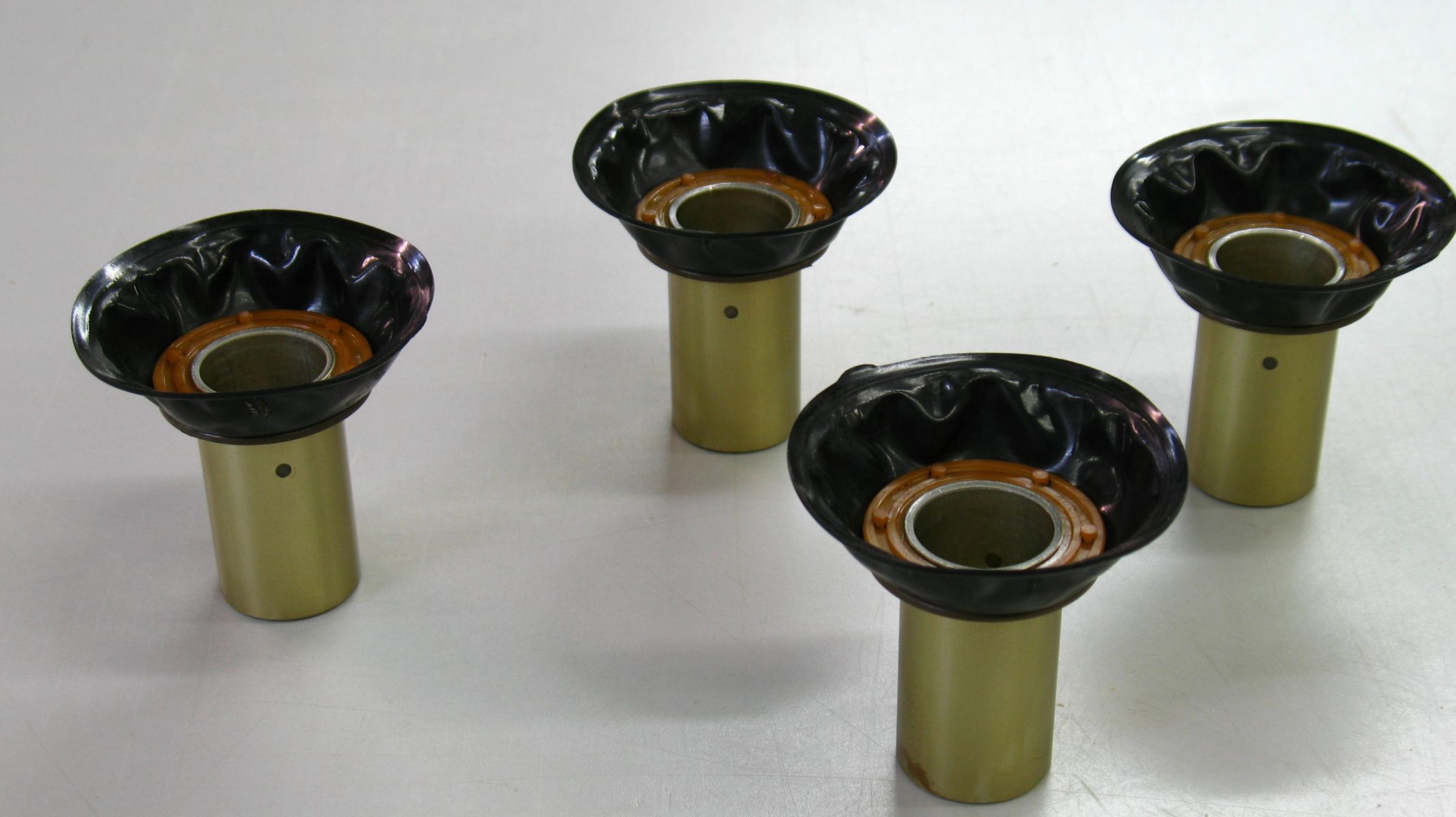

16 Feb 2015 06:54daveo wrote: I bought a set of KZ Police carburetors for parts, and found that each slide diaphragm had small a hole in the side of the metal cylinder. When checking into what that hole was for, some tech at Vance & Hines thought it was there meant to be a limiter of some sort.
If your slides have the hole, it could be what your problem is...if not entirely, it may be contributing to it.
I modified the set of slides by painstakingly filling each with JB Weld, after running a tiny tap through each one to rough-up the hole perimeter for adhesion (see photo).
Those slides are exactly the same as the original ones to my BS34's (with that exception), and are now sitting in a box, waiting to be used again. The rubber diaphragms are in excellent condition, and the hole plugs held up very well, for the season I used them.
Send a PM if you would like more info.
That is correct. Epoxy over each hole and no more rev limitations. Did it on mine.
