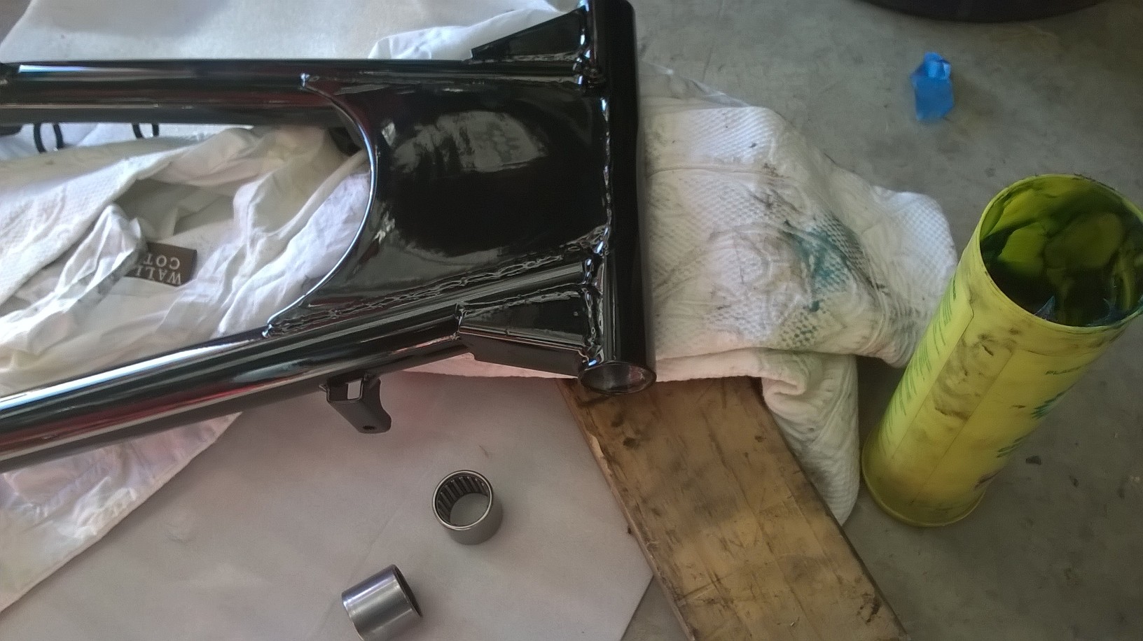

29 Jun 2015 15:27Replied by larriken on topic Kiwi KZP
27 Jun 2015 22:54
Got back to the bike again today and had a list of things to get done. Only got about half way through the list but made some progress at least. Sandblasted a whole a lot of bits that needed painting. Mostly just odds n sods. Put new bearings in the rear swingarm and fitted that up which was cool. Very satisfying getting stuff like this finished.
