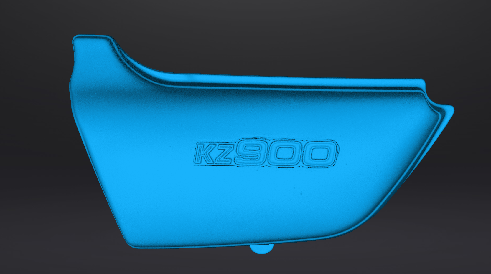

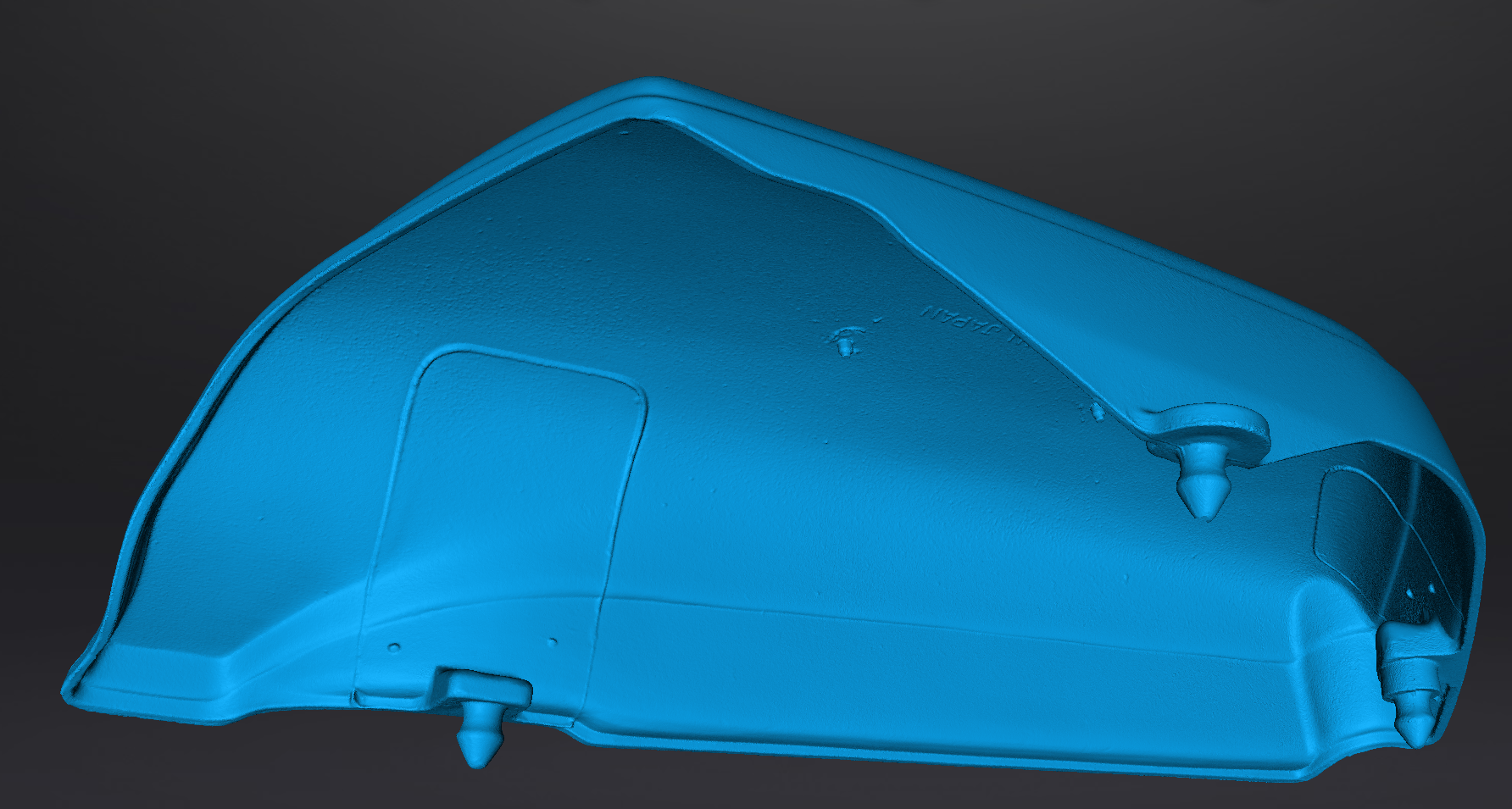

Hi Folks,
What are replacement side covers going for these days?
A coworker and I have embarked on a project to print replacement side covers using a large 3D printer we have. So far we've scanned a left side cover from a KZ 900. We're going to print this one this week. Check out these scans.
We will be able to remove the model tag digitally so the sample side cover is not damaged in any way.
Bill
Bill

That’s awesome. I’d be interested in that same left cover without the badge and “made in USA”

An original Z1 sidecover would have the "line" around the press-on buttons, just as your scanned KZ900 model does. This was re-inforcing put into them during manufacture. Repro ones don't have the line, which makes them easy to spot when a seller lies says it's an original. The side covers in the link provided by Texas don't have the line.
As for price....a few minutes on ebay will give you a good idea. Some have the reinforcing lines, which probably means they are made the same way you plan to make them.

18 Sep 2020 08:16hardrockminer wrote: An original Z1 sidecover would have the "line" around the press-on buttons, just as your scanned KZ900 model does. This was re-inforcing put into them during manufacture. Repro ones don't have the line, which makes them easy to spot when a seller lies says it's an original.
Think hardrockminer is referring to the triangular reinforcing rib molded behind each tab? They're present for stiffening the tabs, to help prevent the them from flexing where the tab meets the body of the cover.
