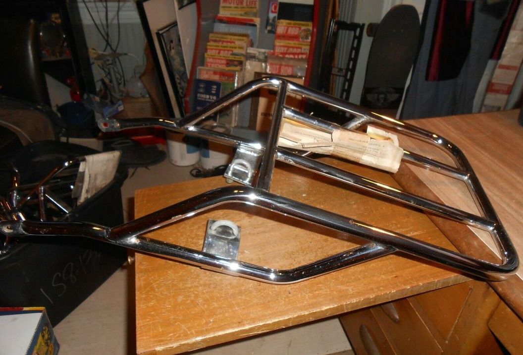

Hi everyone,
I can't seem to find if the luggage rack K53020-035 is for a 750 twin or four cylinders. Would anybody know ? Partzilla is of no help as it just states KZ750 ( www.partzilla.com/product/kawasaki/K53020-035 )
I attach a picture of the rack that I might buy if fitting for a 750 H LTD.

Below is a luggage rack for the 750H. I've seen a couple on EB over the years.
I don't know if another oem rack would've been made for the model but probably not.
KZ750H-Ltd luggage carrier. Kawasaki part #K53020-053.

Thank you Martin, I won’t be buying it then !
