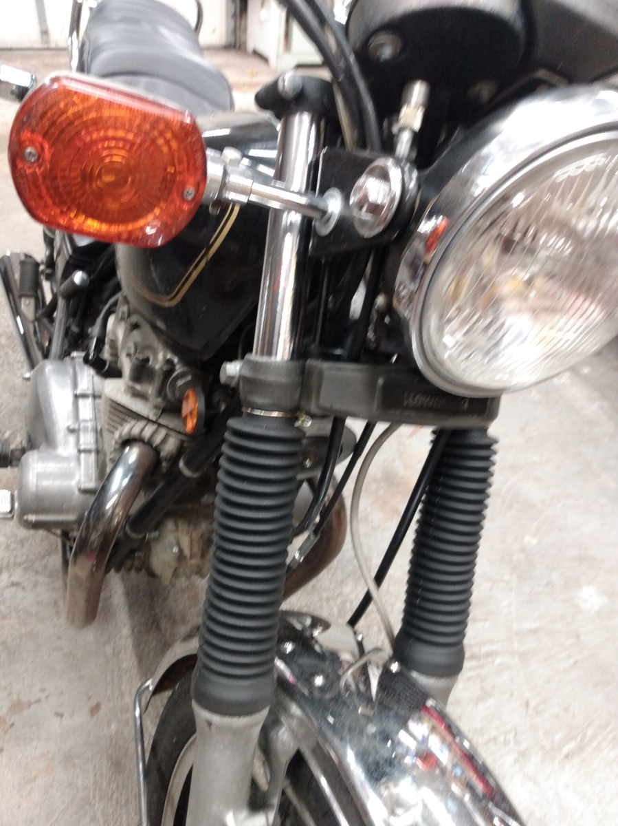

If you can't clean them, cover them. The upper sections of the tubs are covered with a $3 sample of chrome wrap.

Rub down the pitted parts with fine 1000 or 1200 etc paper wire wool or any other fine abrasive, buy silver coloured nail varnish & fill in pits & wait until dry rub down again & stand back & admire your work. Try on the non swept area first so you are happy with cosmetic side of things then do the lower part. Take your time you will be surprised at the results & as the varnish is quite hard lasts a long time. I have done this as a temporary repair many times & puts less stress on the seals due to no sharp edges.
Also to help you could apply some light silicone grease or rubber grease to lube the seals. Adding gaitors will also help stop corrosion in the future.
