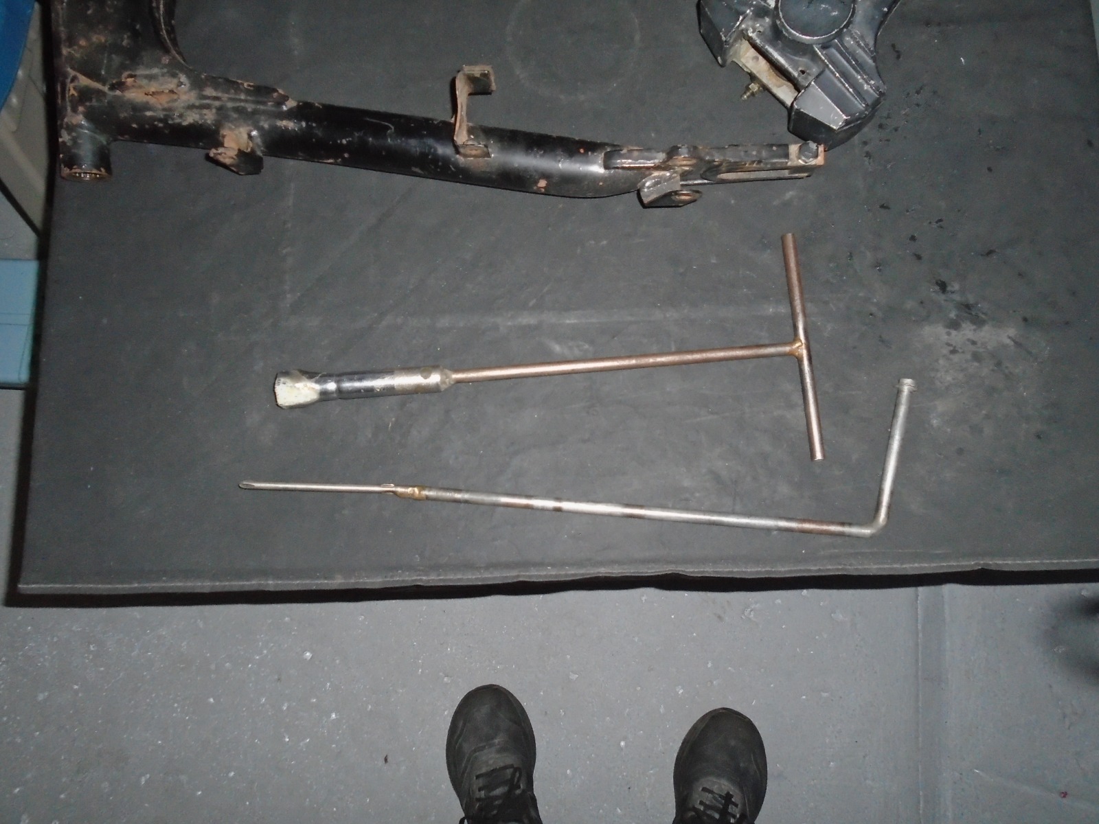

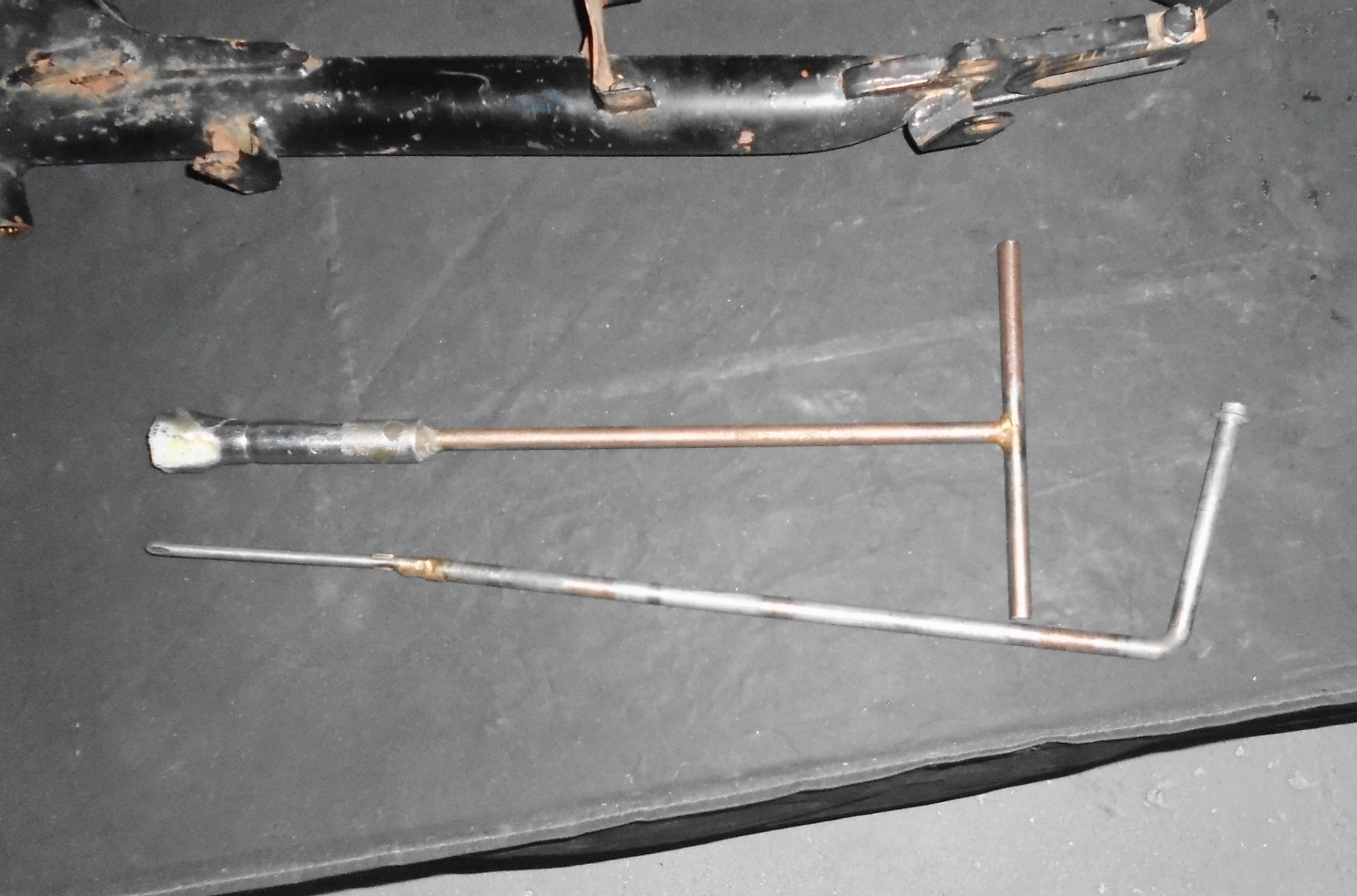

I had camera out taking pictures. I just sold 5 factory tools from a tool kit.
But, I can truthfully say, that I did this to these tools in the late 1980's!!
And I have always used them on the Kaws! That is a tool kit JIS bit, brazed on to a handle. I use this for carburetor clamps always!
Then I put this handle in to a plug socket, brazed up a T handle, stuffed with body filler.
I used these 2 for over 40 years!

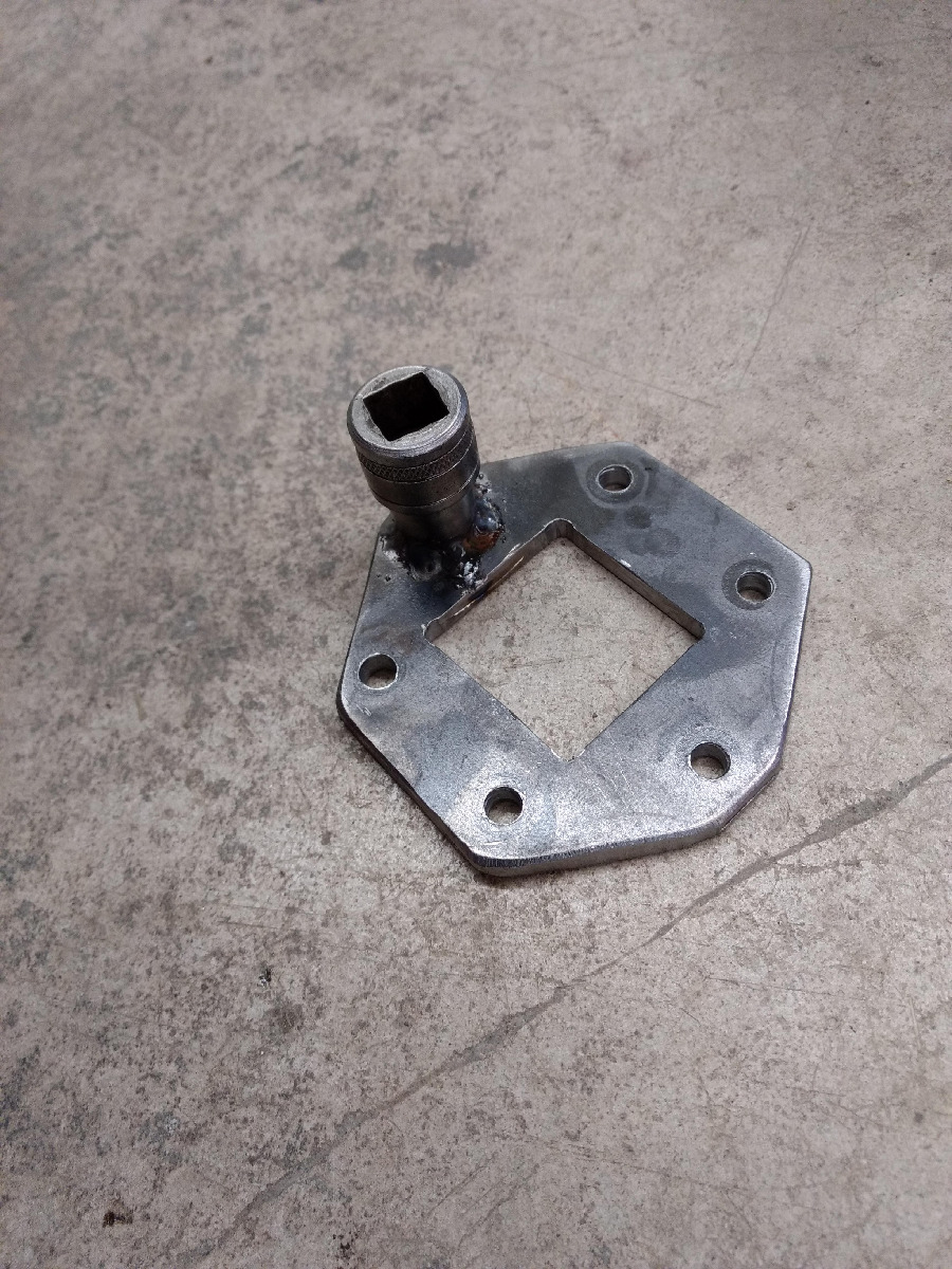

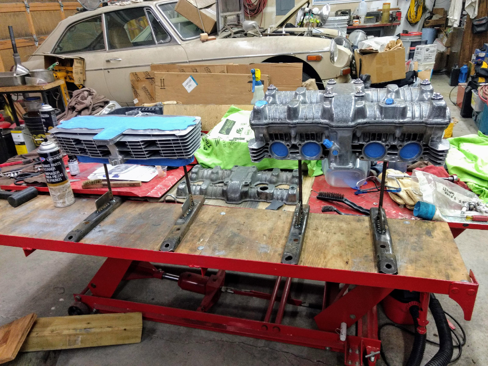

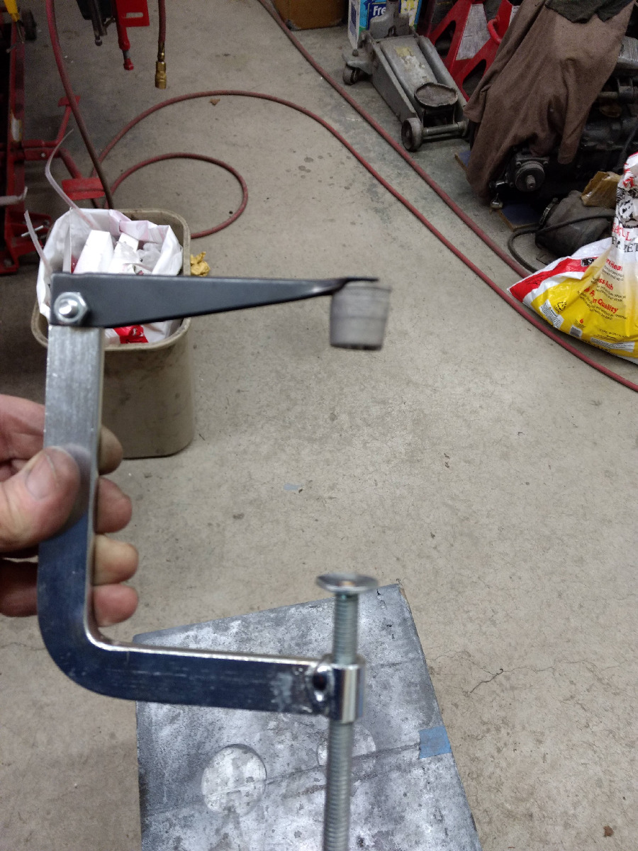

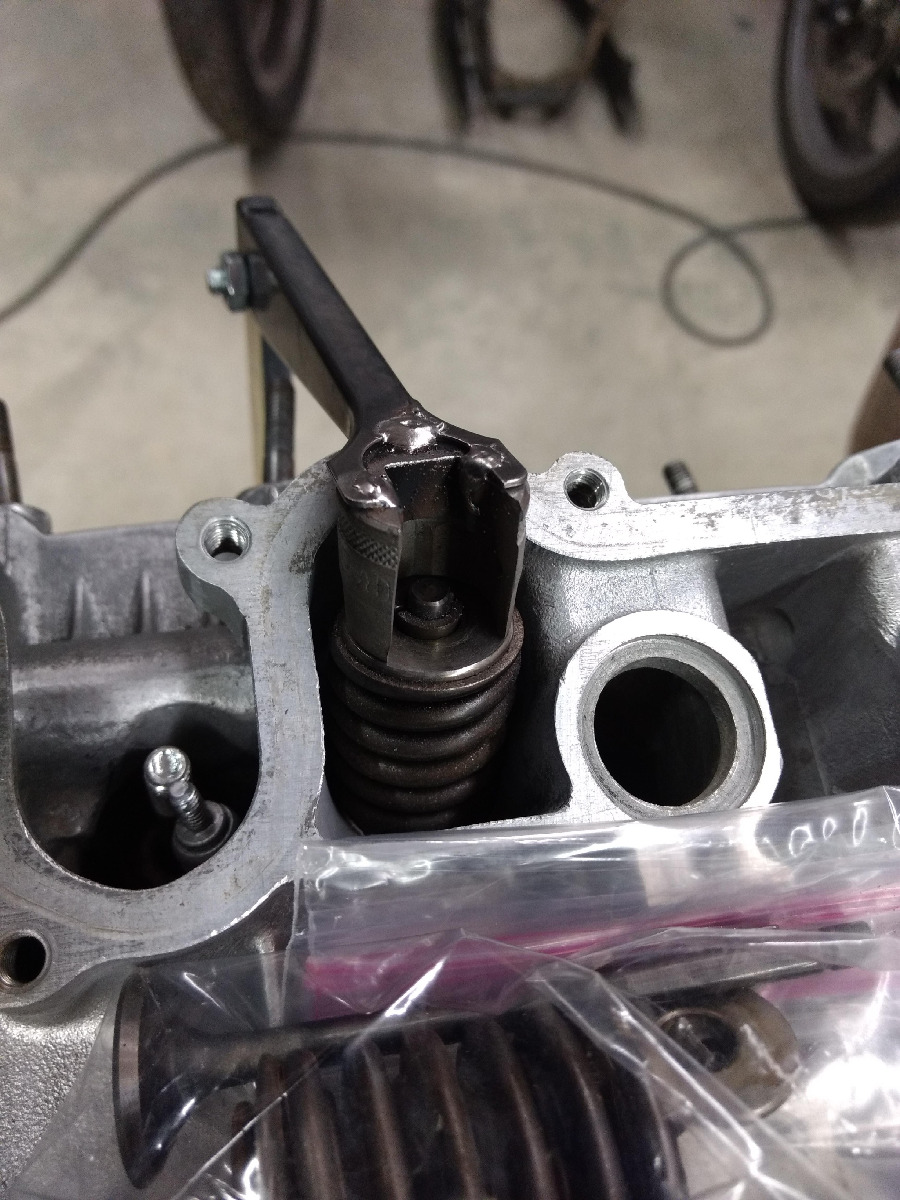

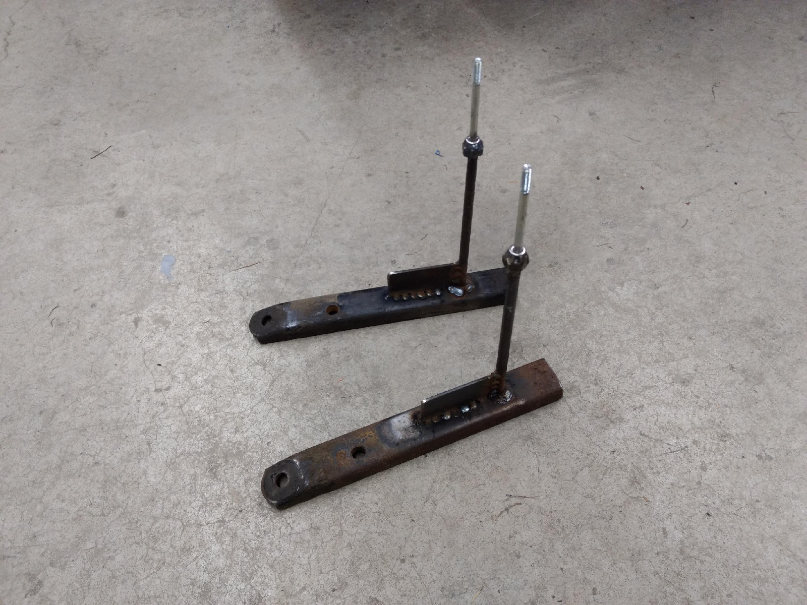

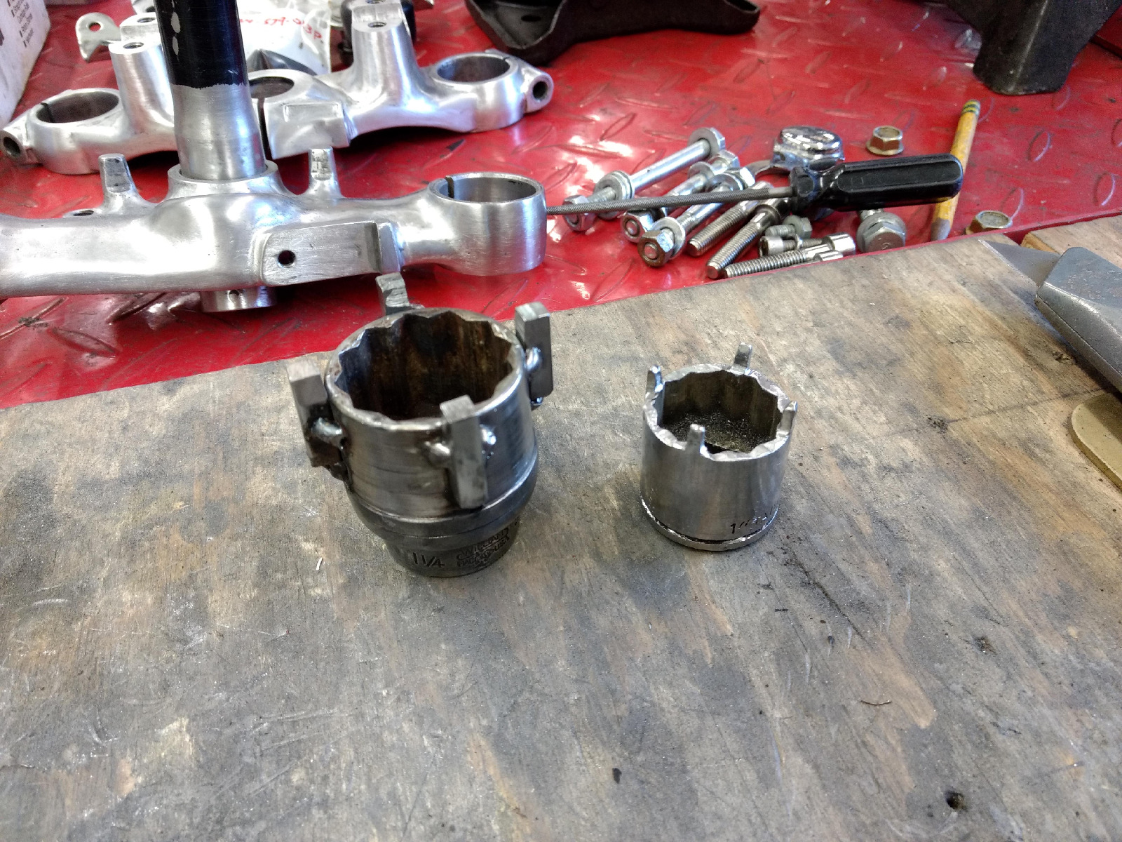

I've made a few tools for the bikes over the past few years. From steering stem sockets, clutch holder tools to fork piston tools. I even made cylinder head stands from worn out MGB front lower control arms and converted a Briggs and Stratton valve spring tool to work on the 74' Honda CB 550 head.
