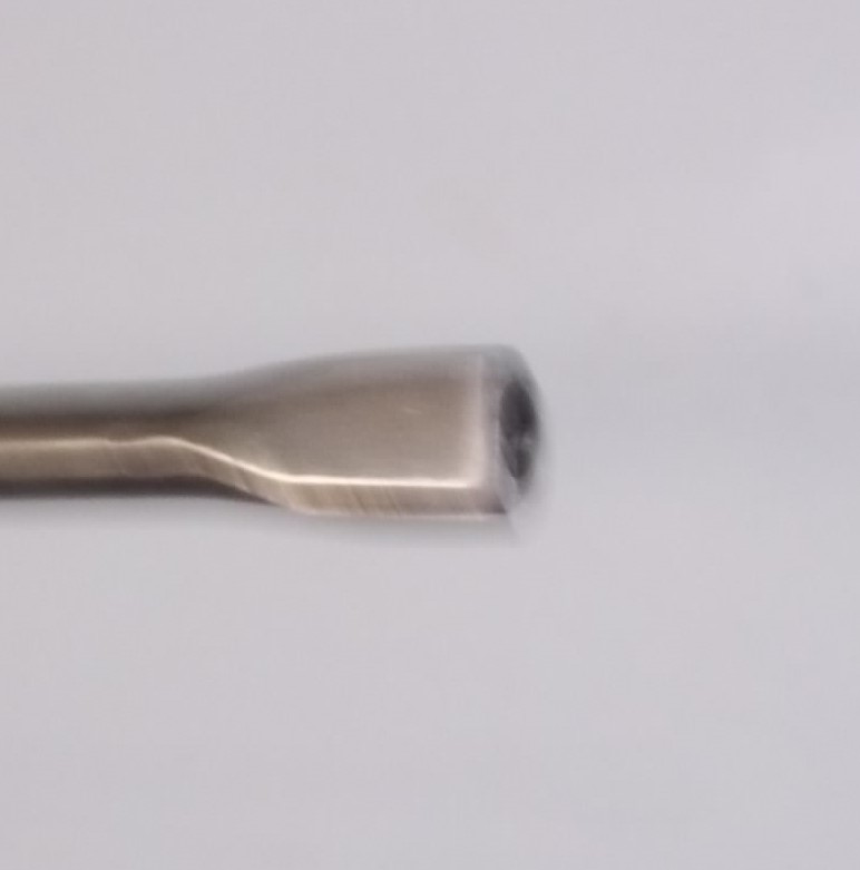

Hi Martin, I have used this piece of stainless steel rod that was a part off of large printing press.
This was scrap from work in 1978! All I did was grind a flat spot on one side. This fits the Z1 & KZ styles with that D shape.
All I do is slide that down in and it sits nice and flat with the flat side of the dampner. Works great been using it since 1978.
I know your models and newer than mid 70's have diofferent.
But this is all I ever needed. And of course air impacts always help break loose.
Crappy picture with cheap phone.
