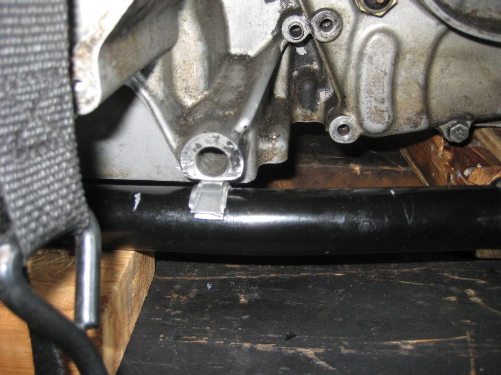

Here is the stripped down cases used for my frame change mock ups.
I removed the 3 front motor mount tabs and the rear tab closest to the sprocket.
I was then able to set the cases, barrel, and head loosely in place to check for fit.
In order to remove the valve cover I need to gain about 1/8" of clearance so I decided to shave a bit from the top of the cam cover "bump" (removed .050" on my mill) so I can slide it out past the coil mounts without getting snagged.
I also ground down the bottom center motor mount lugs so the motor will hang lower in the frame.
The shims are for clearance so I can locate the engine mount bolt locations.
I had to make new weld tabs and bolt on motor mount plates.
I will update and add more detail and pictures when I get a chance. This is all after the fact, the build is ongoing (frame is finished) but the engine is not rebuilt yet.

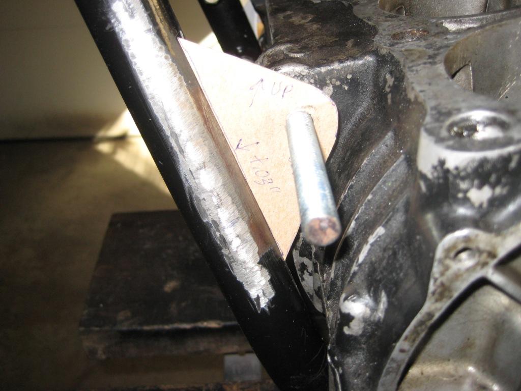

Back to the frame mods...
There is no bottom front engine mount bolt on the early Z1 motor so you need to weld in a front lower cross tube to gain back some rigidity. The KZ650 frame is pretty rigid stock, if you look at a GPZ750 Turbo frame it is very similar (maybe the tubing has a bigger wall?) The Turbo made about 110HP stock so I am not too worried about any flexing.
You can see how the oil pan will sit low in the frame.
I also checked the chain line, I swapped the sprocket to 530 so it would match the 650 rear sprocket. No issues with chain line.
I made sure the sprocket cover and the shifter shaft cleared the frame
Ground down both center lower motor mount lugs as they are not going to be used, but I did not cut them off.
This is how close the lugs need to be.
I think in the end I used 2 of those .040" aluminum shims on both sides so I have .080" to the frame at those spots with the motor mount bolts tightened.
Here are the motor mount and weld plates (not finished here) The thick lug is for the lower rear and there is a 1/8" plate to convert the B drum brake frame to a C disk brake frame.
For the upper rear bolt on mount plates I increased the thickness to 3/8" 1018 steel.
1/4" thick weld plate.
3/16" thick bolt on plate.
3/16" thick weld tab.

This is how I figured out the size/shape of the engine mount plates.
Thin cardboard templates were bolts on.
The rear upper motor mounts points at the frame were not changed but the motor mount bolt position was lowered about 1/4" from the stock location. I was told by a frame builder that these rear upper mounts are the most important mounts for a Z1 engine.
Upper rear 6106 motor spacers.
This is the lower rear engine mount situation.
A solid 1018 spacer block was drilled/tapped in both directions to support the clutch side of the cases. A frame bolt goes in from the outside of the frame and the motor mount bolt goes in from the sprocket side thru the weld tab.
Here you can see I recreated a new switch mount tab for the rear brake lever to go on the new thicker rear upper engine mount plate.
The switch is held in the stock location by a small pin which was later welded and ground, the switch clears the Z1 upper case.
I decided I needed a gusset on the weld tab closest to the output sprocket to counter any twisting when power is applied suddenly.
