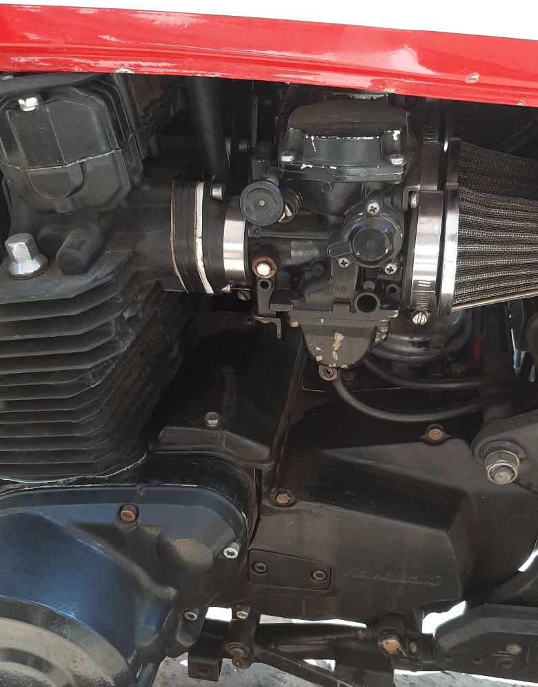

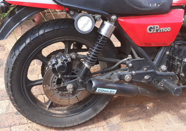

Just before Christmas I laid eyes on a 1981 GPz1100 B1 in fairly beat up condition, but mostly all there and the price was ok, I guess, since these are pretty rare here.
PO had removed the stock turn signals, the EFI and air-box (with inevitable butchering of the wiring! He mounted a set of Mikuni BS34's with some "cheap" pod filters, and some horrible "spacers" between the carb. boots and cylinder-head, presumably to create "space" for the oil pipes that pass between the head and carbs.
Your guess is as good ad mine.
The exhaust "slip-on" is junk too, and EXTREMELY LOUD, although the headers are "sort of" ok.
Going to attempt to "roll my own" (pun intended) period Kerker megaphone... (I have a bit of experience rolling expansion chamber cones)
The cylinder-head and barrel have been replaced with those from a 1982 GPz1100 B2, which have no fuel injector mounting holes in the inlet port casting, so there's that!
The B2 cams that were in that B2 head were also transplanted.
Fortunately, I was able to talk the the shop owner that performed the transplant surgery. Nice enough chap, but I can't surmise anything as to the workmanship, except to say that there are no oil leaks, and the motor "sounds" ok, having "stethoscoped" the top end using the "long screw-driver-in- the-ear" method.
He assured me that the valves were lapped and clearances were set mid-spec, but, alarmingly, the valve stem seals were not replaced, which is a bit of a worry.
Jetting is off some... the engine exibiting some "hesitation" at low throttle opening, and definately rich at WOT.
