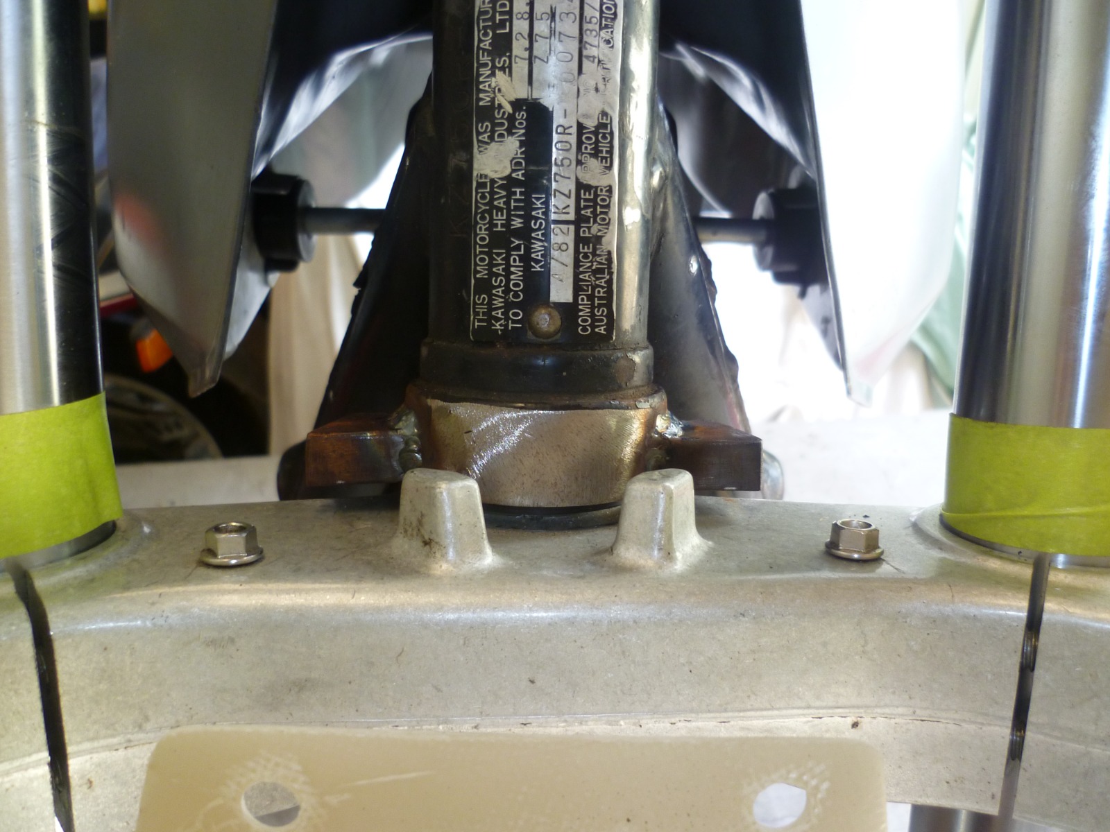

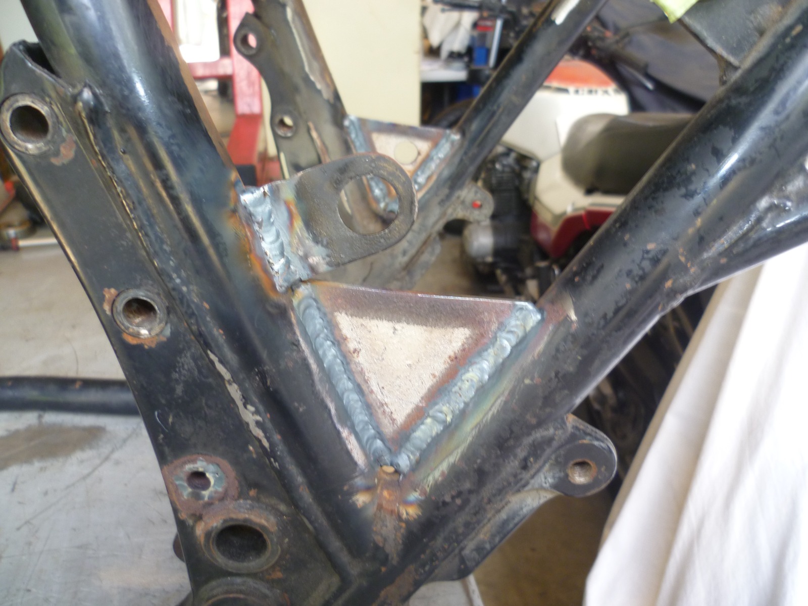

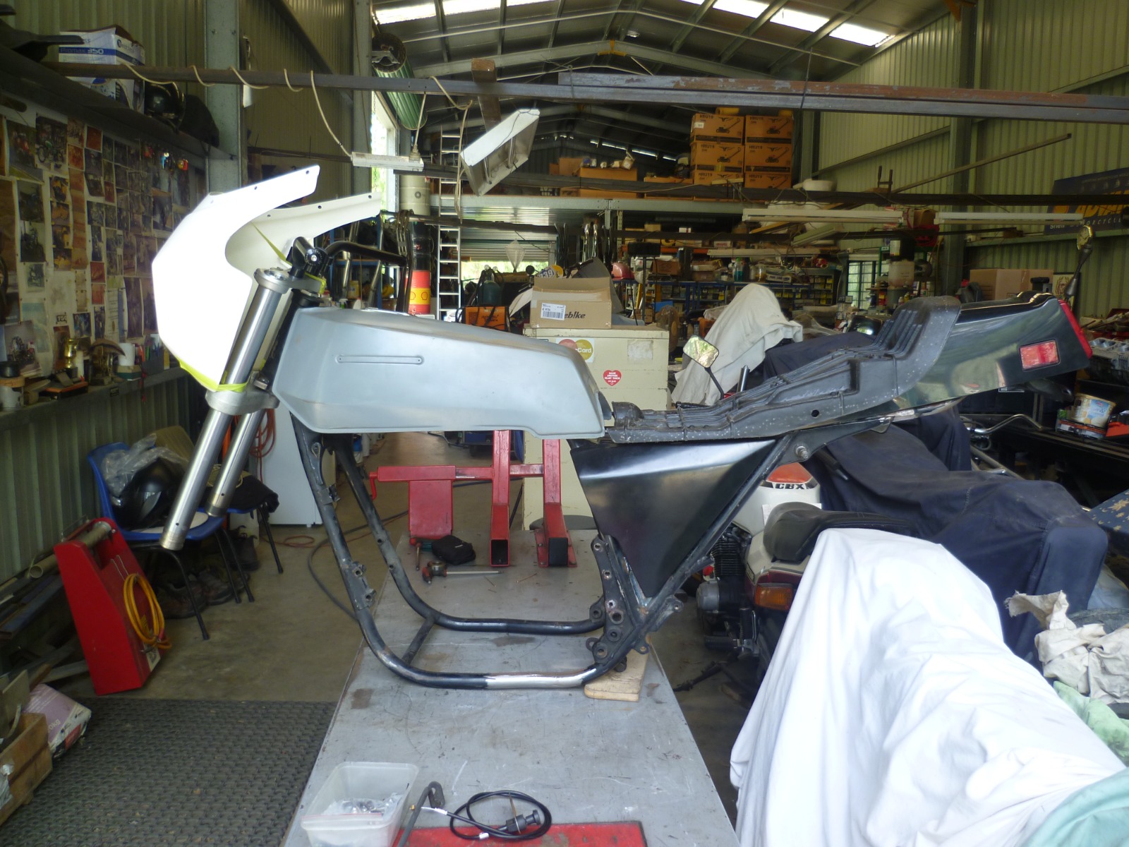

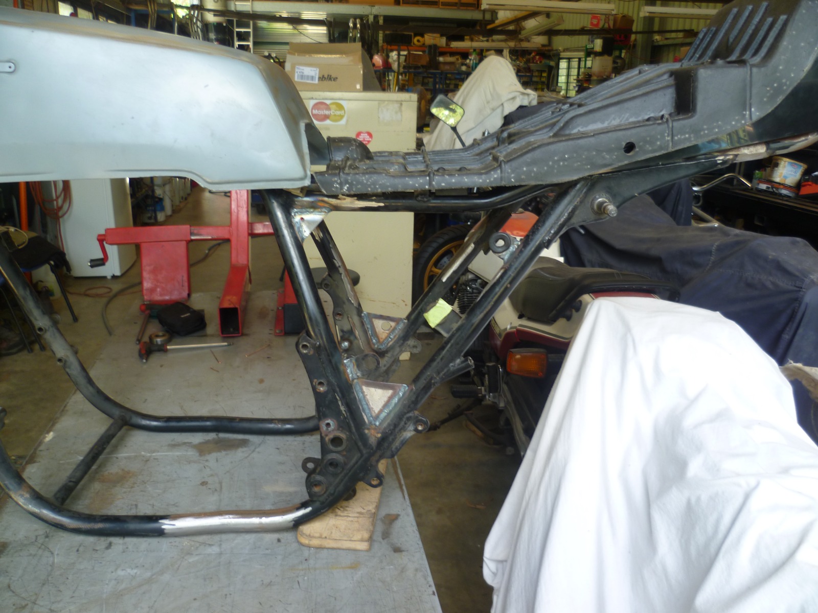

Well I have a slight change of plans for the time being, I'm struggling to find a cap for the large Z1R tank, so rather than modify it to fit a different cap, and making it worthless, I've procured a small tank with cap. I have 2 sets of bodywork now, so until I work out what I'm doing with the cap situation, I'll be painting the first set, with the small tank,  black. I've also added a couple of braces and finally welded the mounts for the side covers. I ended up having to cut off some of the locating tabs off the side covers and use threaded inserts just to be able to use the Z1R side covers. I also found out that the rear wheel bearings are the same size as lower steering head bearing outer race, So I tapped it into place to avoid any distortion to the bearing area while the new steering lock tabs were welded in. None of the welds are perfect , but they'll do, this is a relatively budget build after all....!
The new look for the time being.
Mounts
Steering stops

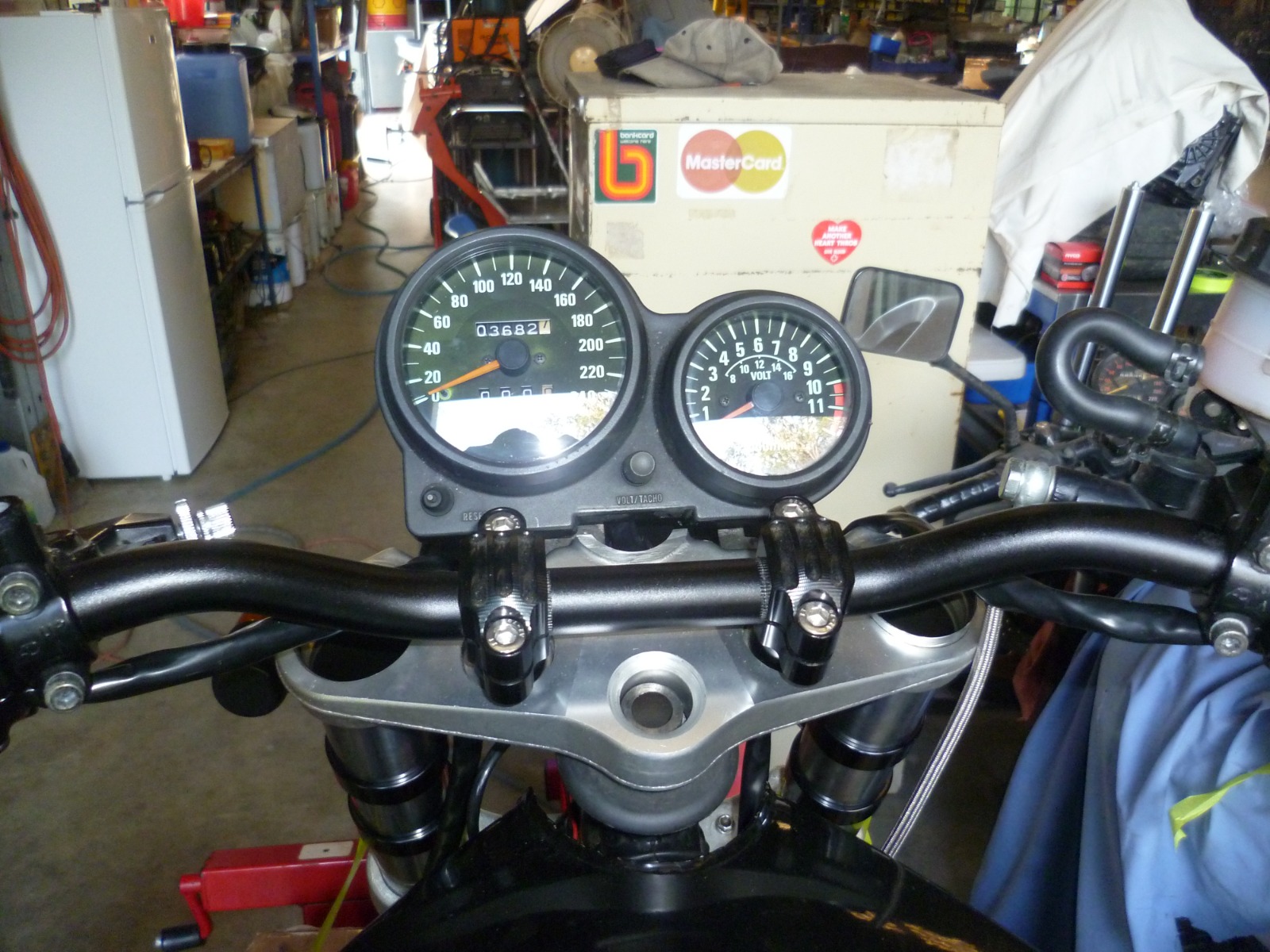

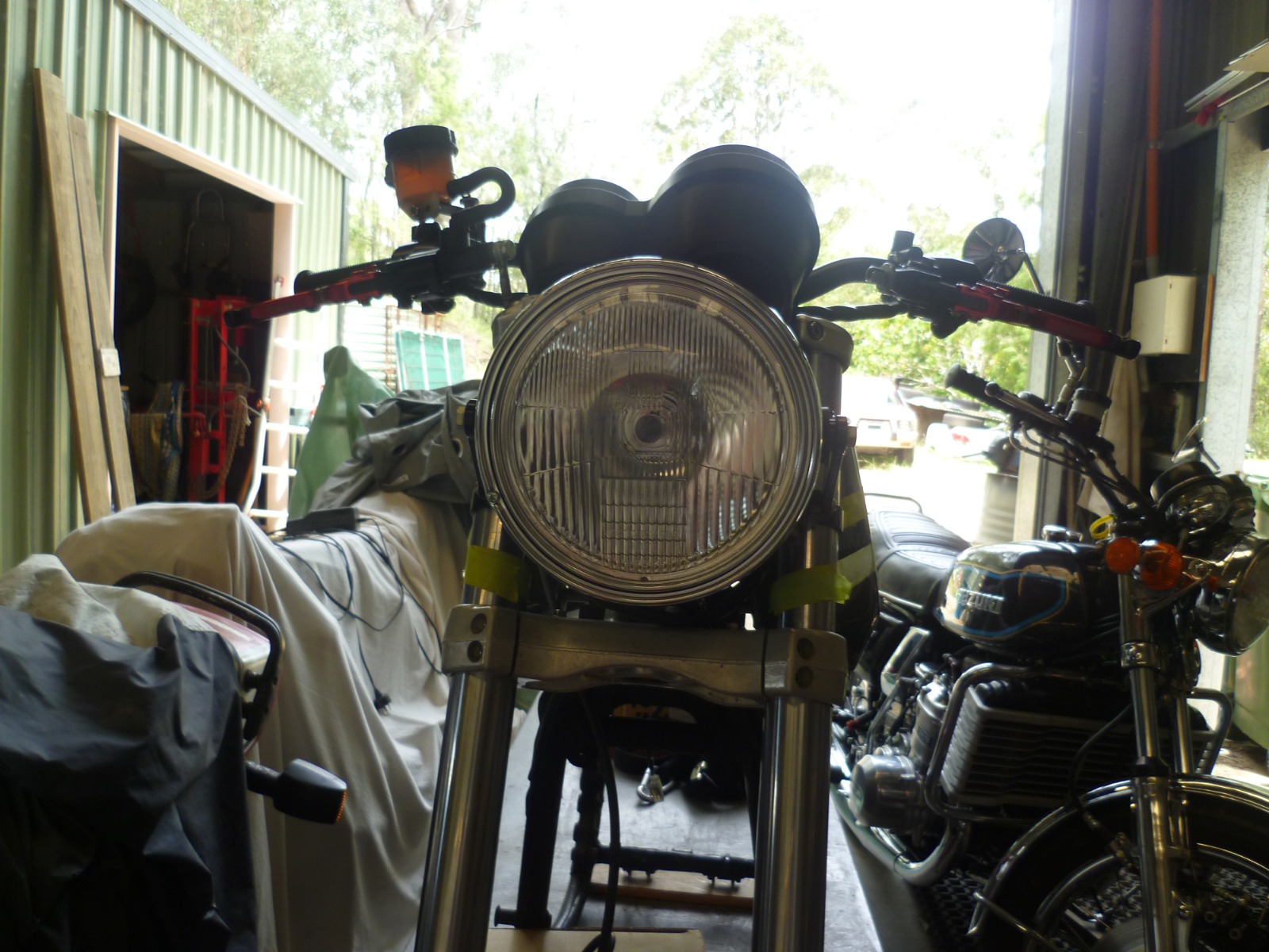

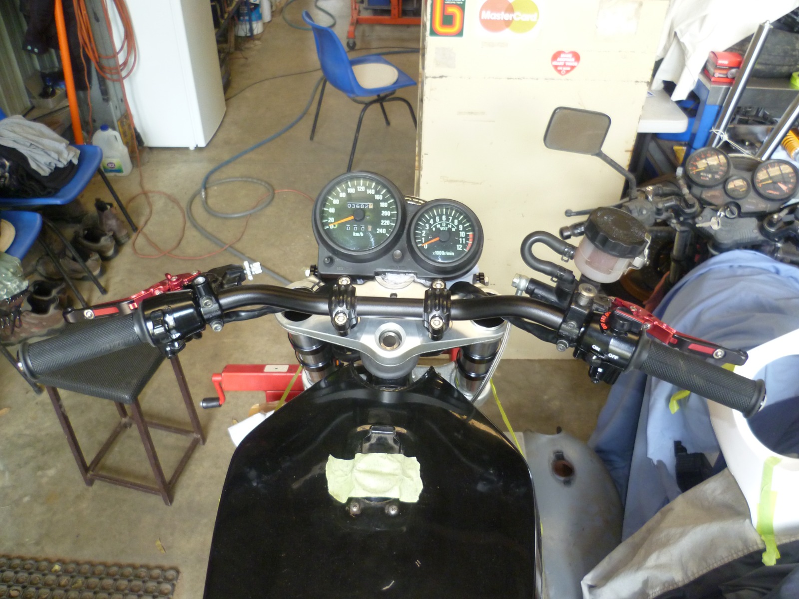

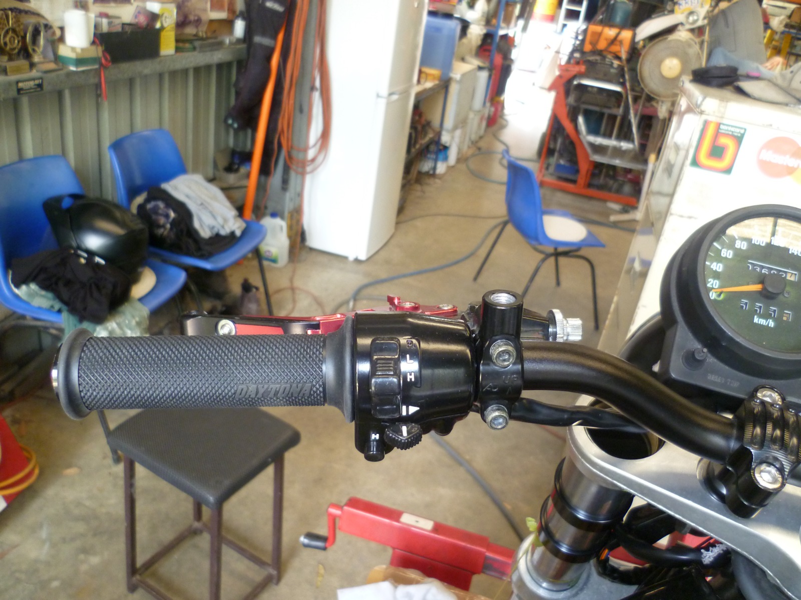

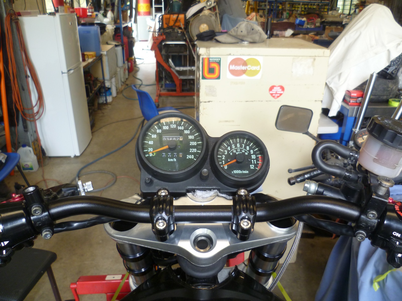

Well I finally got a chance to do a bit on my bike. Started out mocking up the wheel house. I fitted the headlight properly, stuck some rags under the gauges just to see where I wanted them to sit, The triple clamps I'm using had 2 threaded holes that lined up with the GPZ gauge mounts, so I trimmed the mounts to suit, drilled a couple of holes and they mounted straight up, I really think they suit the look of the bike. What do you think ?  I'm also using early Z900 controls, they are small and neat...

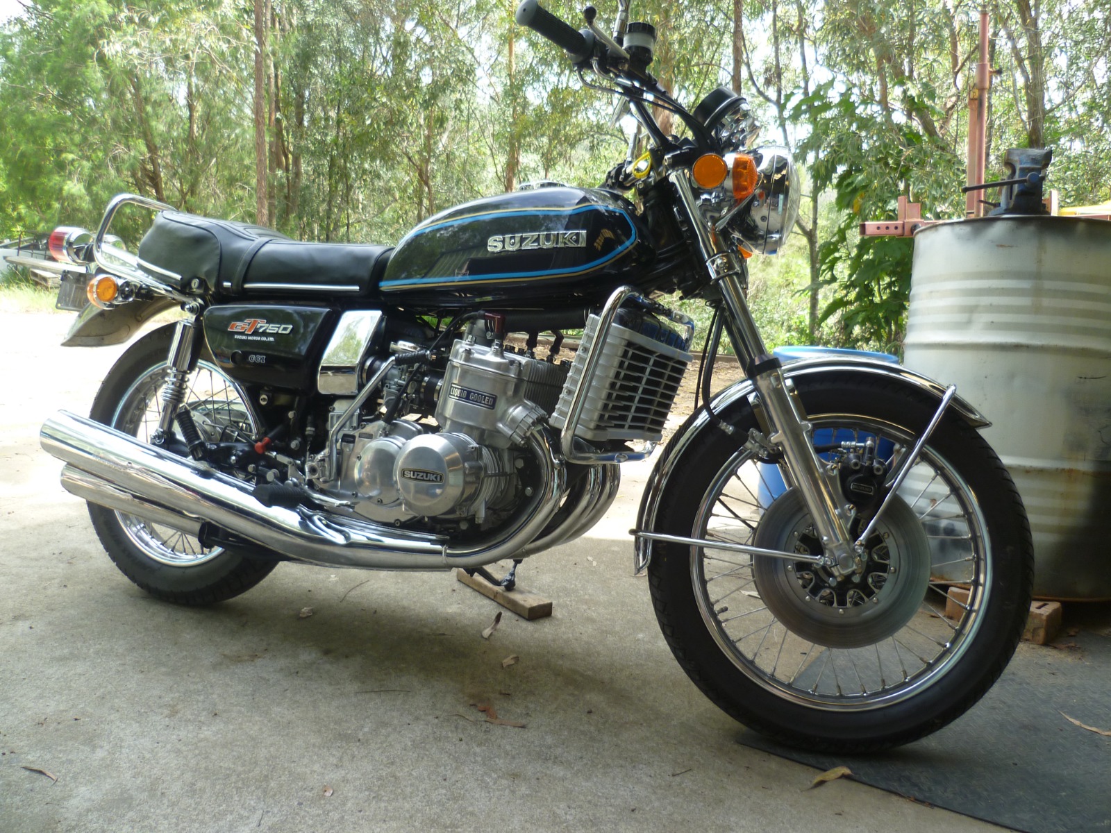

Also a couple of pics of a nice GT750 that was keeping me company.
The pics are out of order but you'll work it out.  I've still got a few small modifications to do to the top triple to finish it off.
Getting there slowly..!
Last edit: by 750 R1.

Later clocks look well on it
Yeah, I really like them...

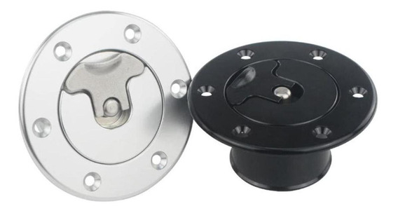

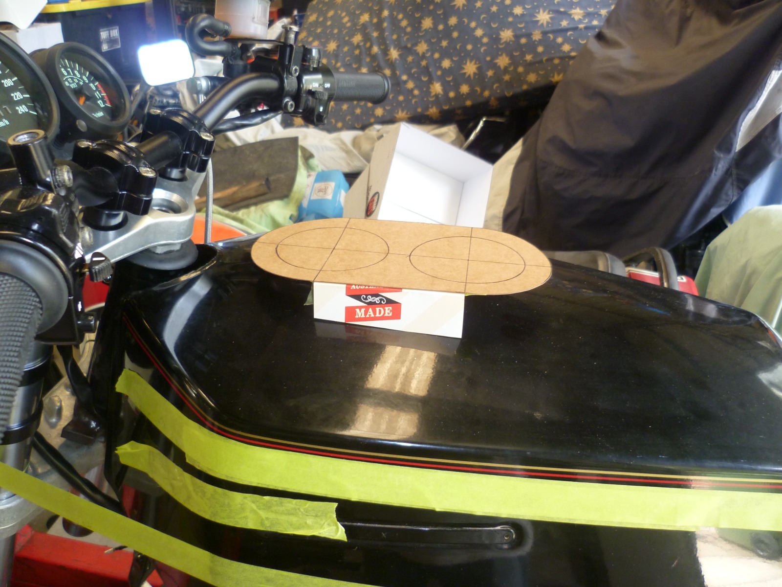

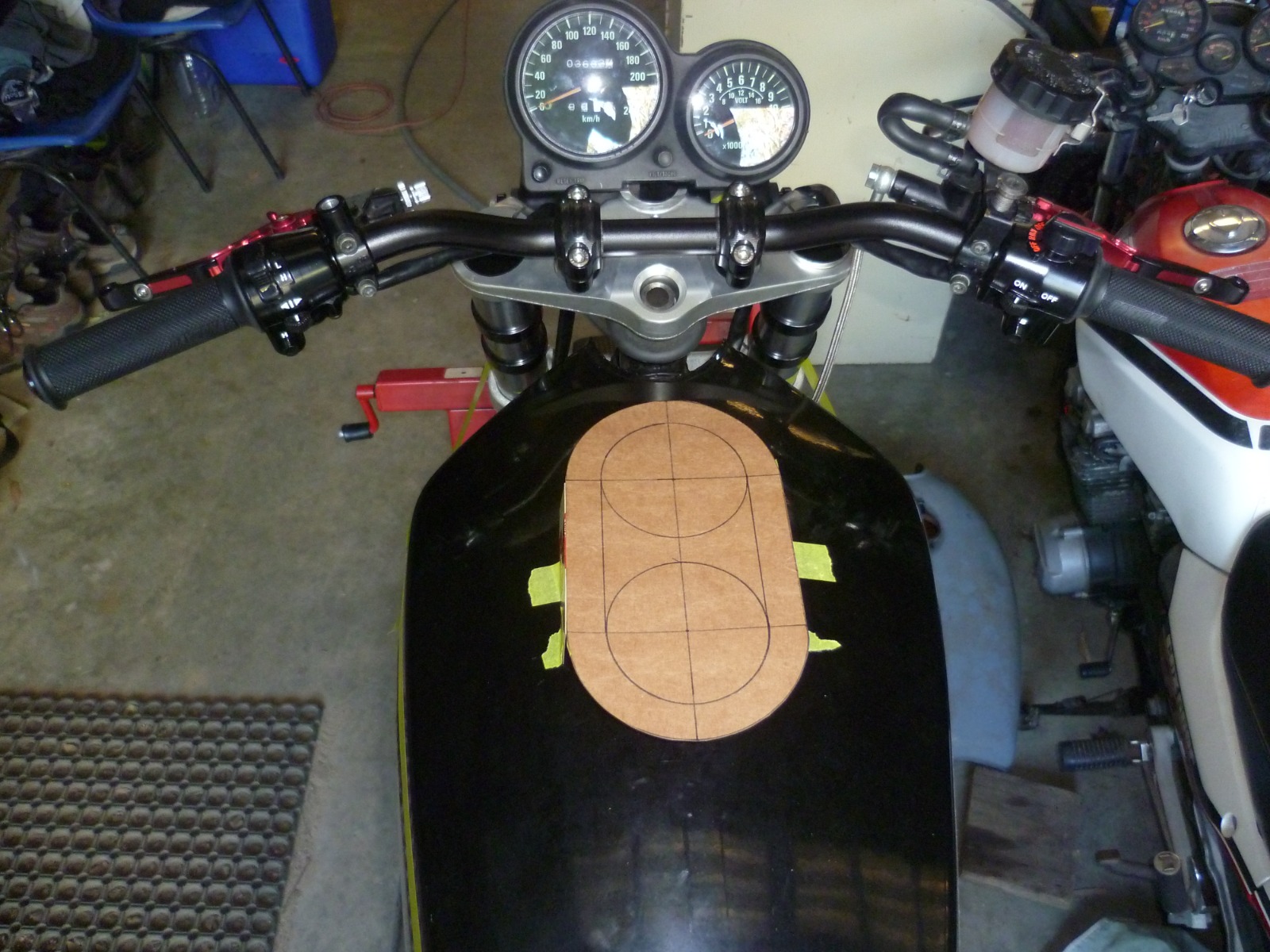

Finally managed to get back to the bike, i've given up on the stock fuel cap, I've wasted far too much time searching the corners of the internet for one, I've decided to go with a dump filler/dry brake looking set up. I did a bit of a mock up with a cardboard template yesterday . I loathe to cut a hole in the tank but since i'll be keeping this bike I'm getting more comfortable with the idea. I'll use two 80mm aircraft style filler caps like the one in the pic below...

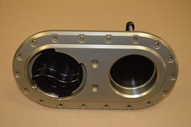

Hey Mick, I have the same quick fill I bought years ago with the same problem of finding a cap for the same tank, eventually I was able to locate a cap but since then they have skyrocketed in price as you know. I had the same idea of putting the quick fill and bought the same one , I must say its the perfect shape tank for a quick fill and had i not found one I would have done the same . I still have my quick fill and will be using eventually or selling .
Hi Rich, did you buy it from Chris at motogpwerks ?  If so, could you give me the dimensions of the main alloy top piece as that would be all I need. I know a guy that has computer cnc machines and I'm thinking of making my own, well, having him make the  top for me, I want to fit the caps I pictured above it, all i know is that its 220mm long and 120mm wide, I need to know all the other obvious dimensions but don't want to bother Chris for them.... Also, would you know what grade of alloy its made from ? 6061 maybe...
Thanks mate...

Yes i bought it from Chris many years ago . I will get to it tomorrow and send you pics and dimensions . It is very well made Dry Break ,as every thing he makes is . Cheers
