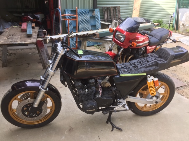

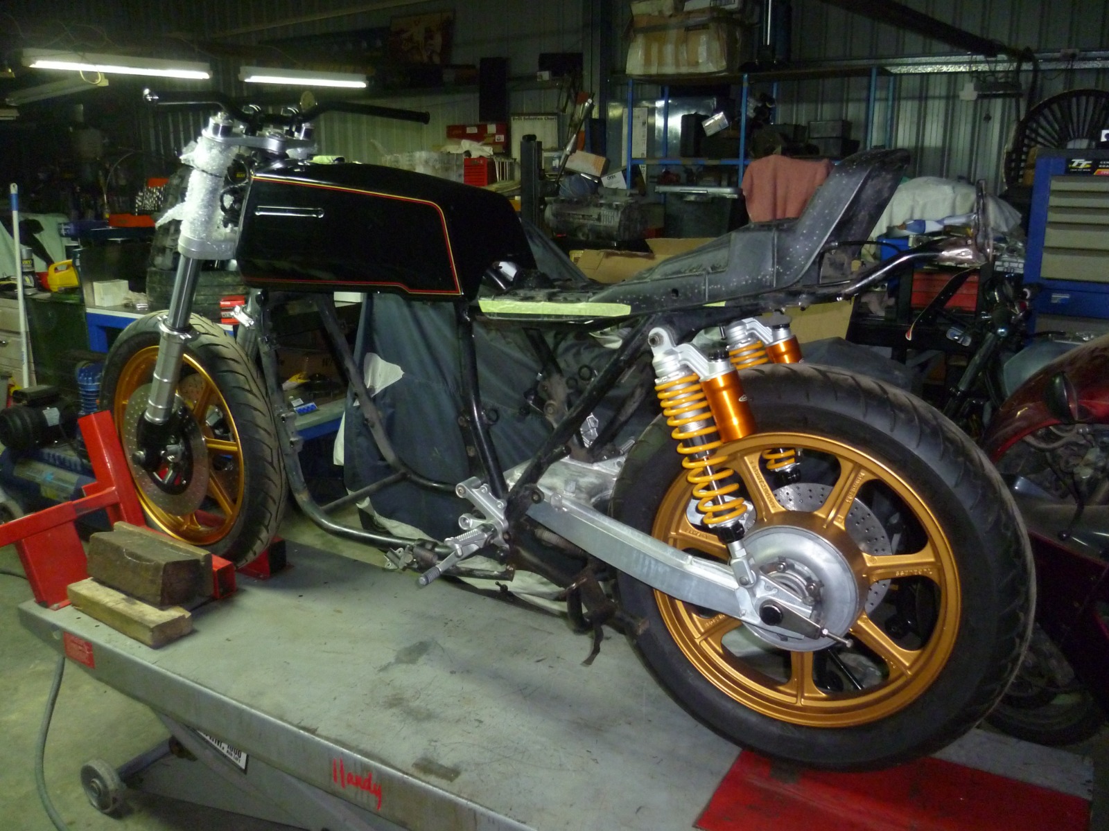

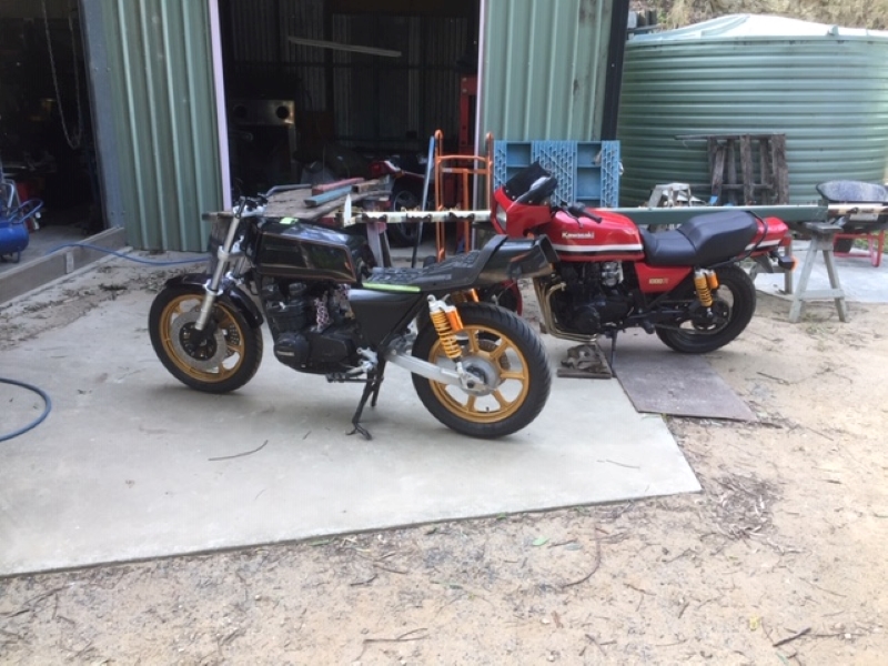

A couple of pics of where i'm at... Progress is slow ...
Rear shocks are on just to see how they looked on the bike, I'll be moving the top shock mounts further forward.. Tape on the seat base is where I have to trim the seat to fit the body work, the area under the tape will be removed.

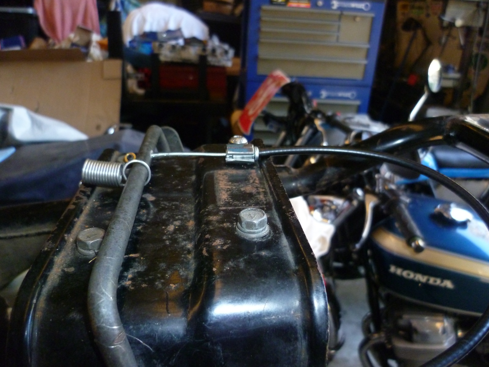

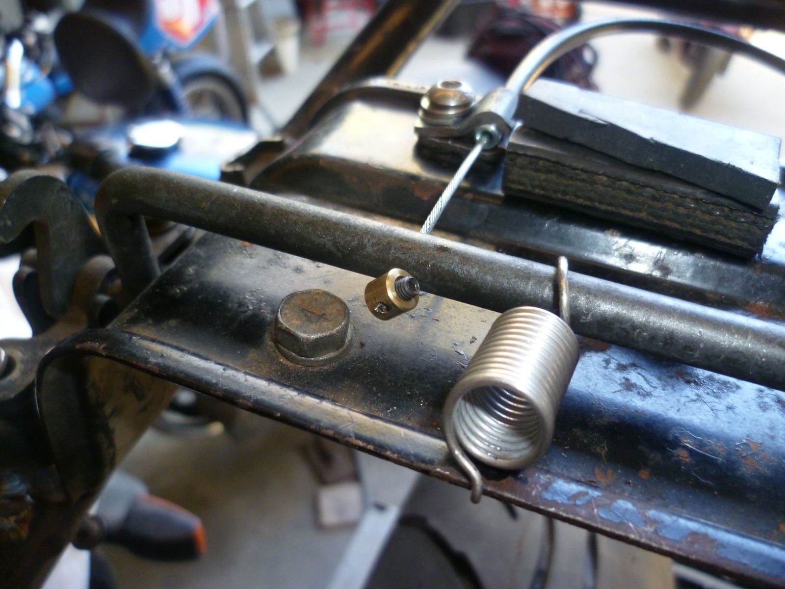

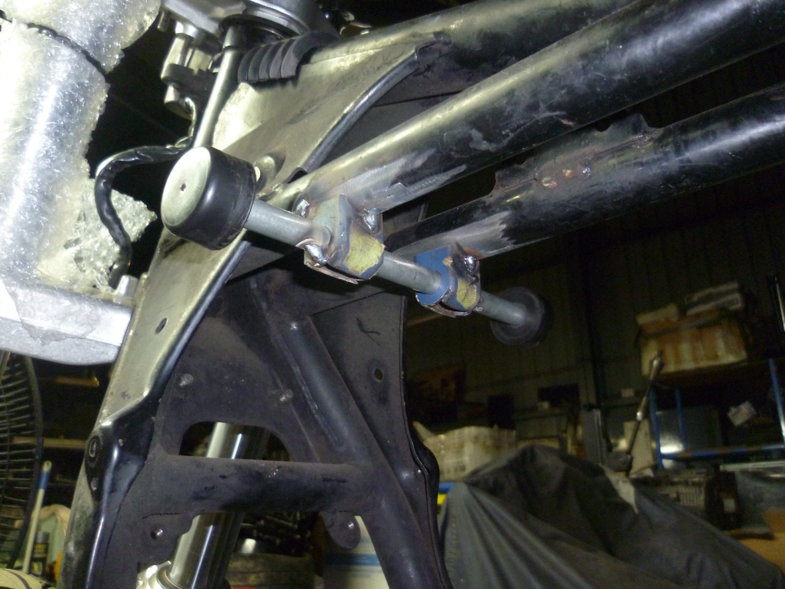

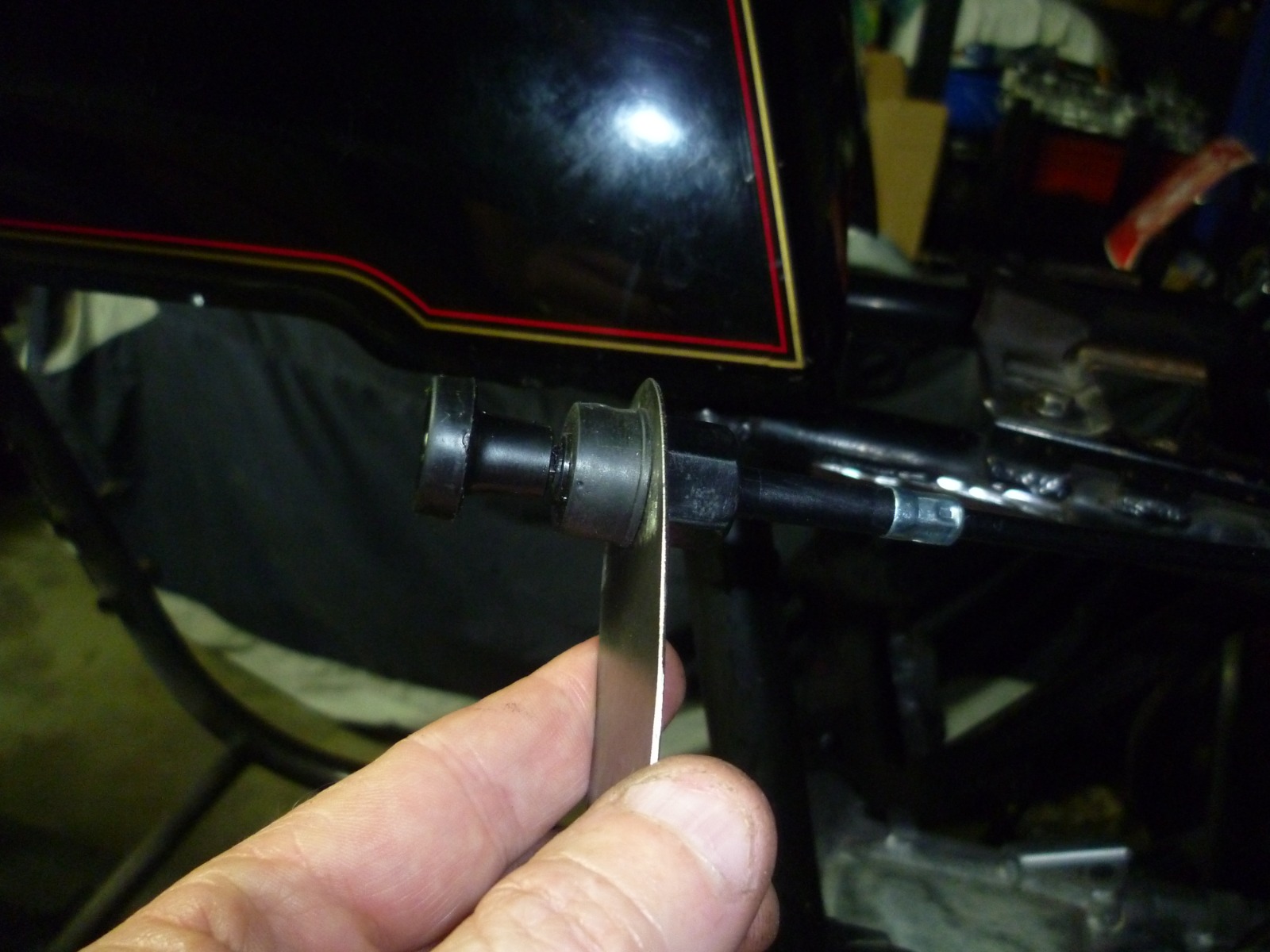

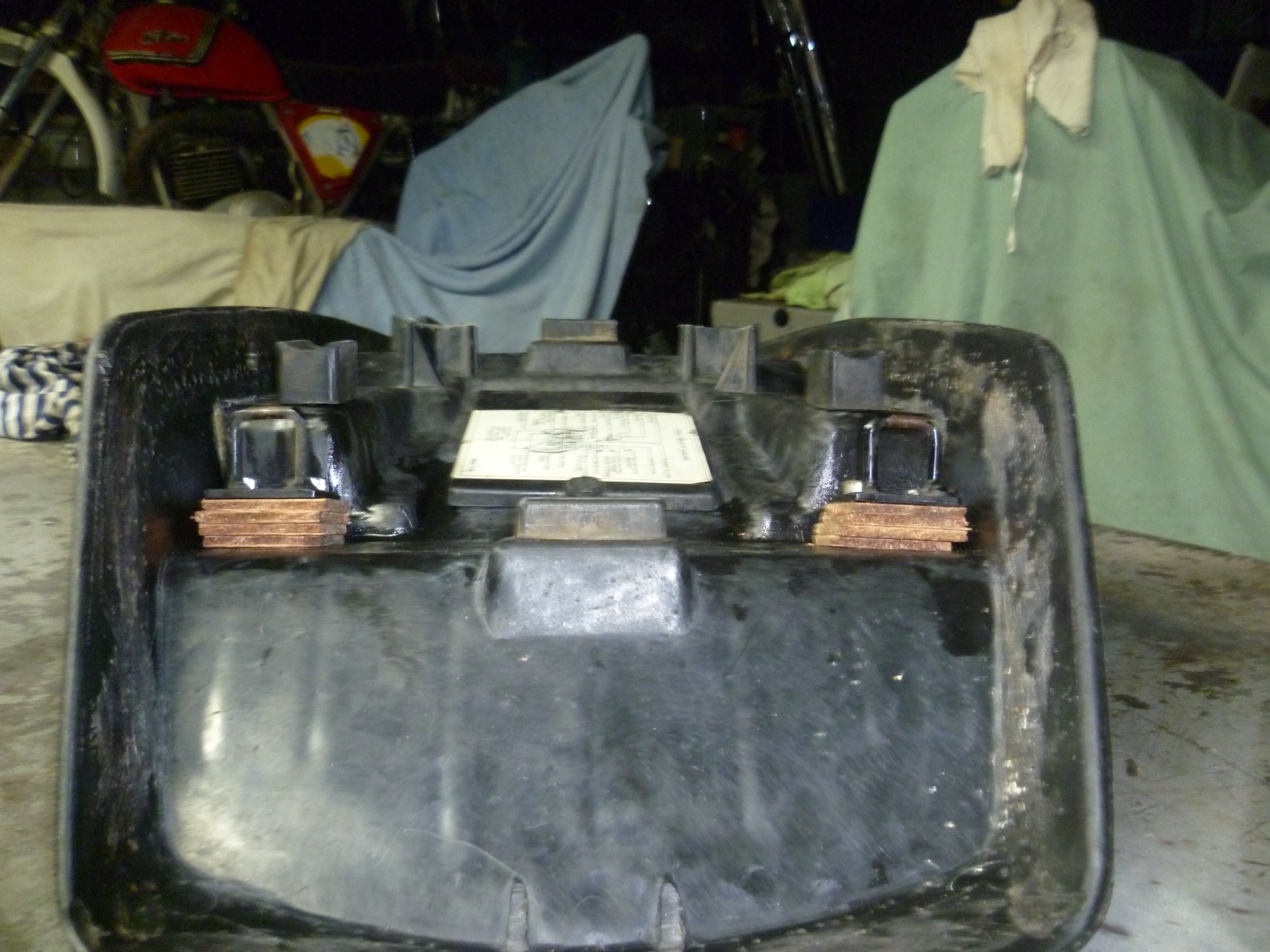

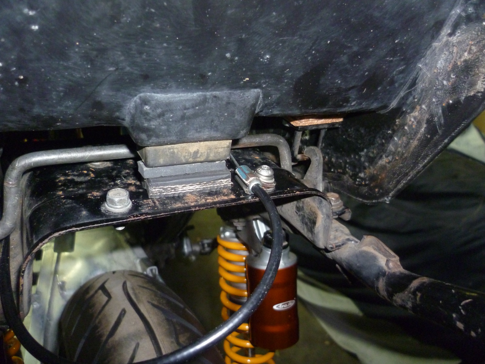

Well, some small advances to the bike. I had to work out a new seat latch, using the MKII tailpiece meant cutting off the handle to the seat latch. I decided to use a choke cable , I looked for a dedicated seat cable but they were all a bit to short, I needed something about 900mm long, so choke cable it is. I fabbed up a little cable clamp to hold the cable end under the seat using the corner of a piece of 25mm box steel, then used a cold chisel to create the bend that cradles the cable, ended up looking pretty good .
I also made up some mounts to fit the tank, again I used some box tube, these were a bit fiddly but turned out ok, they are only tacked on and the gaps underneath will be filled and ground back into shape

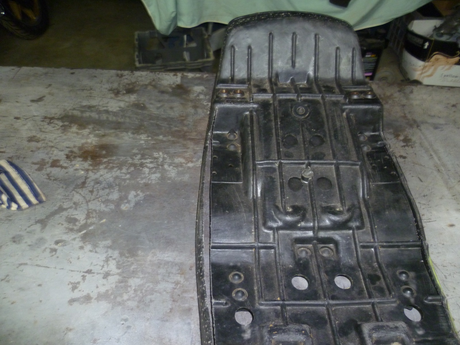

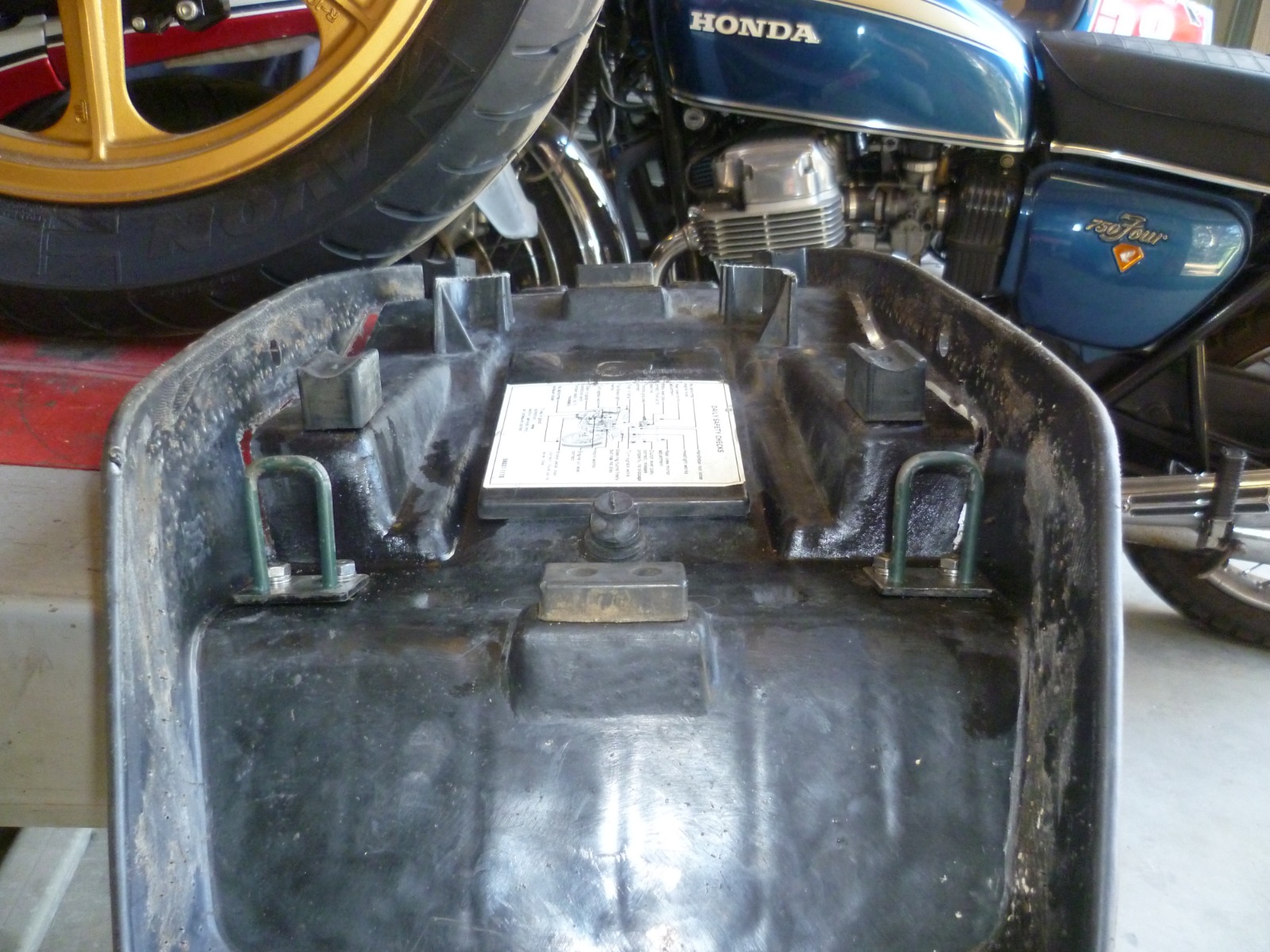

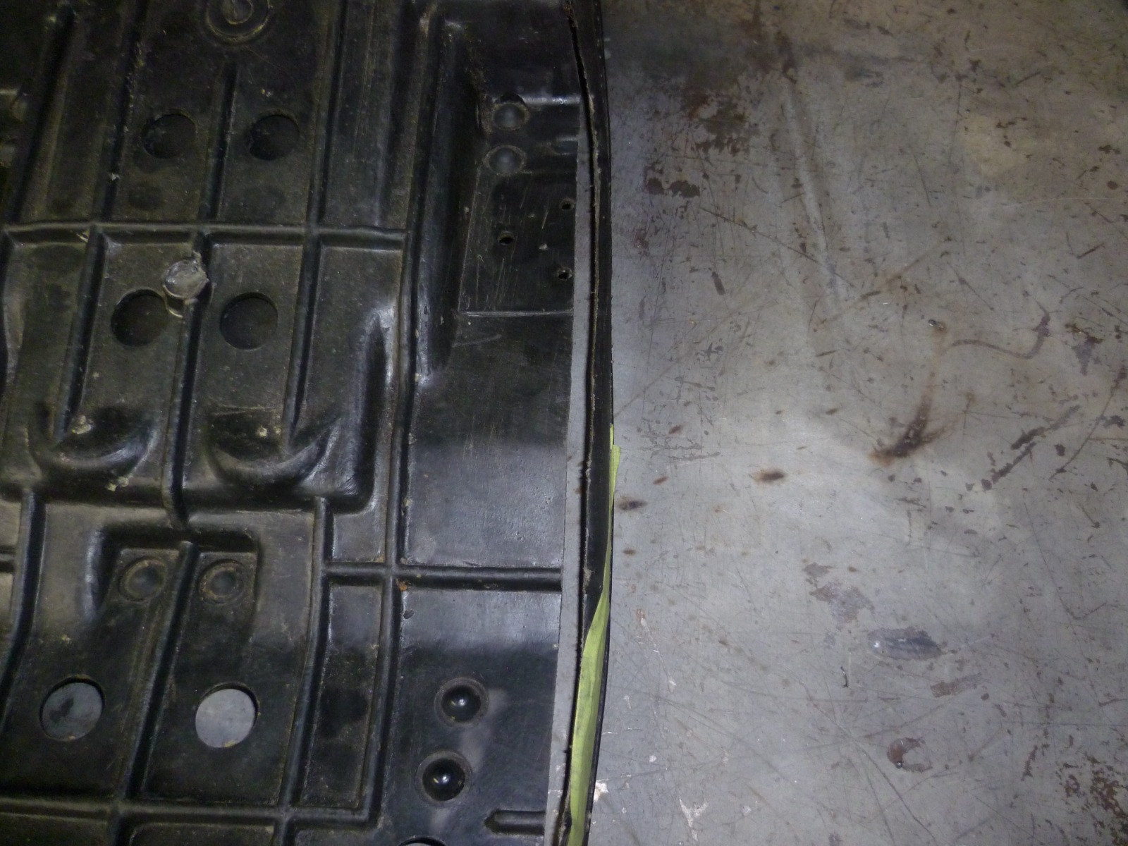

This is what I ended up doing to narrow the seat, its not much but makes a difference, it will be plastic welded back together...
I used some 3 ply pieces to work out where to mount the hooks under the seat for the latch, you move one thing and every thing else moves too...!!!

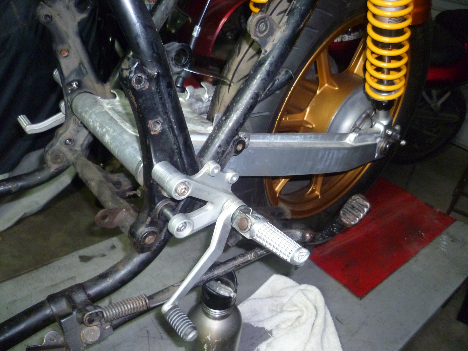

Fitted the rear sets to the frame. I used the original top footpeg mount for the bottom mount for the rear sets, I cut the threaded end off, drilled and tapped a hole so I could use some button head allen bolts to holt it on. For the top mount I used the other footpeg mount, I stuck it in the lathe, cut it down, machined the end own so it had a smaller diameter end on it, drilled and tapped the other end, drilled a hole in each side of the frame and welded them into the frame, I them made up 2 alloy pieces to go between the rear sets and the frame, again I am using 2 45mm long button head bolts to fix them to the frame, I have to make the top mounts removable because the needed to be notched to clear the swingarm pivot bolt. I think I'll make 2 alloy sleeves for the bottom mounts to match the top ones, just for looks, they are strong enough as they are but I think they'd look better, what do you think ?
Nothing is completely welded on the frame yet, most of it is just tacked on, I also have a lot of un needed brackets to be cut off but I don't want to do that till I remove the front and rear suspensions, then I can take the frame outside and spray sparks till my hearts content !!
Still waiting on engine parts to arrive from the UK, my friend that's helping me get some harder to get parts had his Mother pass recently and its hit them pretty hard, No Will and family sh1t fight , so I don't mind waiting till he gets that all sorted....
I'd also like to apologise for the lack of detailed pics, I'm not used to documenting anything with pics and keep leaving the bloody camera at home, If anyone wants some more detailed pics, let me know and I'll see what I can do...

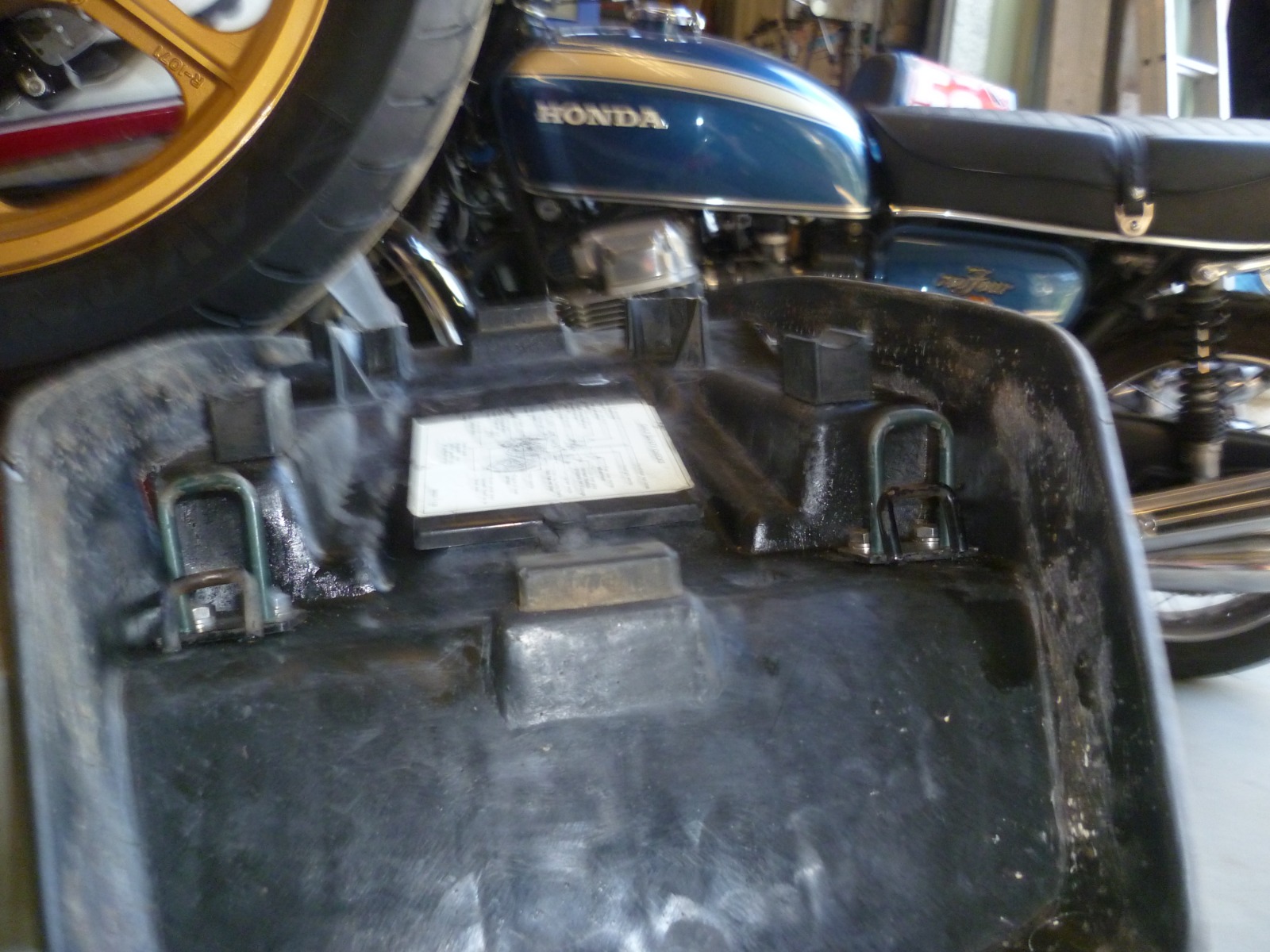

Finished off the cable connection to the seat lock, simple but effective..

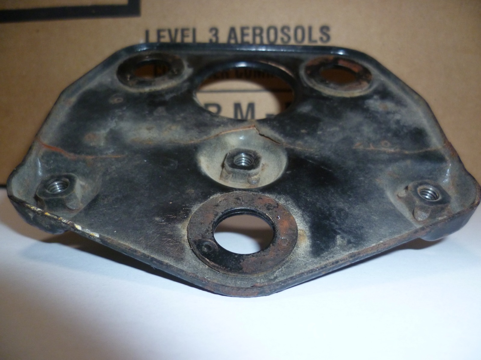

Also made new tabs for the seat to latch down, first pic is the old tabs sitting in front of the new ones

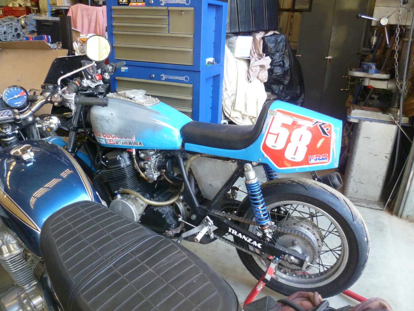

My Bikes in good company, these are just a couple of the bikes in my friends shop, what you can't see is a GT750 water bottle, a Rickman CB750, another couple of Honda 750/4 race bikes, a GPZ1100, and a few I've forgotten

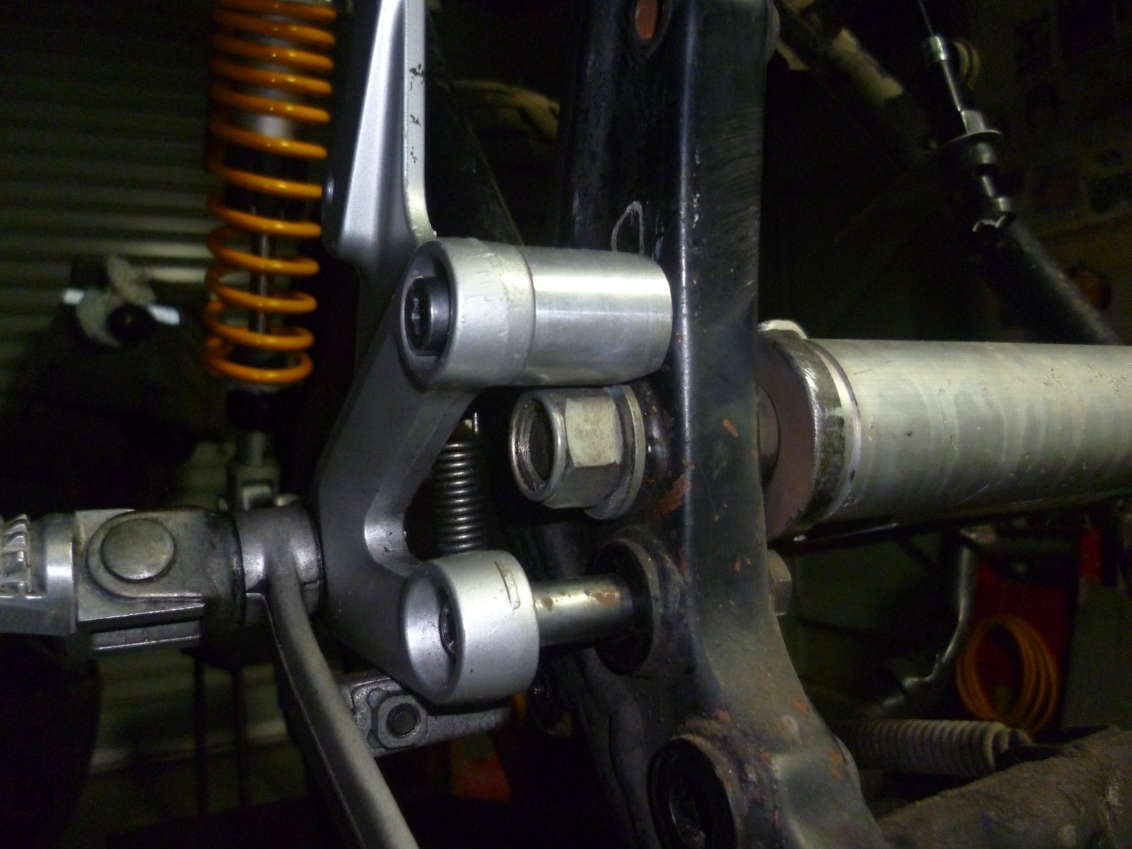

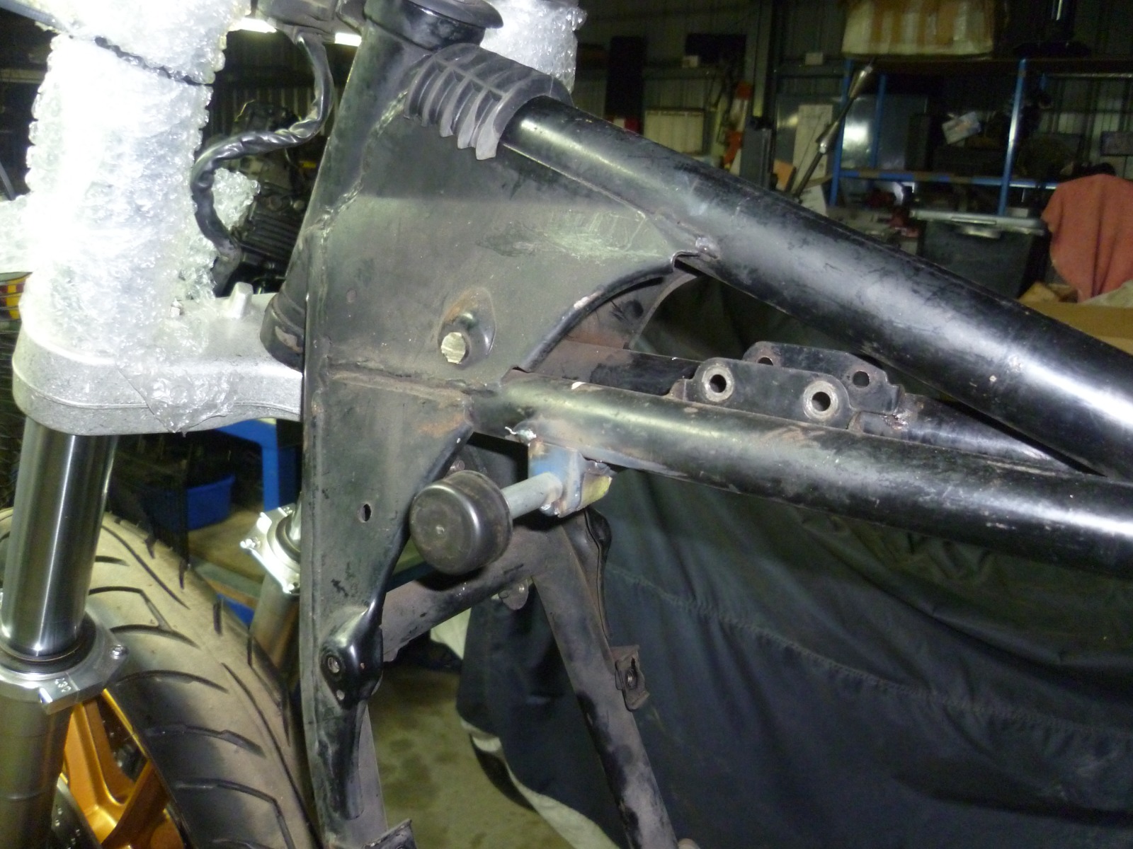

I made up alloy sleeves to match the top mount for the rear sets, they now look like they should. I've removed all the mounts for the side covers and cut out all new mounts to be welded on this coming week, I had to remove some material from the side covers and become a little industrious with fitment options. I also made up new steering stops.
