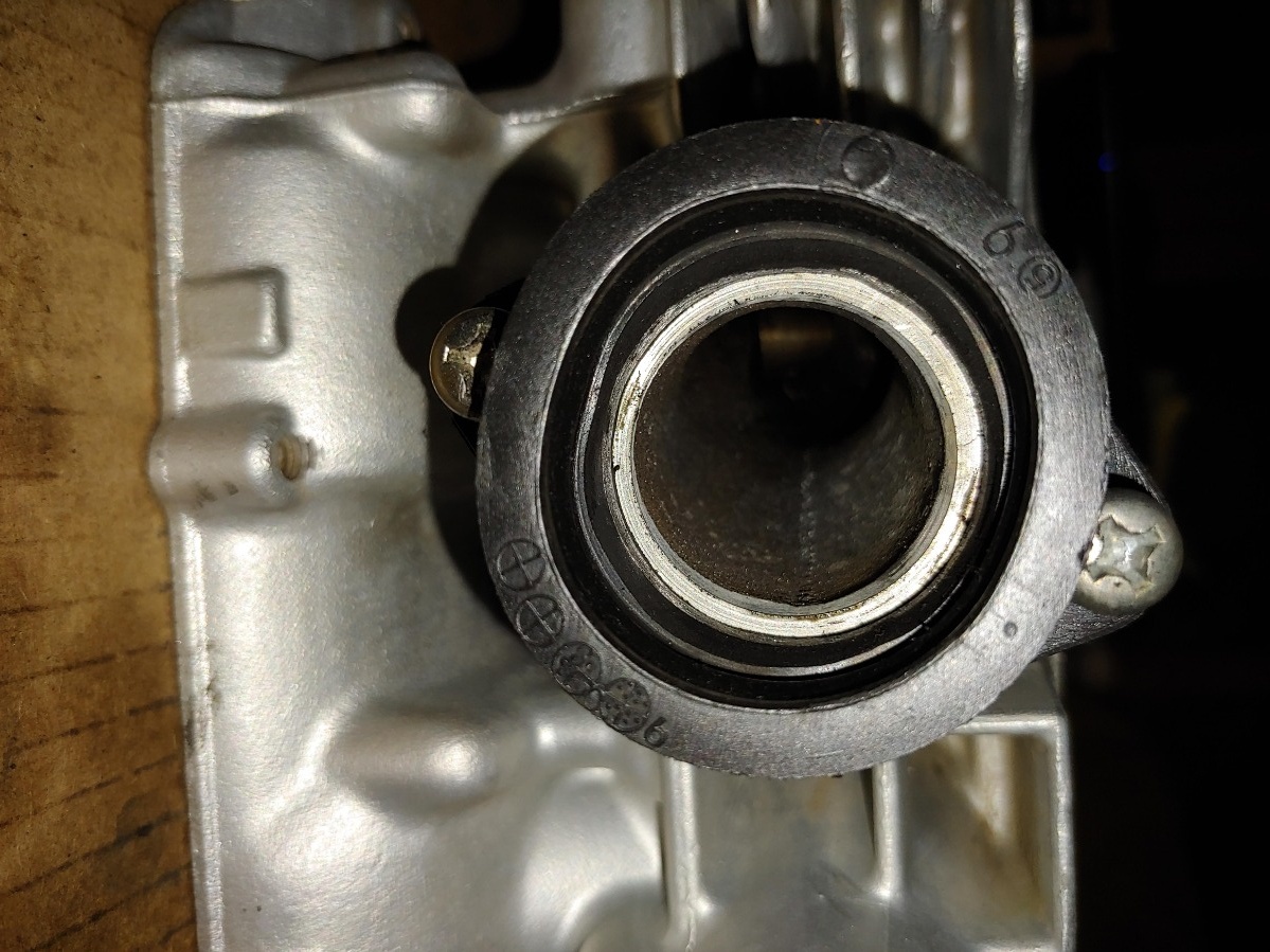

-KZ750 carb boots (dont use the 16065-1135 boots, both have to be ported for the GPZ throttle bodies!)

Current ports:

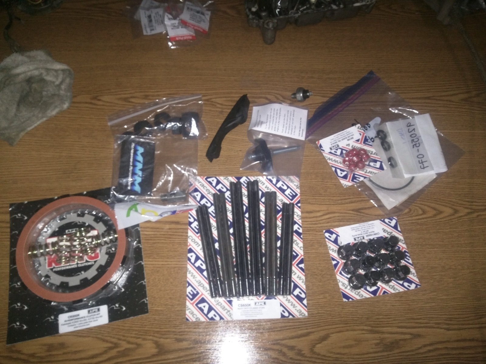

APE parts:

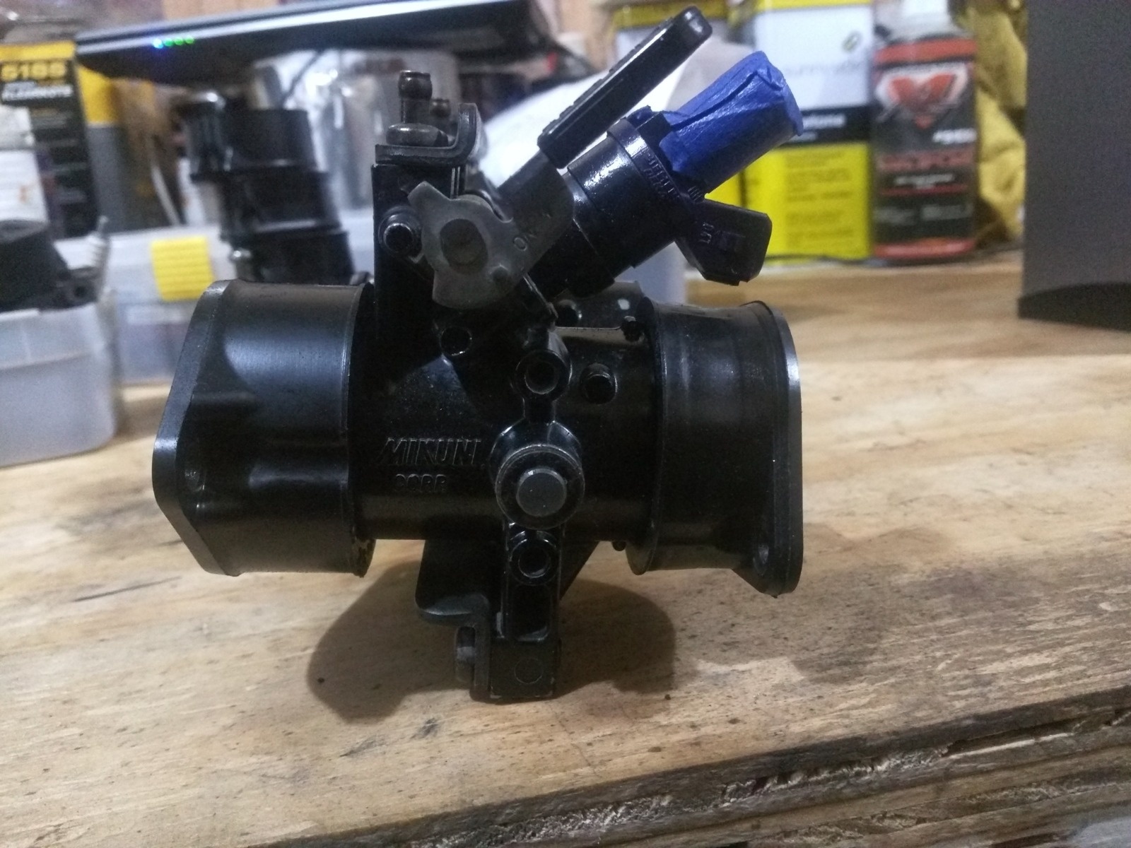

TB rack:
Side profile of rack w/ injector
Nozzle end of injector

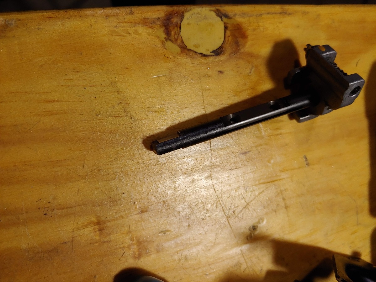

Modifying the TB rack shaft for the mikuni TPS. Not a direct fit on the shaft as the 750turbo forum said.

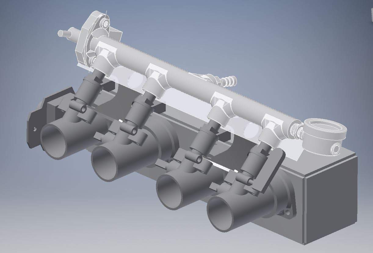

CAD model of TBs. I need to redesign and fab the fuel rail and TPS mount because :sick:

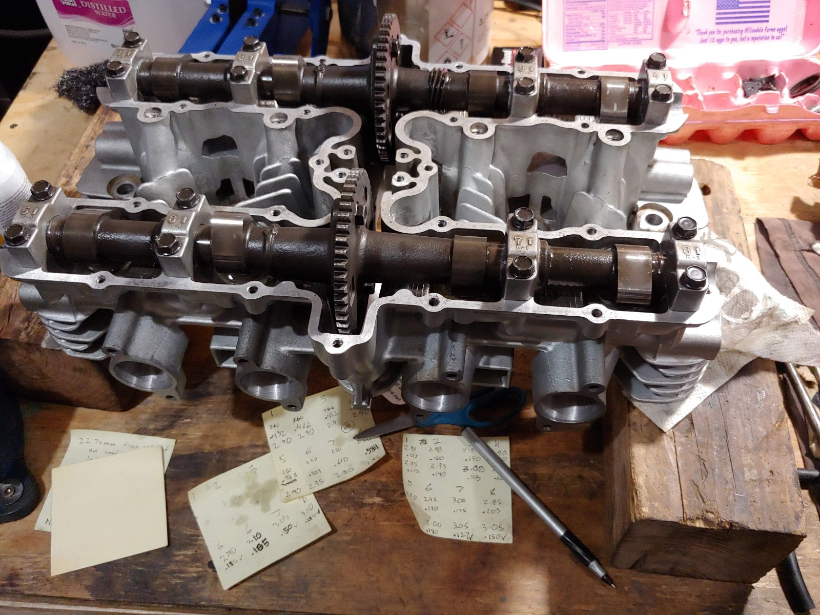

Doing valve shims. I was really close here. Largest shim was 310, smallest 290.

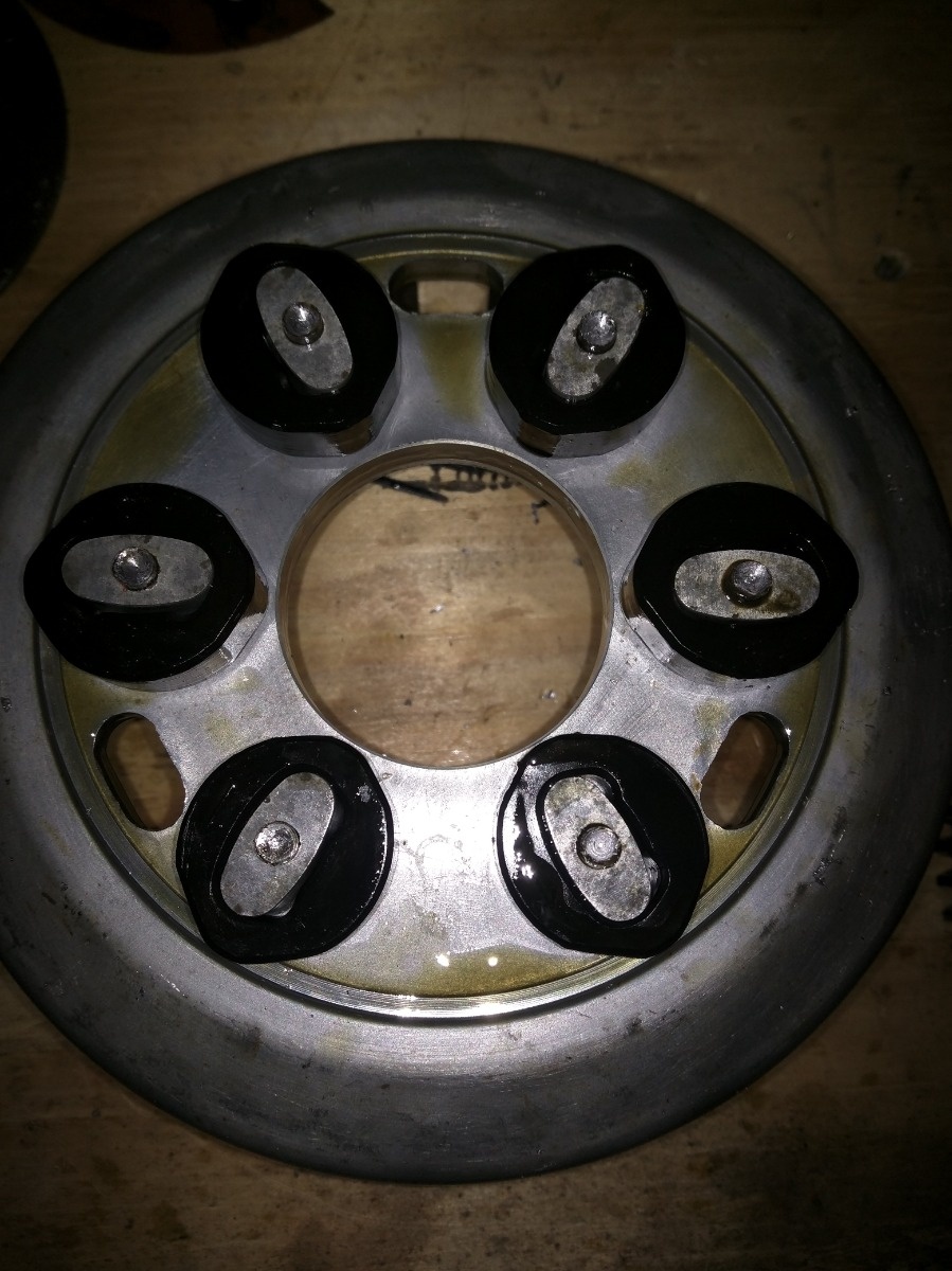

mid way through the clutch rebuild. I meant to get the solid GPZ dampers, but i guess that's the difference between the kz750 and gpz dampers. oh well. my fault

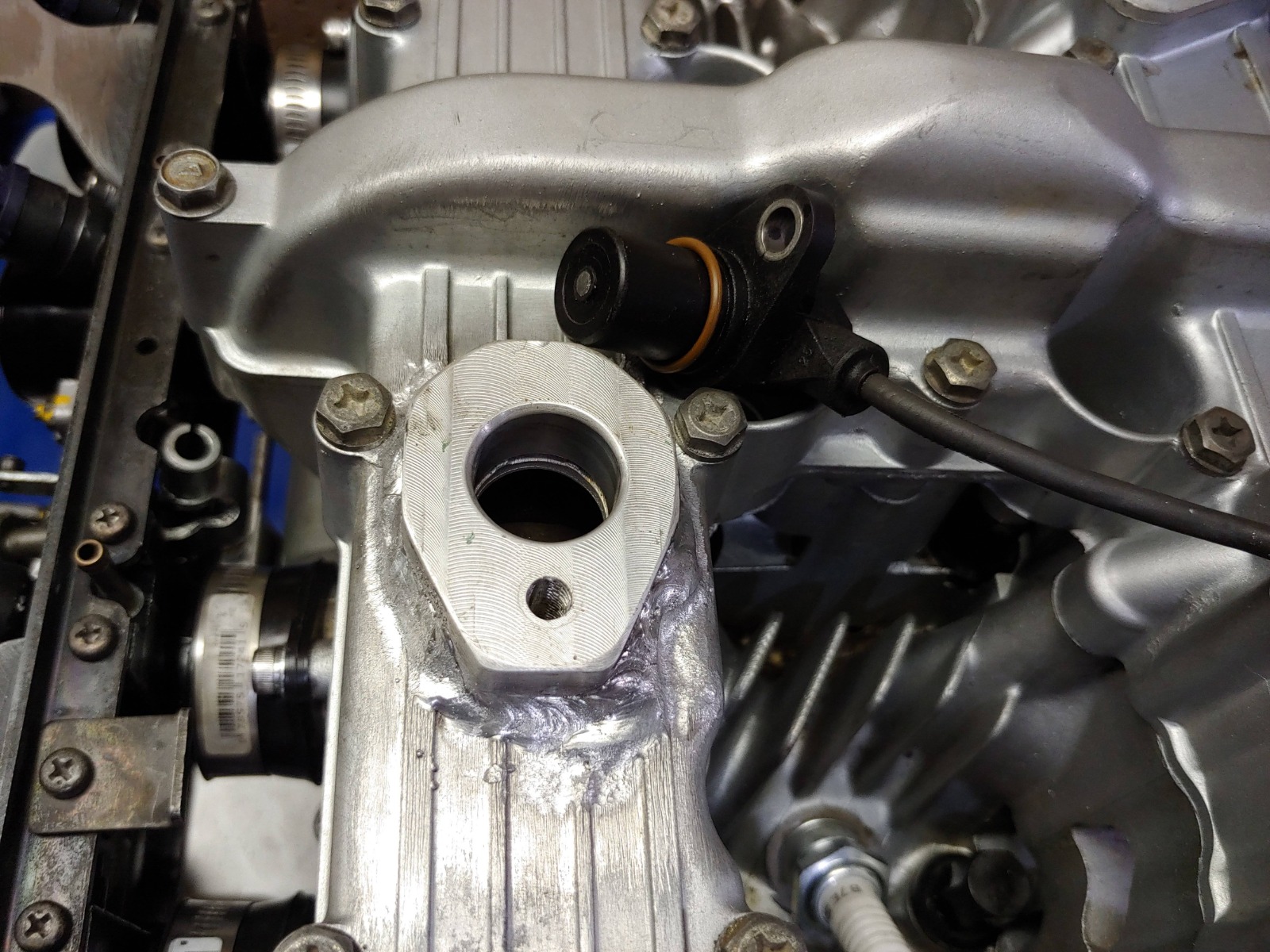

Hole in valve cover for hall effect sensor
Bung welded on:

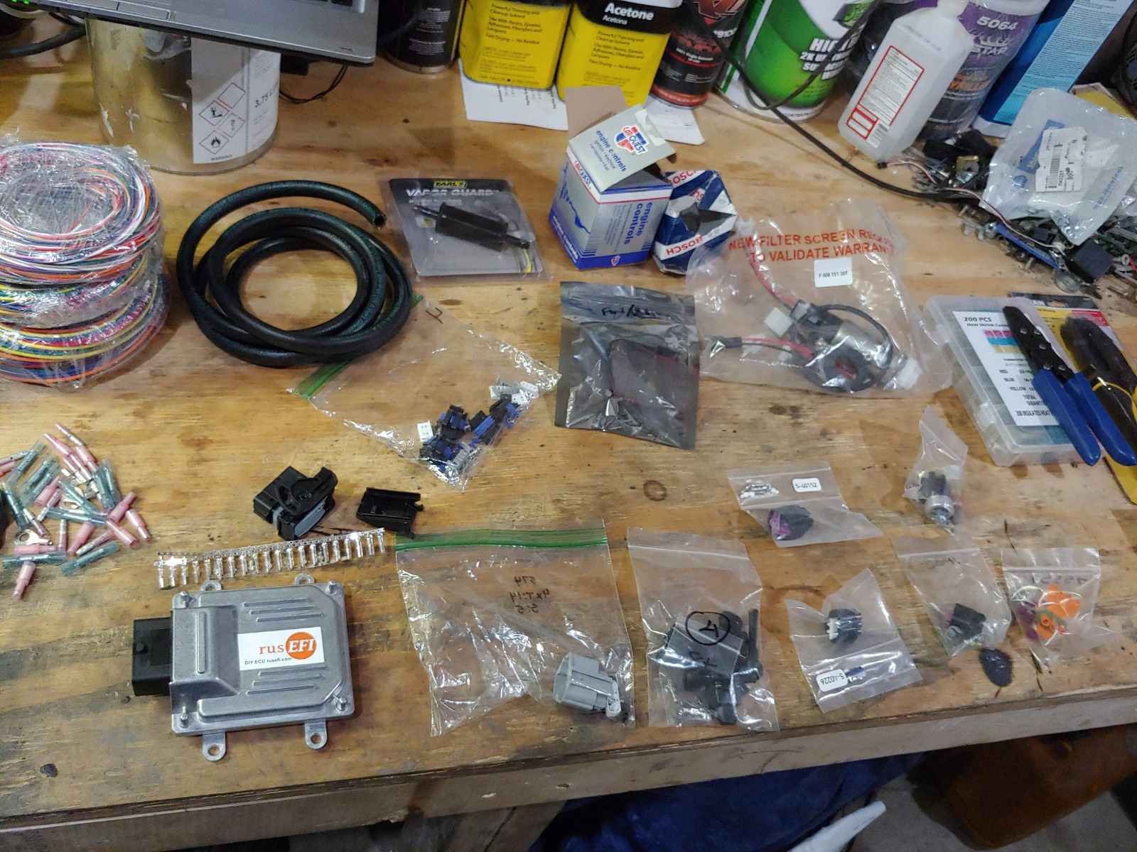

As for EFI parts and tips...
Ive bought parts from ballenger motorsports (tools connectors, sensors), ebay (genuine sensors, connectors, wire assortments) and amazon.
Do not cheap out on connectors, wire, or sensors, well anything really! haha
I would recommend buying connectors with pins (no pigtail) and making the harness way cleaner. When you do need to branch or butt a connection, use barrel crimps and put a solder heatshrink thing over it
I'd recommend TXL type wire of the proper gauge for your ecu/connectors/amperage.
Make sure you get a good crimper for every kind of terminal/crimp you have.
Dont use those stupid waterproof marine crimps (metal is too soft and wires pull out so easily). use standard insulated or non insulated crimps.
use shielded cable for the VR sensors, especially if they are near the spark plugs. i stole some from the O2 sensors from a car harness
I machined that at workGot a chance to review your post on detail. VERY nice! Lots of good details.in there.....
Where did you get the Bung for your Hall Effect Sensor?
that sounds awesome man! i focused on getting it running first and then will go back for paint. I cleaned all the parts before assembly, so another clean and masking and it will be ready for paint.That looks great....! I will be following any updates! I just got home from some running and my Gpz1100 TBS AND my MS2 were on my doorstep. I've got about 6 weeks of home improvements I'm working on right now... but getting a lot of research and parts ordering going. This is something I've been slowly looking into for about 5 years and just recently pulled the trigger on going the fuel injection route. Plan on starting by getting the stock 650 EFI'ed - that will be a bit of a learning curve.
