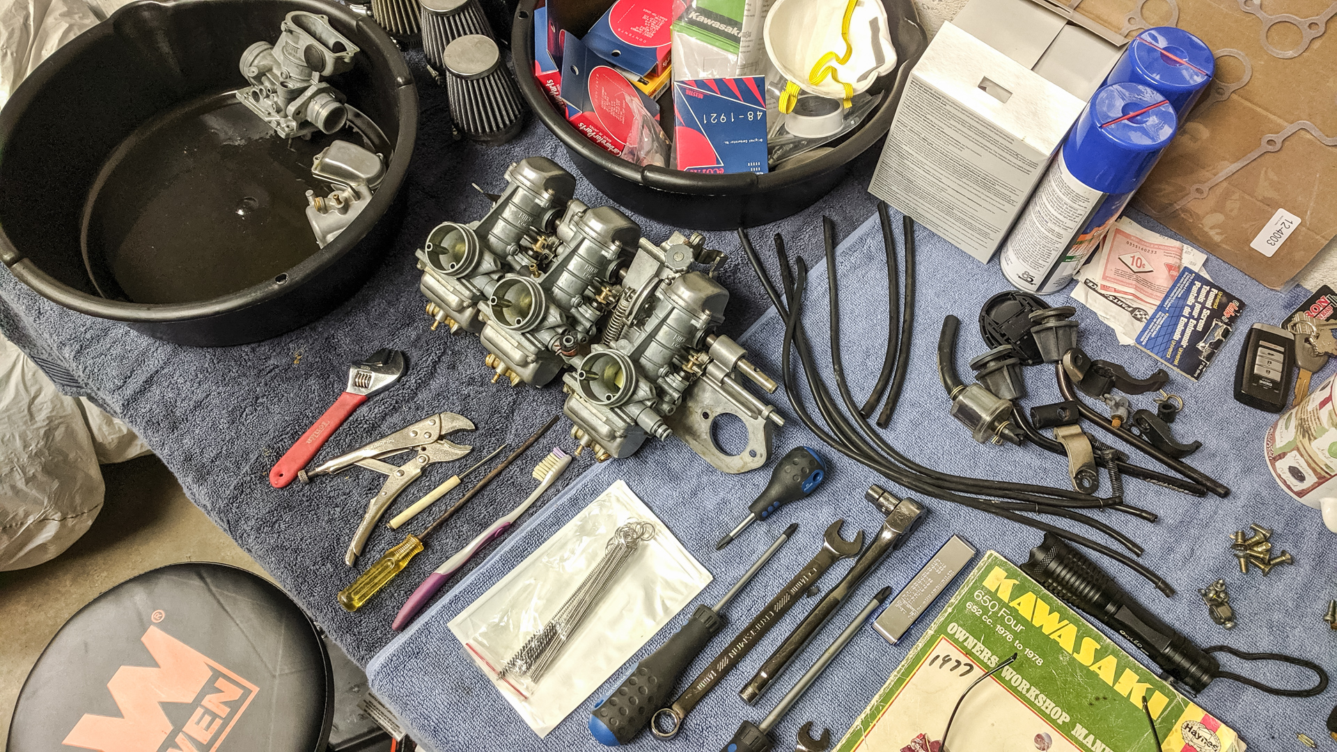

Carbs Out:
Disassembled pieces:
End of my night
- removed visor and mirrors
- removed carbs, disassembled and cleaned first carb
Couple questions for the wise folk of KZRider...
1. I got some nasty cracked gas lines that I found out about. Do you guys just find generic hoses or do I get specific ones from Kawasaki?
2. For the above fuel filter, is a Kawasaki replacement good or should I get something aftermarket?

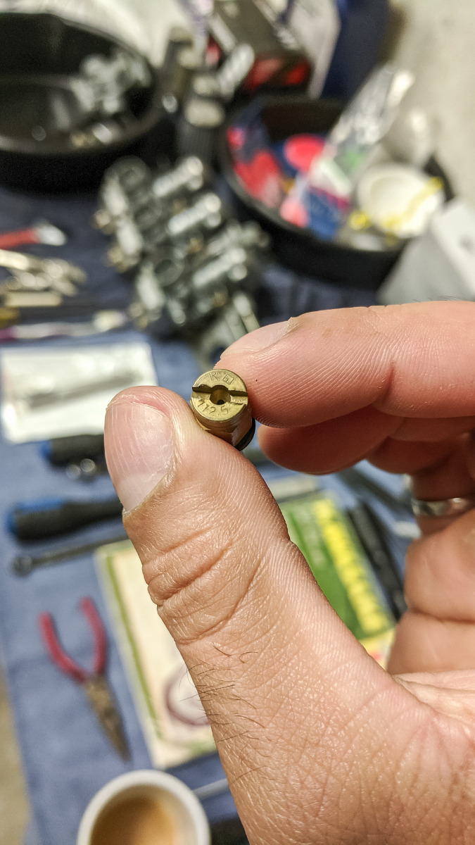

These are my jets:
3. The how-to video I was watching didn't have 2 parts to the pilot jet, it was just one. Maybe I missed something in the video, but does my set look normal?
It says 112.5 on the main jet and 15 on the pilot. What do most people like running here?
Also, how clear do the passages get for the jets? For the main jet, it was like a pinhole and I used some wire and now looks like this:
The jet on-top of the pilot jet (un-marked, stubby) looks like this after cleaning:
But my pilot jet still looks like a pinhole:
4. I can't even get my thinnest wire through. Now I'm trying very lightly, as to not damage anything. Is the pinhole light I'm seeing here normal or should I keep at it?
Thanks for viewing and help in advance! Will get to carb 2-4 tomorrow...

One bristle from a wire brush works well to clear jets. And that pilot jet hole is very small. Good job checking them against a light.
You should replace the carb O-rings with new. Cycleorings.com sells a VM kit that will help.

Here is one of the best filters available, and they are reusable.

I use the Golan Super Mini fuel filter that TexasKZ recommends - it is perfect. Regarding the fuel hose, I have tried a number of different ones over the past 42+ years and found that the GoodYear 5/16" Fuel Hose SAE 30R7 is absolutely the best. The link below has more info. Ed

It appears you have a set of vm24ss carbs that only have a pilot air screw. To the best of my knowledge all of the carbs (VM22 and vm24)that came stock on the 650s in the US market only those with the pilot screw have the additional #50 jet over, or under depending upon who you want to look/explain it , the the pilot jet.
I removed my years ago and the bike runs fine. I am not really sure why this additional jet was added, but feel that the engineers and designers thought it was needed to to provide a rather logical power band.

The stock jeting on a 77 KZ650 B1 (VM24) is #16 Pilot and #100 main Jet.
Keyster No.: KK-0041 kit offer a #15 and #102 jets
So with your #112,5 main Jet you are a little rich on a stock air box. Your main jets ( #112,5) is more like for runing pot filter.

The best fuel hose I've found is that sold by Suzuki
www.partzilla.com/product/suzuki/09352-70103-00B
Order this PN and they send you about 5' of the stuff. Enough to do several bikes. It's 7mm and stretchy, just like the OEM Kawasaki line. You don't need to use clamps, just slip the line over the nipple fittings.
Car fuel line is much thicker and has a braided inner core to resist high pressure (which KZ's don't have.) 1/4" line is very tight and hard to install and 5/16's is looser than stock and you will have to use clamps too or it may leak.

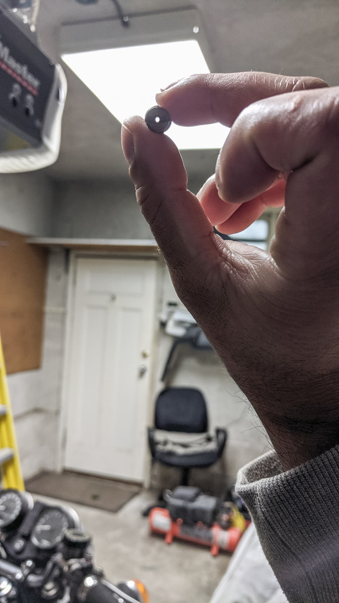

The only hitch I had was with the pilot needle. I didn't check on the first two carbs how far from fully seated the settting was. I noted on carb 3/4 it was about 2.75 turns from fully seated. I got them snug before measuring.
The manual (like to page in the post above) say it should be set to just 3/4 turns from fully seated... So I guess they were way off before? Going to set them all to 3/4 turn and see how that goes

Be extremely careful with the pilot screws since the tips love to jam in the orifice and break off. This typically happens when someone is trying to bottom out the screw before resetting them. Be sure to spray carb cleaner through all the passages and verify you are getting flow through the small hole and into the carb body. If the pilot screw doesn't turn easily buy a tap and clean the threads. I think it's 6 x .5 but measure for yourself to verify.

Thanks, my threads seem clear I can seat it all the way as far as the o ring let's me. I'll take em out and make sure fluid goes through, didn't check that before.
Also, can someone confirm if that pin hole light I'm seeing through the pilot jet is normal? Should it be any more than that? What have you guys experienced in pilot jet difference after cleaning?
