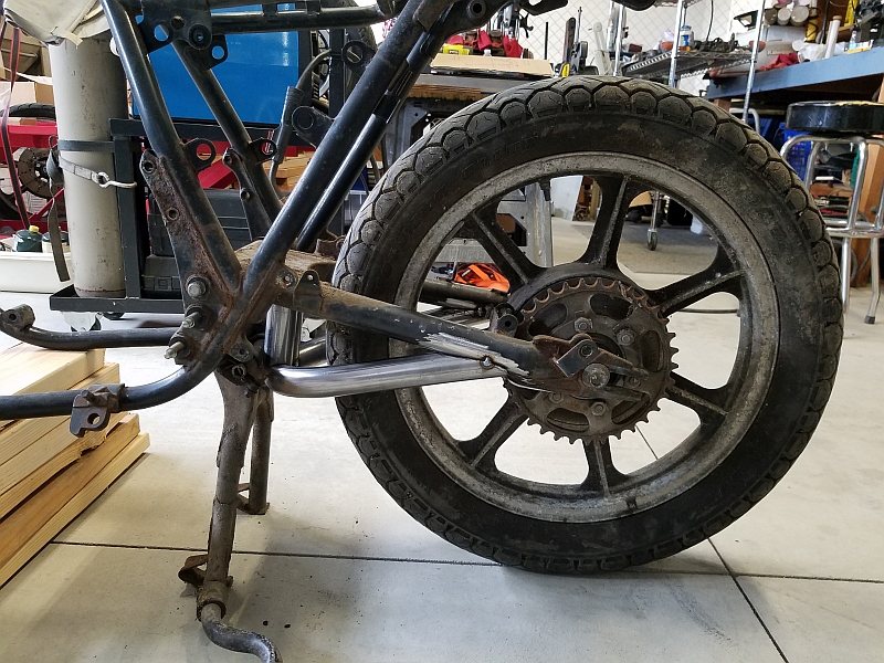

Re: Saving a '81 KZ750-E
08 May 2019 12:01 - 11 Oct 2022 13:43
Retired gearhead
'81 KZ-750 E2
'81 KZ-750 E2
Last edit: 11 Oct 2022 13:43 by Street Fighter LTD.
- scubaanders
- Posts: 556
- Thanks: 239
08 May 2019 12:42
That brace turns out really nice
15 May 2019 11:14 - 11 Oct 2022 13:44
When I started to fab this swing arm brace, I had to make some assumptions. The main one was to follow the profile and width of the original swing arm. All I had to go off of was pictures from the side on existing bikes. In the back of my mind I was wondering if there would be enough clearance for the chain. Well, I got it tacked together, and fitted it to the frame yesterday. Total failure! Glad I only tack welded it together, because now I have to cut it all apart and start over again. I am thinking the width needs to increase at least two inches to create the space needed for the chain to clear. Unfortunately my tube bender will not go past 135 degrees, so I had a friend bend the piece I used to mock this brace up. I will need to split it on center line, add a piece, and weld it back together again. If it comes out looking like Frankenstein I will at least have a better mock up to start a new tube bend. The other issue I did not get right is the section that joins the brace tube to the original swing arm. I went with perpendicular to the swing arm, but it needs to be angled back toward the rear axle at least 10 degrees to clear the frame tube (see photo). Back to cutting and grinding! Revision B coming up in a few weeks...
