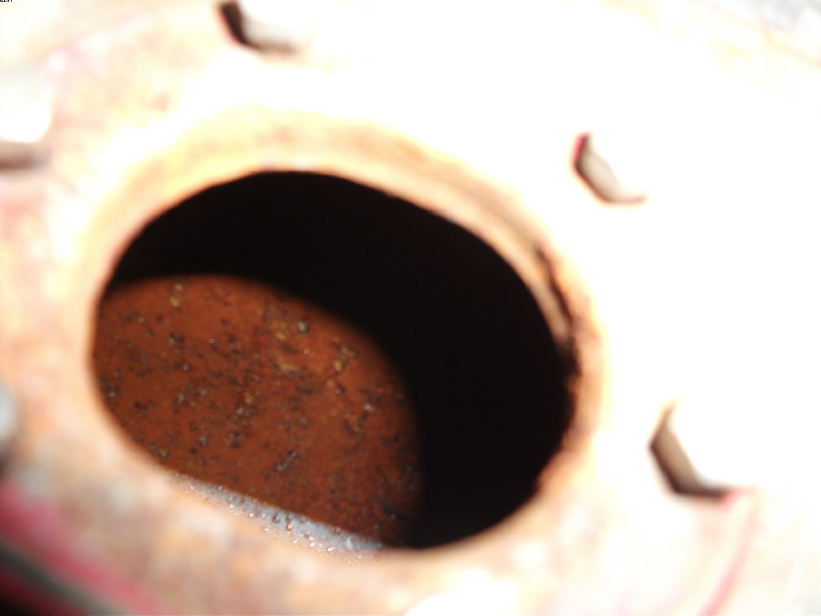

The first pic shows how much rust was inside the tank. I poured 3 gallons of Evapo-Rust into the tank and moved
the tank to different positions for a couple of days. It removed all of the rust. There are some black stains inside
the tank but it's cosmetic at this point. I'm waiting for a Caswell epoxy gas tank kit to come in.

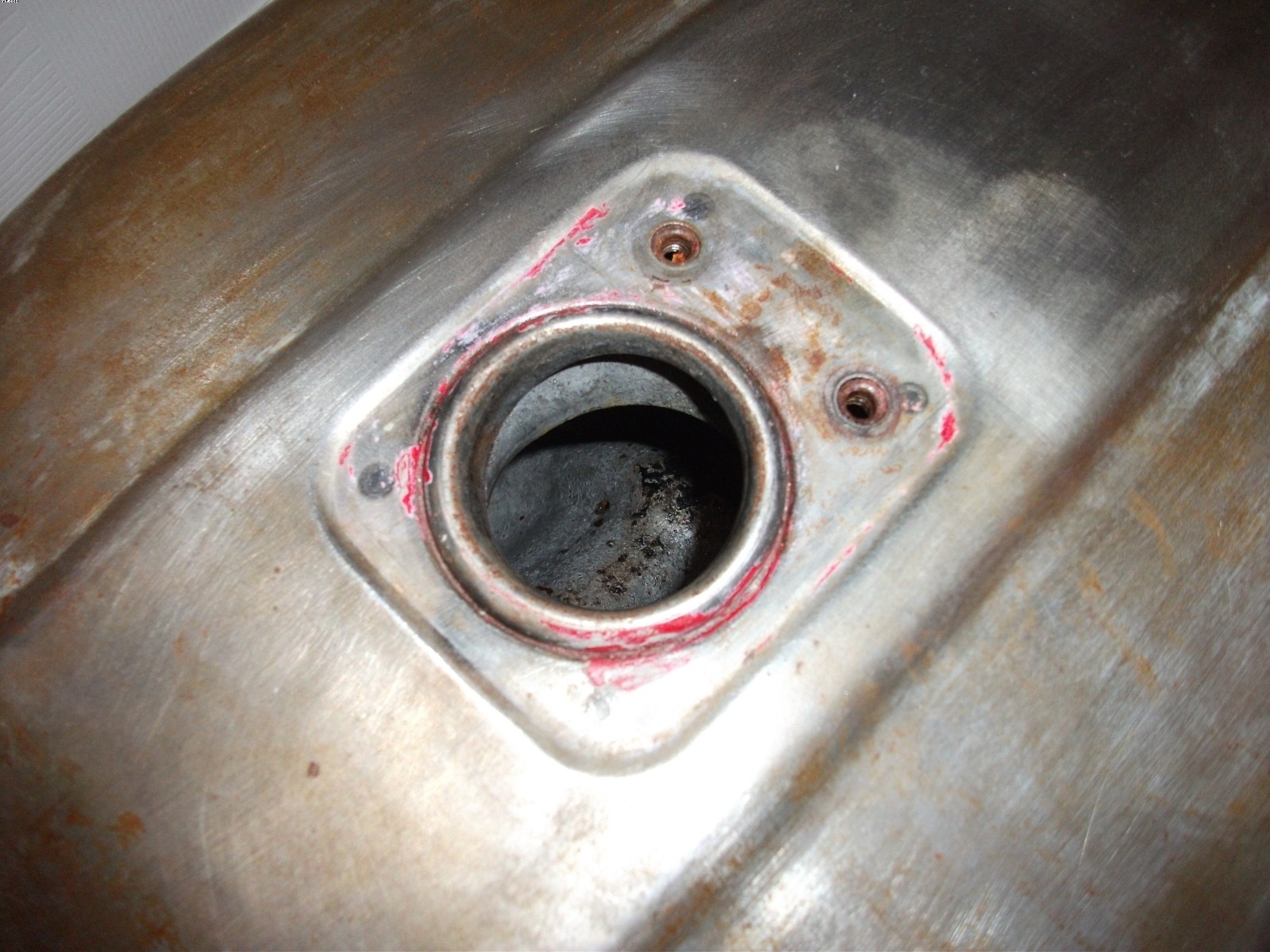

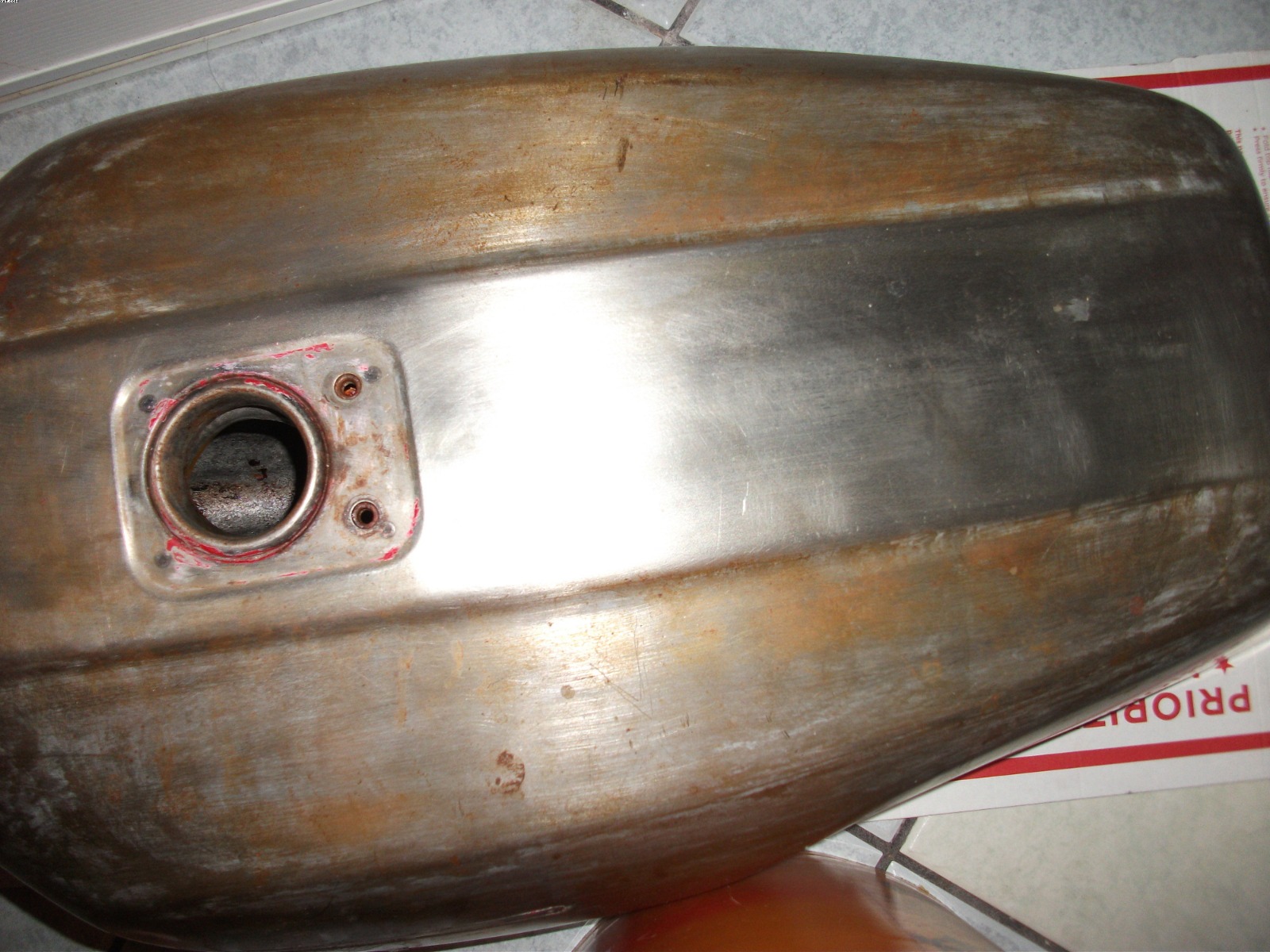

The pic of the top of the tank shows the center shiny and free of rust. I dipped a maroon Scotchbrite pad in
the heavily used Evaporust and removed the rust from the top-center of the gas tank in less than 3 minutes.

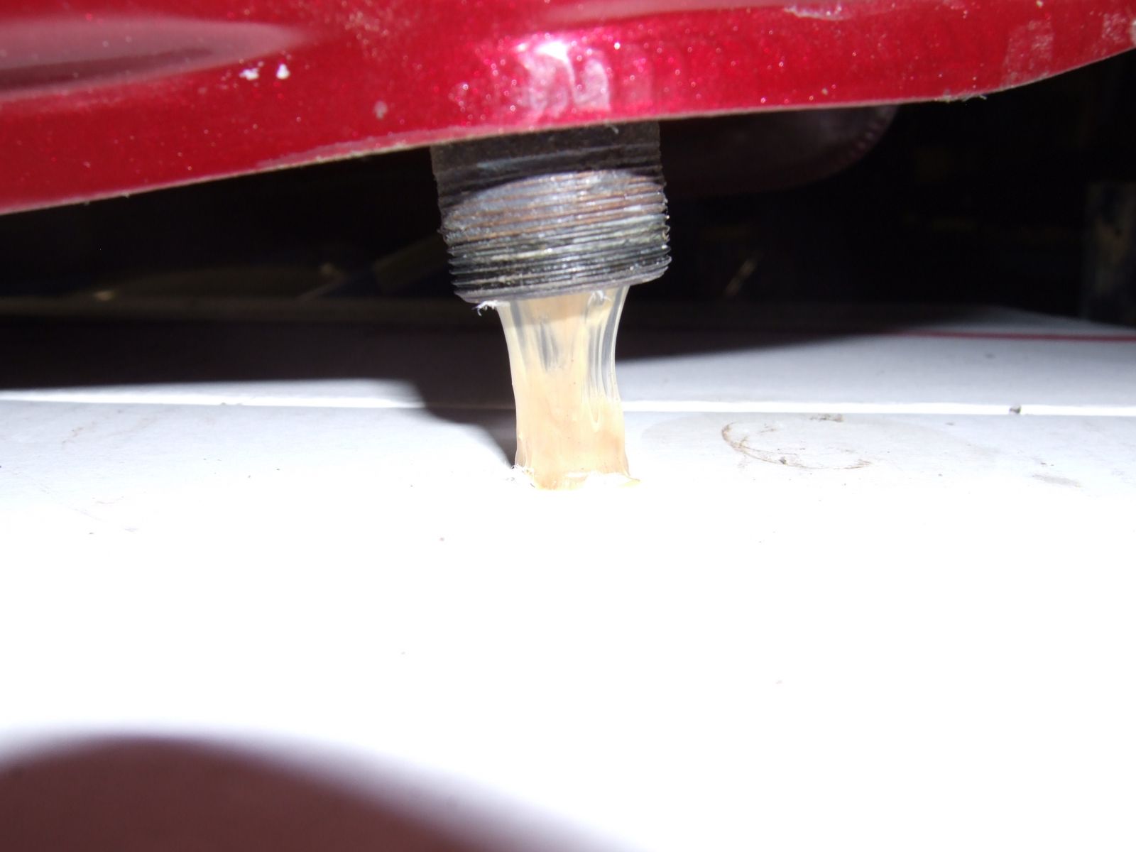

If it doesn’t leak why coat it.... it only presents a potential problem in the future... I’ve cleaned tanks before and by just keeping fuel in them will keep the rust from returning.... the included photo is tank coating settling to the bottom of the tank after sitting unused for a few years... I used acetone to remove it (seriously a PITA) and have used the tank for several years uncoated and no rust has returned...

Skidmark, I have no idea the PO coated the tank... I was the shlub that had to get it out...
