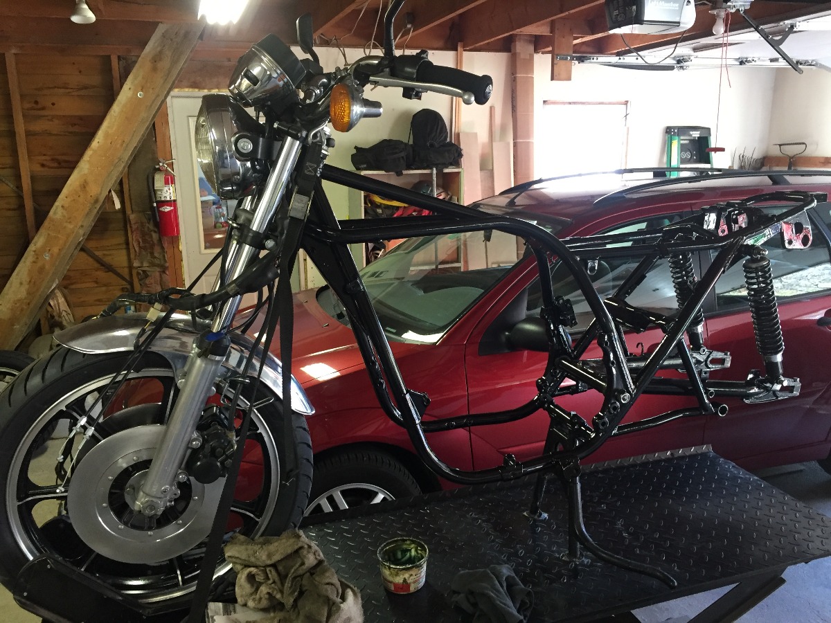

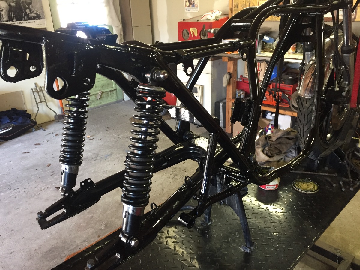

Firstly, I am definitely NOT a paint expert, although I have painted a few in my first life(was a bike mechanic in the '70's). If you want to use a paint gun and automotive quality paint all the advice you have gotten so far seems spot on. I used a touch up gun when I did frames also, and they work excellent for this application. So I am definitely NOT saying not to go that way.
However.
Refinishing a '78 LTD over the winter, and I really wanted/needed to keep the cost as low as I could, and also do as much as I could myself. The LTD frame had some rust from the rear brake MC leaking, etc. So I spent a LOT of time sanding, used a spot sand blast gun which I had, and a soda blaster (borrowed) to clean up the frame.
Then, POR-15 (I know, I know) after following all (and I do mean ALL) their directions, including the etching solution. Used a small brush (GASP!!!!), 2 coats, with sufficient dry time to allow tacking, then 1 coat of POR15 top coat, followed by a final spray of the top coat. The top coat is a pretty new product for them.
Results shown. Brush marks minimal as the flow out is actually pretty good. Time will tell how it stands up, but my prior experience has been positive.
Just saying there is more than one way to skin the cat.
