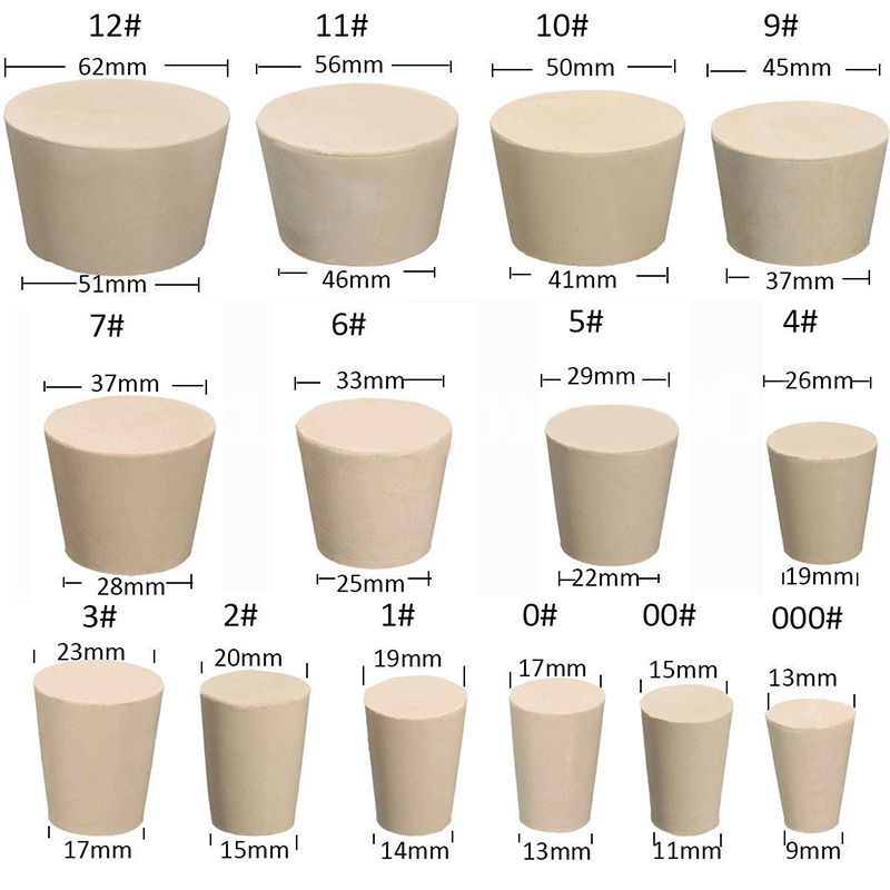

pour gallon of Acetone and got most of the bottom part of the tank cleaned. But just how you guys happened to plug the fuel inlet? I tried duct tape but came right off. I'm not about to use the fuel cap, so how?
As I mentioned before, I need to paint my tank anyway, so getting the Acetone on my tank is no problem, so little drip here and there are no problem. But I had Acetone gushing out when the tape came off.

No eBay APP ID and/or Cert ID defined in Kunena configurationHave you try silicon plugs like this or a bathtub plug to seal the fuel inlet?
A good household supply store should have them or evil bay

By Ojisan rider: But just how do you guys happened to plug the fuel inlet?
I used a compression plug or freeze plug from the hardware store.
It's a rubber plug that has a hole thru it for a bolt & nut, usually a wing nut.
Mine has a large rubber gasket below the large wing nut washer to protect the tank. not sure if it came with the gasket or if I put in on there. it looks suspiciously similar to the oil seal found on the bottom of my triple tree.
For the petcock & fuel switch outlets, I made block-off plates from sheet rubber & 1/8" oak & put teflon tape on the bolt threads.

Thanks guys. I'm running to the nearest hardware store now.
Really, until now, never thought about that.

here's what I Did:
shop.advanceautoparts.com/p/dorman-help-...-in.-02602/5701279-P
rubber expansion plugs to plug up the holes.
Any screw holes? I used electrical tape wrapped around a bolt and this sealed the hole up. (I kept a sacrificial petcock that was broken on to close the petcock hole.
