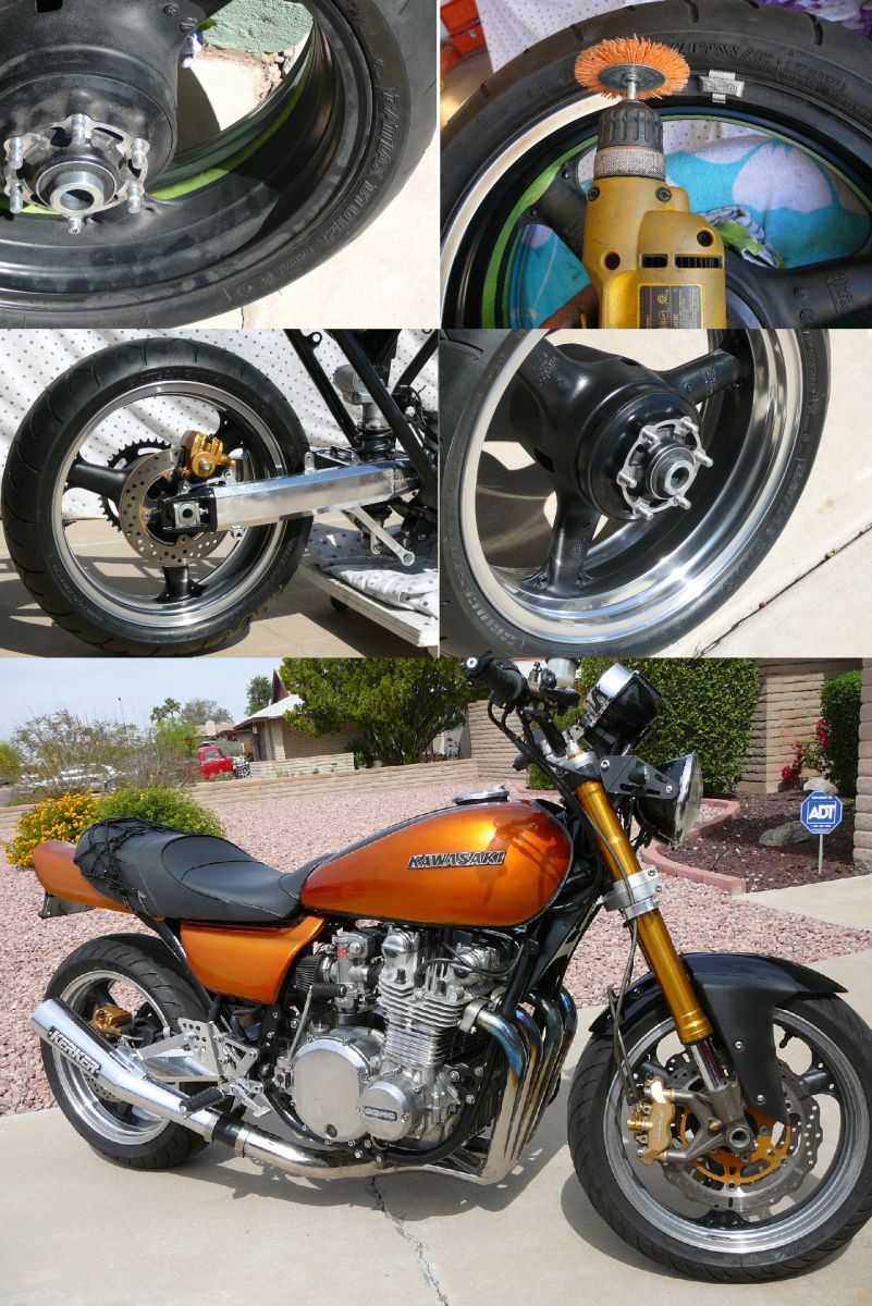

Start w/ Blue or Orange to remove heavy oxidization. Then Blue and Simple green for some shine and clean. Bottom image engine case, orange wheel and simple green, that's all I did on that case...
Engine side covers: Blue wheel to remove oxidization, then hit with some 1000-1500 wet sand paper for swirl marks then buff out with WHITE buffing compound...

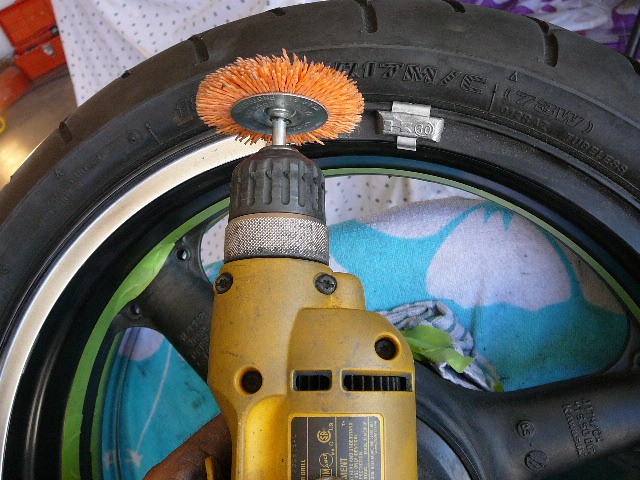

Thanks! In the wheel pic did you just paint the whole wheel and use the nylon wheel to remove the paint on the band area?

I didn't paint the wheel at all, this was the hard as hell OEM rim paint they use.... I seriously would love to know what they used and where to get it for frame paint!!!! This crap is tough as nails... :blink:
Tried different chemicals with zero results, no freaking way was that coming off until I used the medium nylon wheel. Still some work to get that rim paint off but desired results as expected....
Just removed the OEM paint to the center rim area/lip and buff out...

your bike looks really good omr. I really like it. I wish i could do a front end conversion like that.
