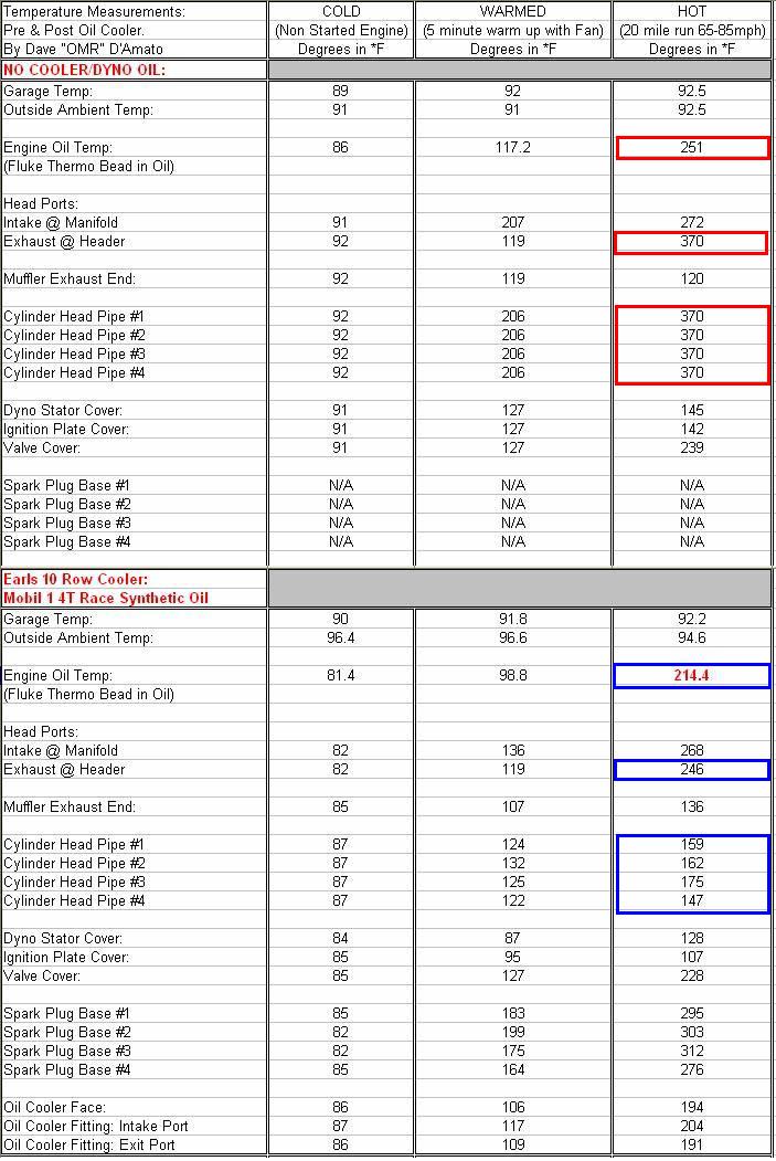

Here are some temp measurements from OMR's built 1000 in Arizona. YMMV.
