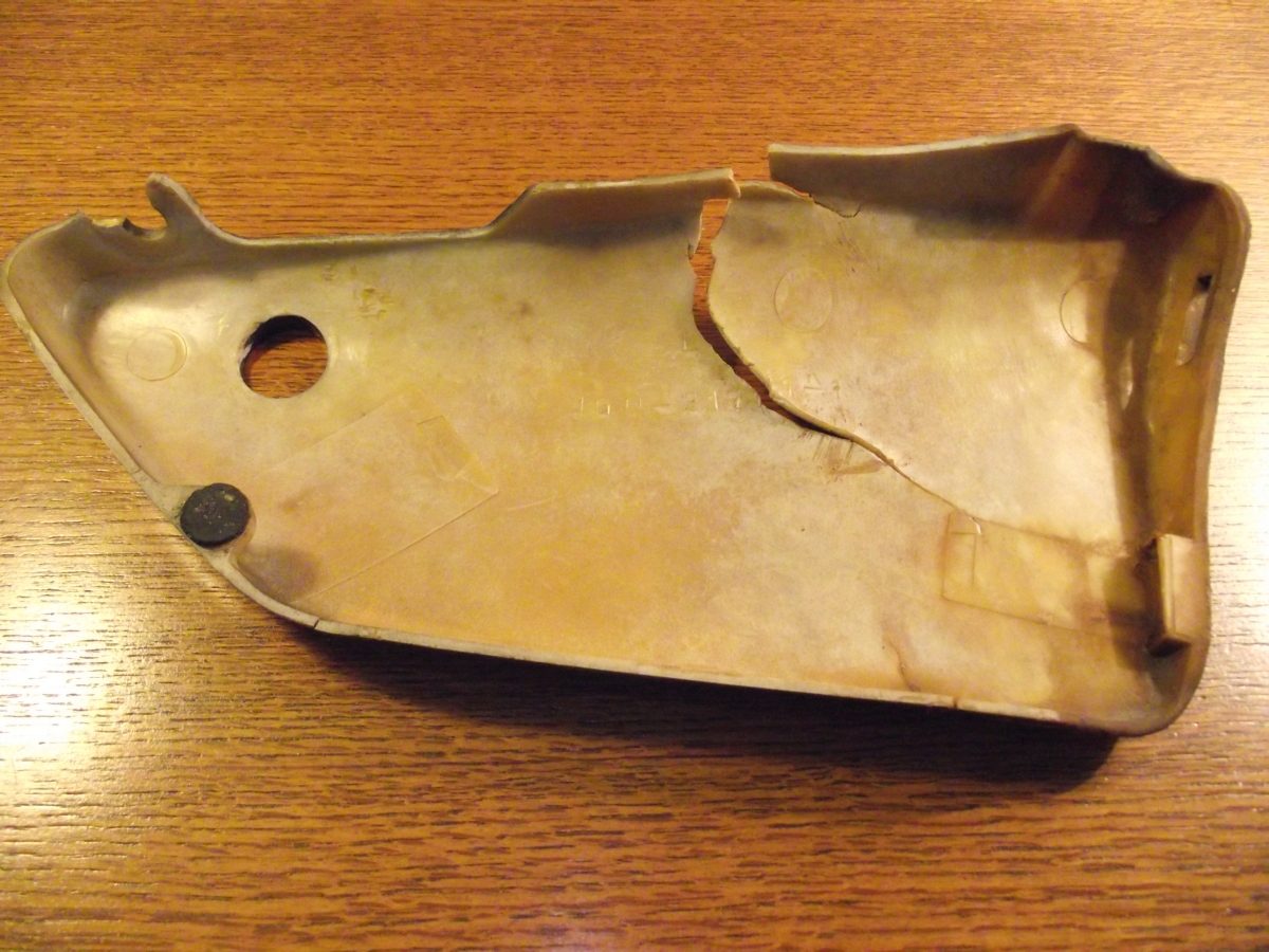

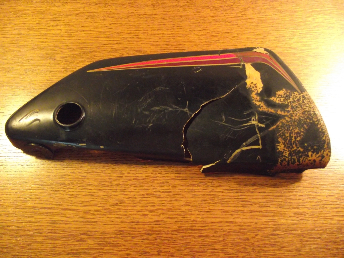

Here is what I'm going to attempt to repair. I plan on using the Permatex Plastic Weld or the Loctite Plastic Bonder (both are about $6.00) along with a fiberglass backing. I know it looks crazy to even attempt to fix this. But these panels are very rare and would cost me $100 plus to get a used replacement, $200.00 for the set. Plan on fixing this one and biting the bullet and purchasing the right panel.

I see you have an entirely different situation you're dealing with, not just a pin snapped off. Have you tried contacting an automotive paint supply store? I had a car with a broken air dam made of some weird plastic that needed repair. I went to an automotive paint supply store (Mattos) and they had a kit that included backing material and the resin stuff to repair it. They had different kits for different types of plastic. As I recall it was inexpensive. That was 18 years ago and the repair has never failed since. Ed
