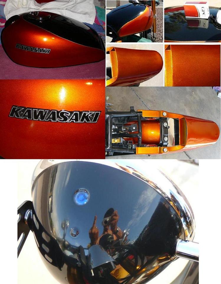

Cant speak in regards to humidity but here's what I did on plastic, tank and chromed head light shell with exceptional results. I believe Mark1122 has followed the same guide lines with beautimuss (see his tank) results.
Break down...
Paint then let fully cure (follow directions) 3-5 days.
Wet sand to remove blemishes, particles, paint dust bunnies etc...
Then clear coats (non can 2-3 part)
Let fully cure (follow directions) 24 hours.
Then wet sand again, add some clear if you chose...
Then buff out with rubbing compound!
Add wax and she'll shine just fine....
Head Light Shell Can Paint
Here's some others where I got the concept from regarding wet sand between coats...
Tank Prep - Paint
Good luck!

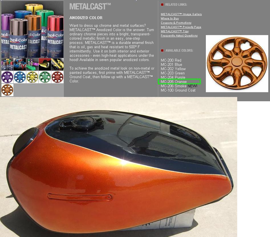

i used a combo of both on my tank. i started with the good 2 pt urethane stuff. then when i could not get the candy red to match the duplicolor red, i used the duplicolor red over the urethane black silver and clear. then i used the 2 pt urethane clear over top again.

Seriously Mark compared to what you've accomplished on that tank... Shit brother, no comparison...
Speaking of which, where's the final images of that phenominally gorgeous tank...
Unfortunately, I don't come on line as much any longer so I obviously missed it... You do a write up on it? link?
Share the knowledge mi amigo....
