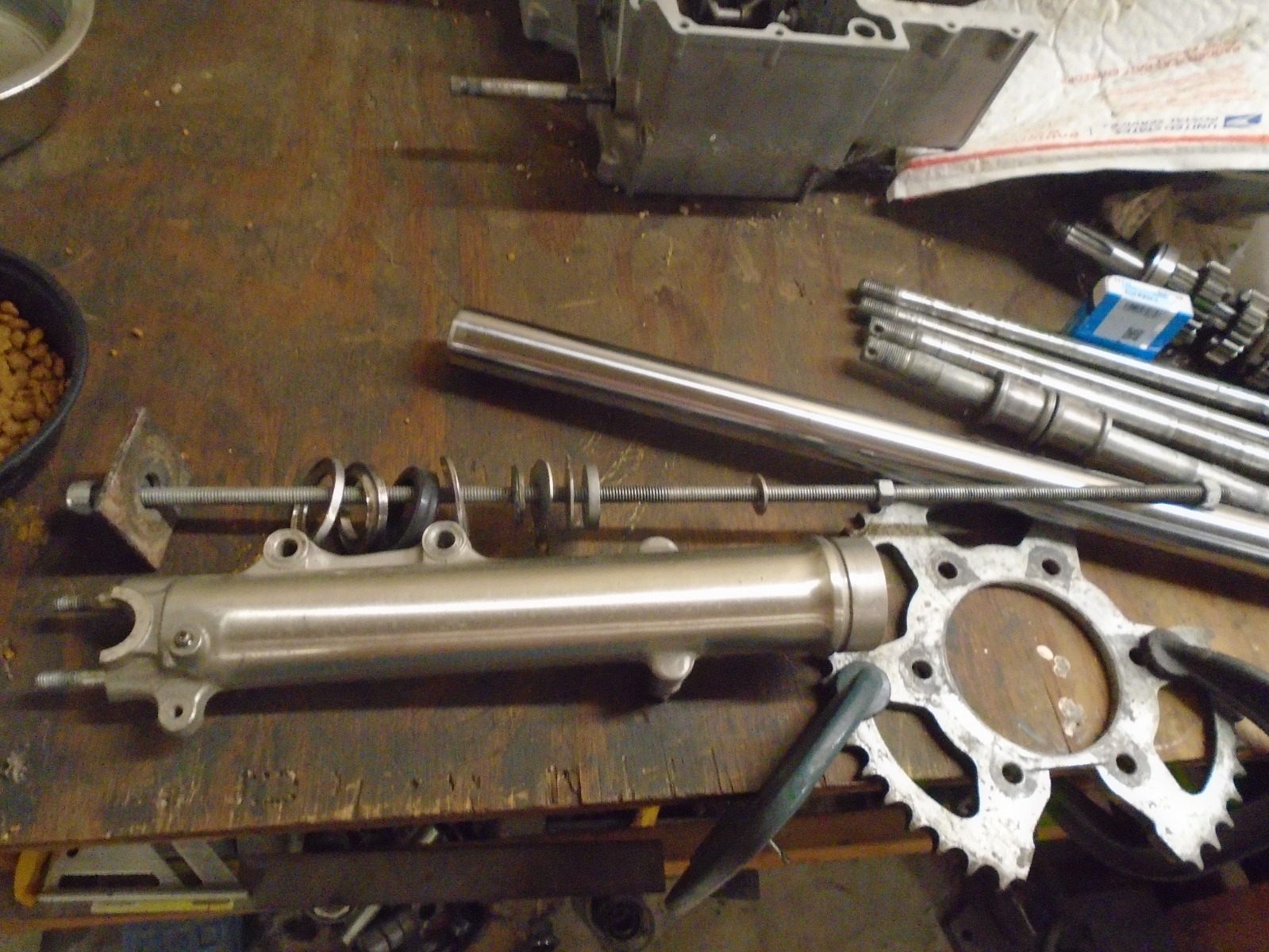

29 Sep 2026 15:28 - 29 Sep 2026 15:31The fork and bushing only, showing from top to bottom the bushing, the seal seat, and the snap ring groove
With washer in place, as the Partzilla diagram shows www.partzilla.com/catalog/kawasaki/motor...ont-fork-81-82-h1-h2
A better view of the bushing and bore. I can't tell for sure and I don't know how thick that bushing is, but I think part of its thickness is held in place by the underside of the seal seat ledge. At any rate its clearly not interfering with the washer or seal
