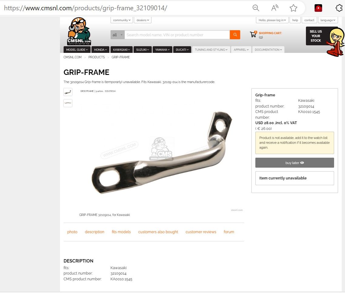

The part referenced by gd4now and shown by sdinse is the grab rail used on the Z1R's (one on each side).  They mount using the same holes used for the larger grab rail on Z1's, KZ900's, and KZ1000's, which is the single rail that goes around behind the seat.  The Z1R parts will bolt to the same mounting holes and replace the single grab rail.  I have fitted the Z1R parts to my Z1 for a different look.
The first photo by sdinse with the flange at both ends is the KZ650 part.
The KZ650 part is a straight piece and interchangeable from side to side.  The part I have shown in my first post isn't straight and wouldn't work for either side.  The confusion continues . . .

I have found what looks like an exact opposite side version of my part:
Close, but no cigar.
