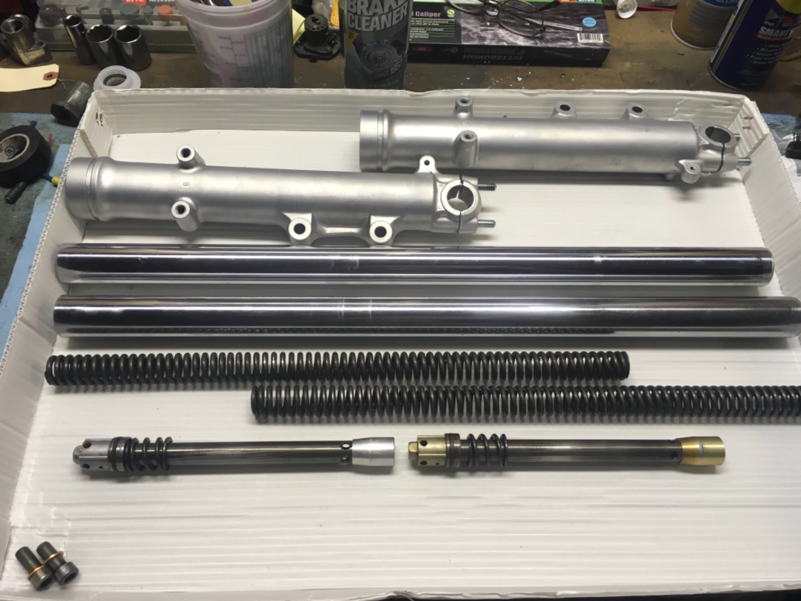

Restoring a A1 took forks apart to powder coat lowers when i took inner tubes apart to check spring discovered two different types  one with long dampener rod and long spring and one with short rod and spring it looks like 77 had short rod any information would be appreciated ito identify without taking apart large swap meet coming up would like to make it correct

I’ve got a set of ‘77 A1’s on the bench right now, the only difference is in the color of the dampner.  One is silver and the others is gold. Must have been something a PO did. Maybe one was damaged and they replaced it without tearing them apart and never knew they were a miss match.

Those look real nice!!

No way  guy road on street don't think he knew what he had

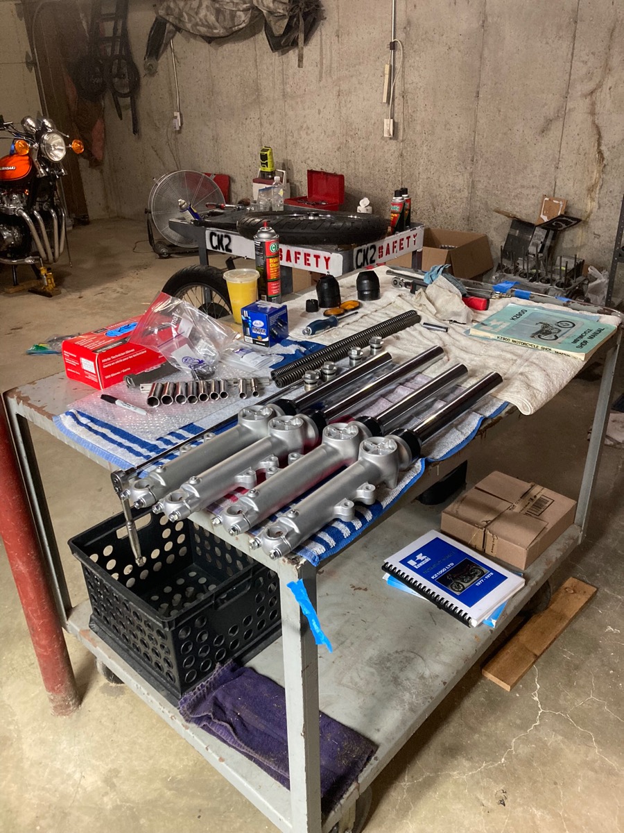

Those look real nice!!m
Fork lowers were vapor honed (blasted). Recently rebuild two set of Z1 forks for Wheelhop at our Zukey Lake get together. Same guy did/does my blasting.

Z1 forks and 77 kz forks are different ive done a couple z1 and a 78 b2 77 has short dampener rod. forks look real pain  real nice going to vapor blast covers guy i got bike from painted whole motor and cases black. Thanks
