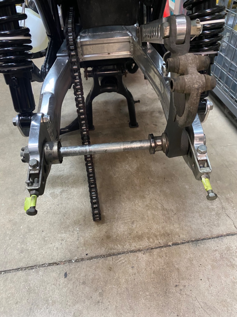

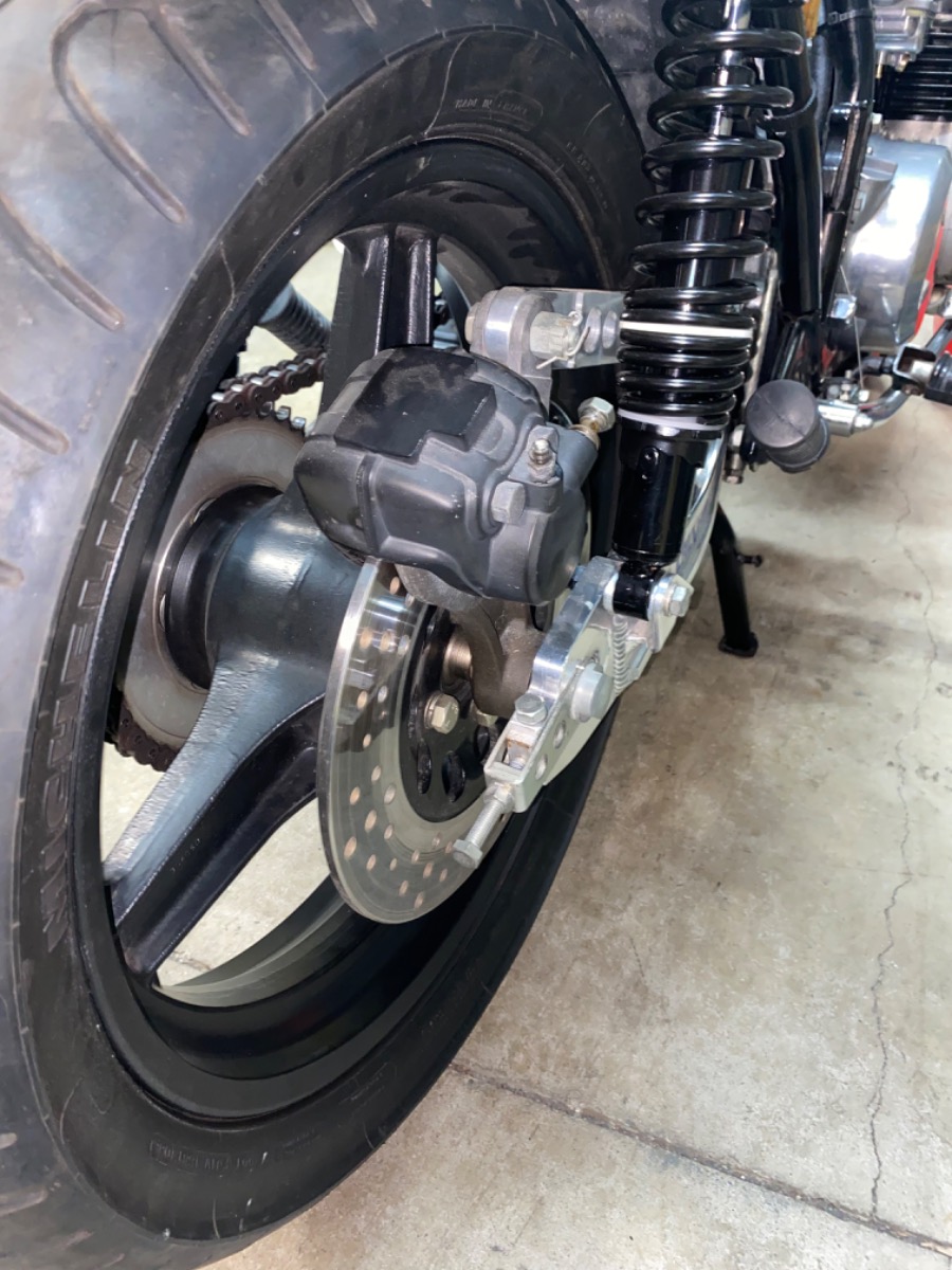

Hi everyone, the service manual I have only covers rear drum brakes. I have rear disk on my kz650. Wondering if there is a trick to removing and installing the rear caliper. Trying to slide it over the rotor and rear brake mount is very difficult, and I feel like I am damaging the rubber seals on the caliper mount holes.

You need to remove the caliper and bracket as one piece, with it off the bike then remove the pads then you can remove the caliper from the bracket.
Installing the caliper on the bracket can be trickey with those 4 rubber dust seals make sure you have new ones on hand and don't get any grease on the inside of the dust seals it's a tight fit and if I remember correctly the caliper will only go on the bracket in one direction and the bracket needs to be off the bike when reinstalling the caliper back on the bracket.

Yeah I didn’t remove the mounting bracket. I got the caliper off somehow though. Here is where I am at. I don’t really see how the bracket being off the bike will be different, the part I’m having trouble clearing is those dust boots. Maybe I need to coat them with a little grease so the caliper slides over easier.

30 Apr 2023 08:08 - 30 Apr 2023 08:11Yeah I didn’t remove the mounting bracket. I got the caliper off somehow though. Here is where I am at. I don’t really see how the bracket being off the bike will be different, the part I’m having trouble clearing is those dust boots. Maybe I need to coat them with a little grease so the caliper slides over easier.
With the mounting bracket off the bike you will be able to see the dust seals go into place, it's very easy to tear the dust seals when installing the caliper on the bracket or they fall off before going into place and you won't be able to see it. It's no big deal to remove the bracket your almost there. Their isn't much holding the dust seals on the bracket and it can be frustrating trying to get the caliper on the bracket even with the bracket off the bike. You can try it your way you might get lucky but good luck.
Also if you use grease you need to use brake grease and use it sparingly and grease the caliper bolts to.

Moose1800 has the correct advice. Pull the axle and remove the bracket. Assemble the caliper and install as a unit.
