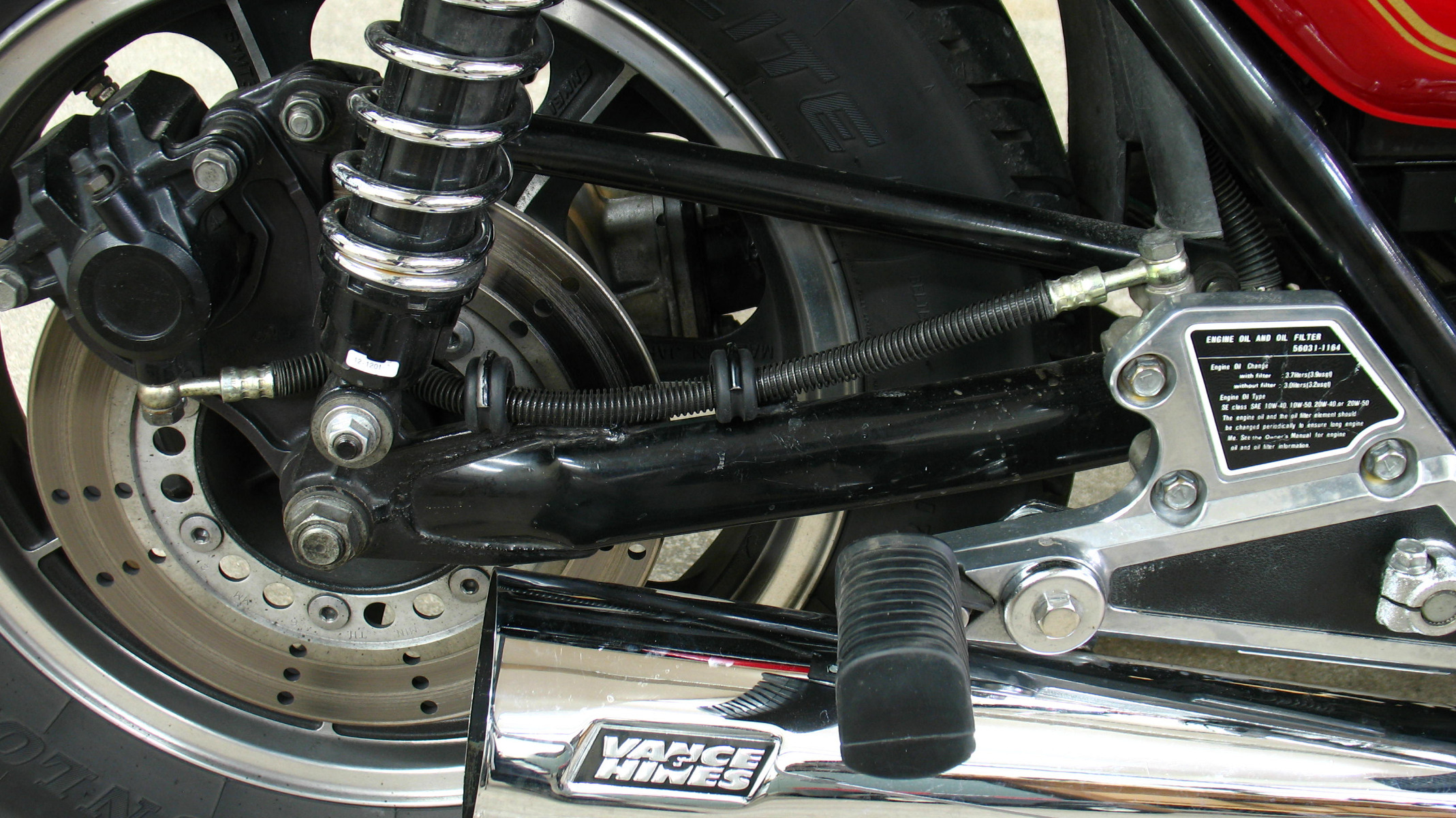

My KZ1100A2 has had Progressive 12-1201B shocks with 03-1368C springs since 2014.
Got the lower profile I wanted with that shock. IMO it provides adequate support for 210+ lbs. of me, plus my lady and a loaded Tourmaster bag when riding over smooth pavement.

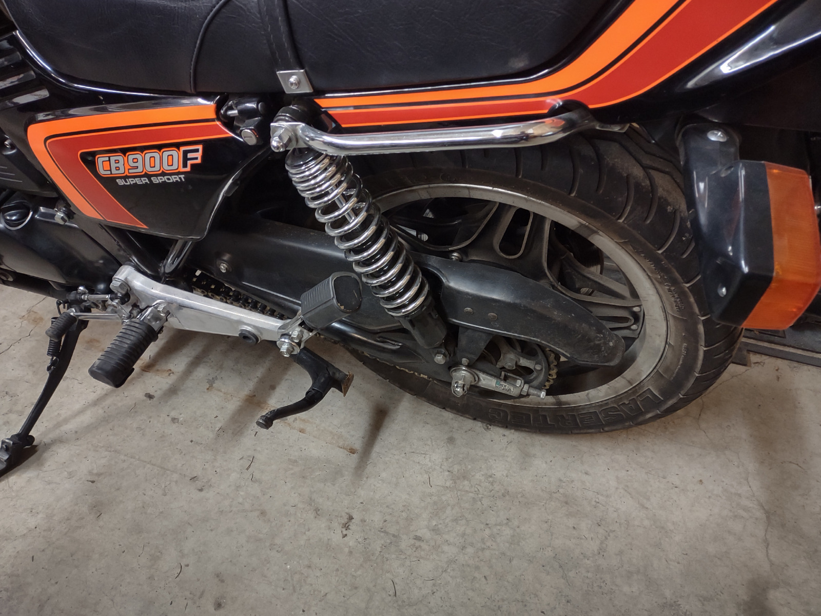

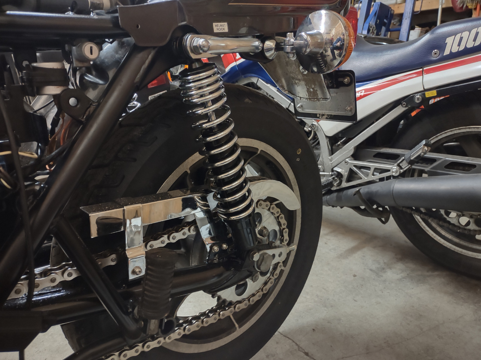

We just put a set of series 12 shocks on the 77' KZ 1000LTD, the stock shocks were way too strong for me. We have a set on the 82' CB 900F and they worked out great. Both sets have the 90/130 springs.

Well isn't that kind of puzzling eh? Same springs and only feels right on the Honda. I mean I totally get they are different bikes and can't compare an apple to an orange but 90/130 is the 2nd softest spring you could go with. The spec chart says there is a 75/120 but you would think 90/130 would be kinda soft? Then again not sure how much you weigh or how plush the stock springs were on the LTDs but must have been fairly soft? I wish Kawi had put their spring rate in their specs so we could cross ref. They had to know as the Kawi manual has the specs for travel and size. Maybe they keep that info with their "paint codes" locked in a cave somewhere? Anyways appreciate getting your perspective with what you went with, can I ask what you weigh? Might be a factor I can use in narrowing down my choice as I am 185-190 other than around Christmas when I don't want to know what I am.

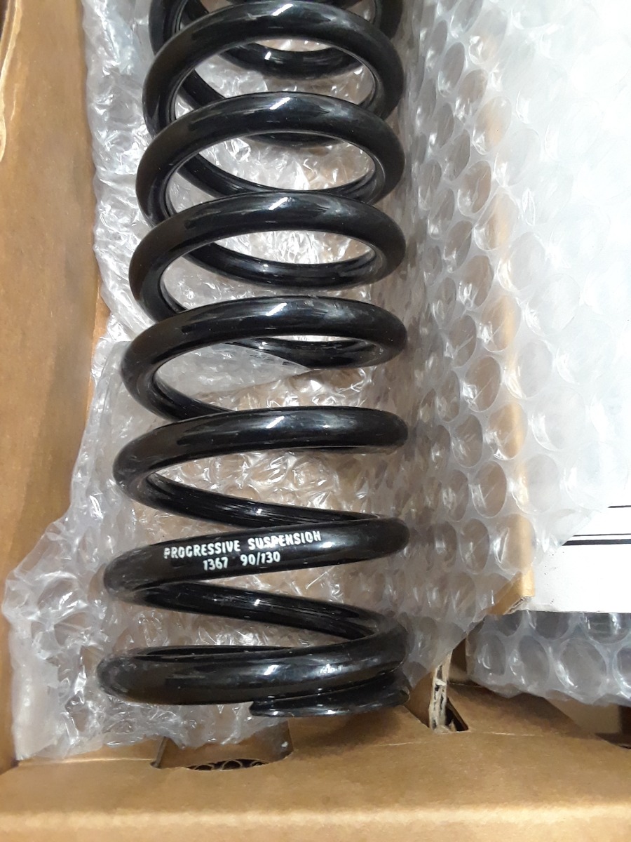

The stock LTD shocks were too stiff even with the preload backed off all the way, not the new series 12 shocks.
I only weigh 125lbs but my friend is more like 250lbs and with the series 12 shocks set at the 3rd preload setting either one can ride it comfortably.
You'll be happy with the 90/130 springs on the series 12 shocks.

Steve, I have a spare set of black 90/130 Progressive shock springs.
Email address is in my profile.
