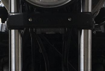

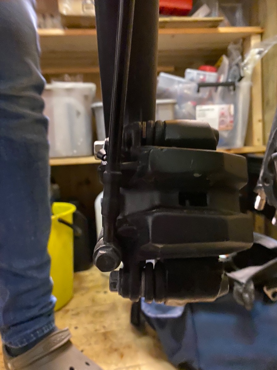

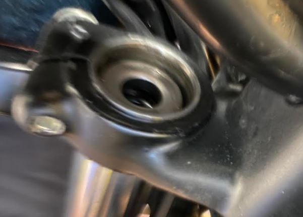

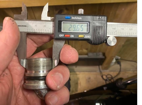

I took of the cap today for measure the Ø on the spacer, if you take a look on the photo below you can see that the progressive spring is quite heigh and the cap is pushing it some down today, guess I will be able to push 20-30mm exstra.
It is 5,6mm up from the washer to the top of the work (no weight on the front suspension).

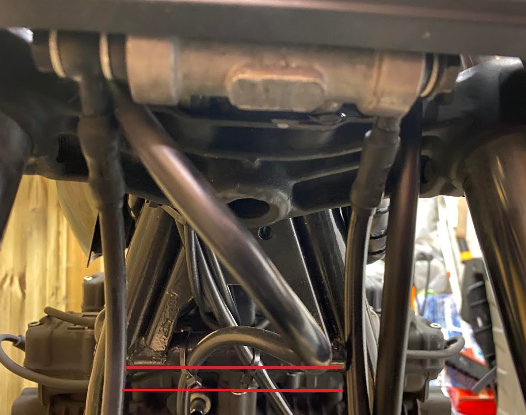

I also added some more photos of the brake lines, they goes straight down from the trippel three.

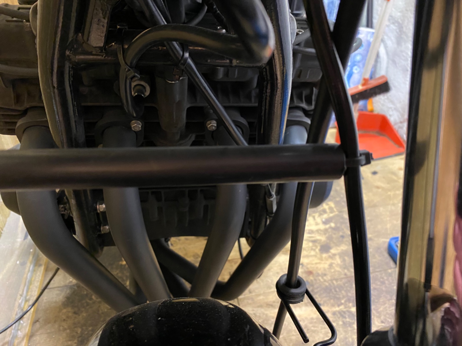

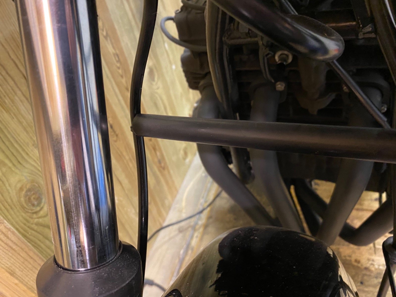

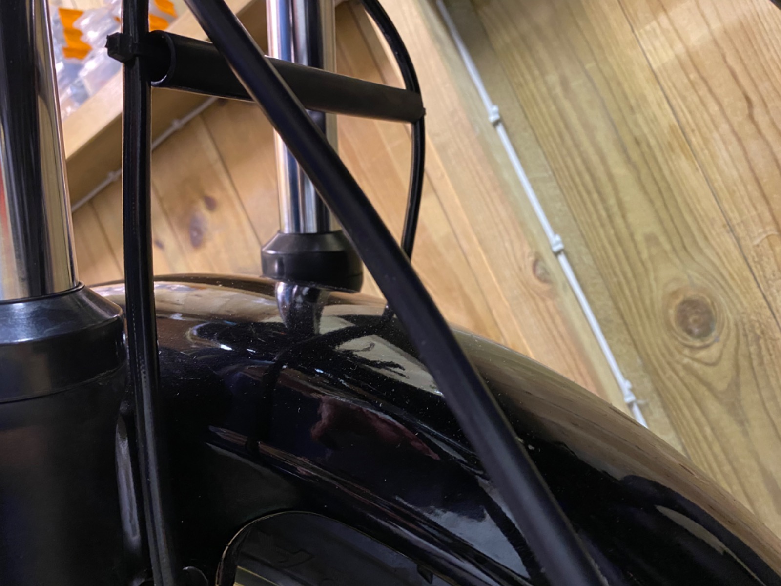

I guess the main problem is that the lines goes stright down and not have a angle as some off you have comment.
I came up with a idea today, what if I use a stiff pipe to push the line away from each other and have a plastic cable strip?
Something like these... ?
Bitspower None Chamfer Brass Hard Tubing 14mm AD, 500mm - Black 4712914782717 | eBay

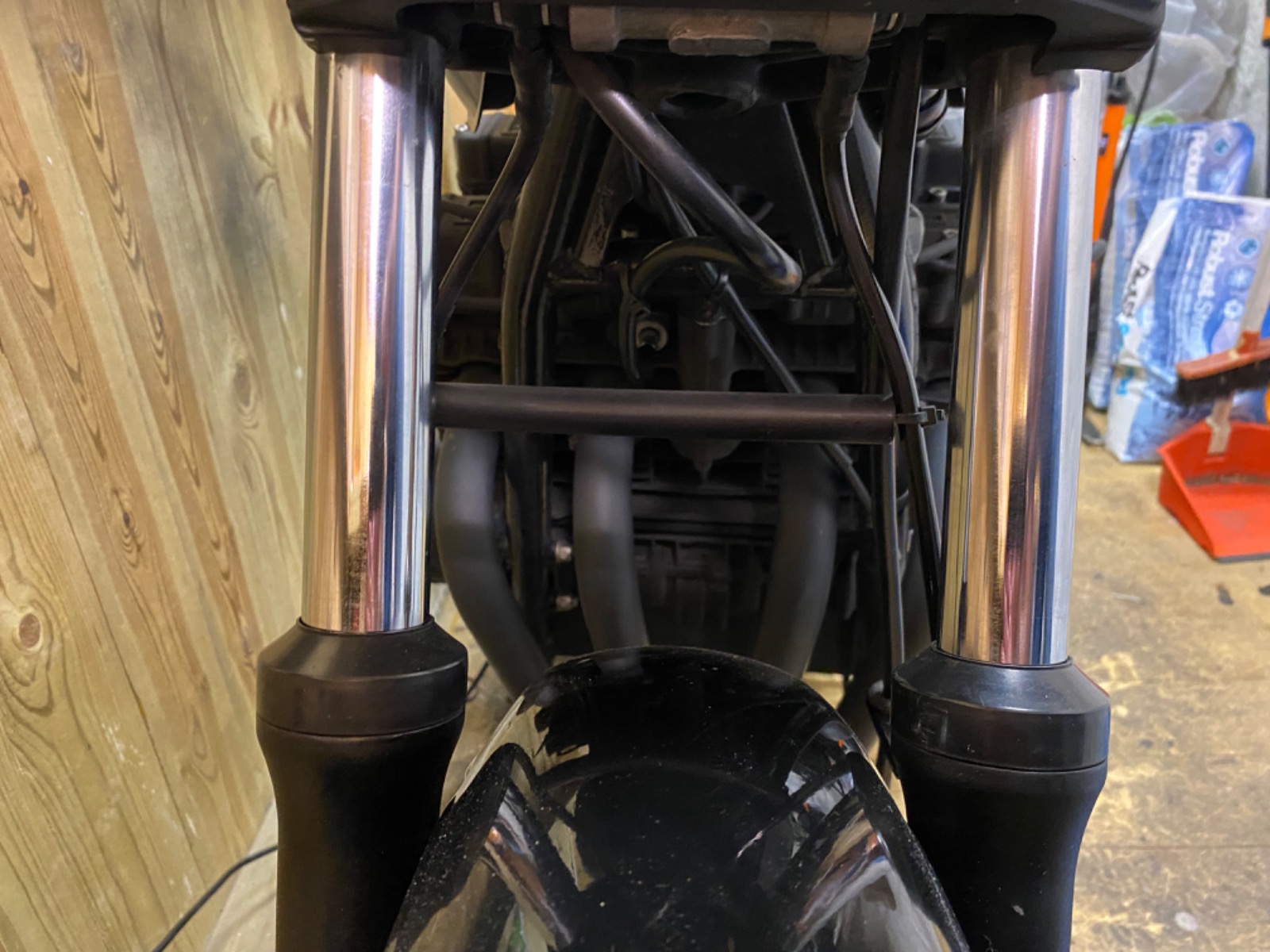

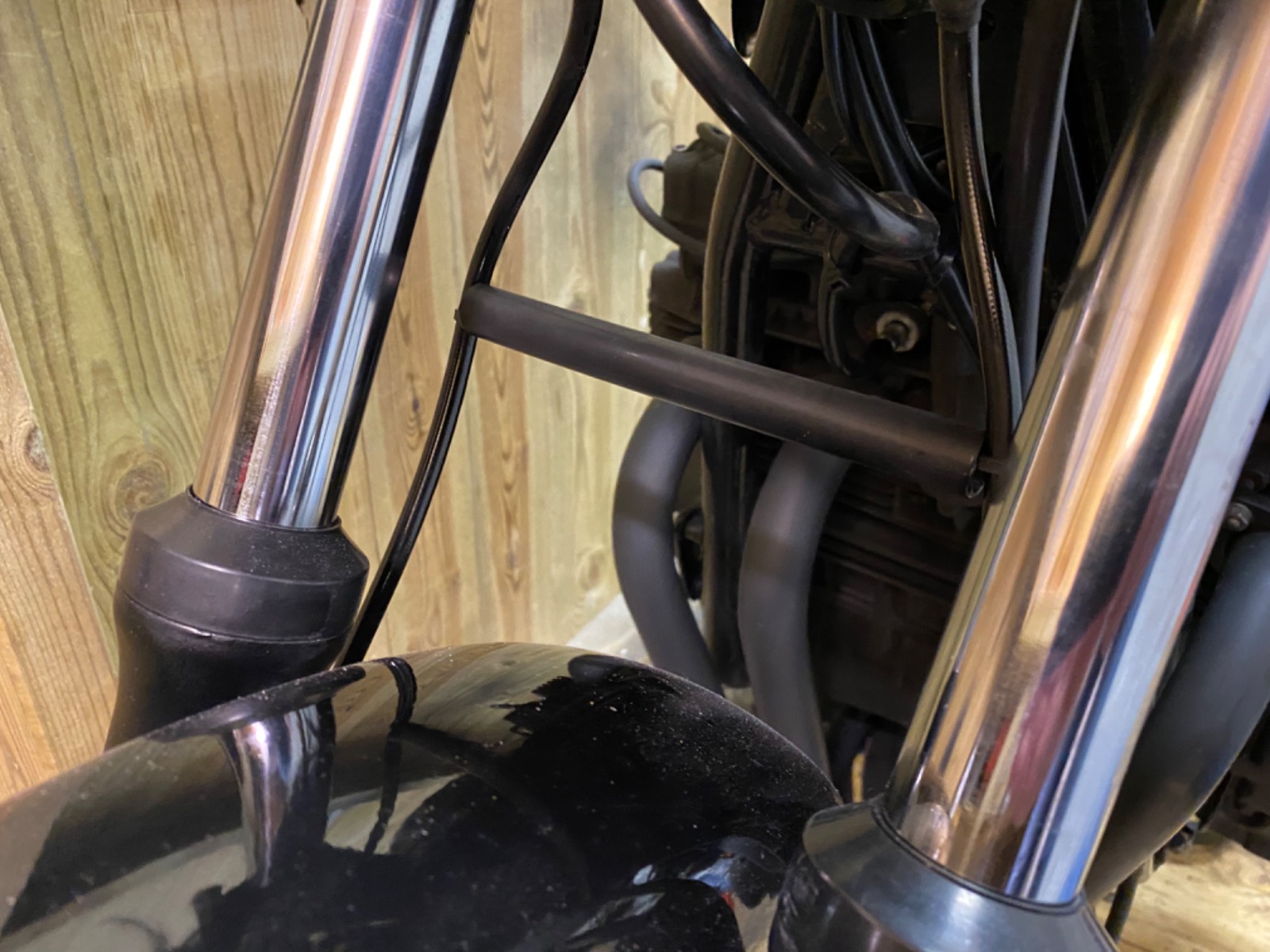

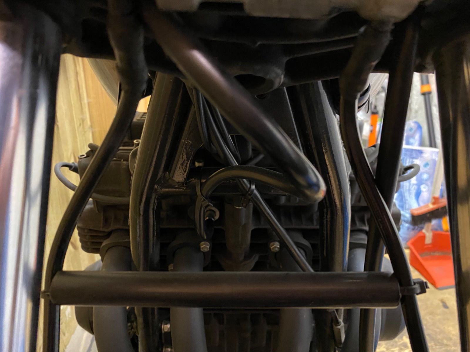

Re: Brake lines touch front fender
26 Mar 2023 10:03 - 26 Mar 2023 10:03
Project:
Project:
Last edit: 26 Mar 2023 10:03 by gordone.
- Posts: 5058
- Thanks: 2269
26 Mar 2023 11:38
Clever idea
Questions How does it work thru out the total fork travel ?
Will it slide up or down the brake lines from road vibrations ,bumps , or wind evenly and or unevenly and foul you up ?
Dave,
Dave,
- gordone
- Posts: 1533
- Thanks: 93
26 Mar 2023 11:42
Good points, will check the travel length when I get the bike out and maybe adjust, but I think it’s heigh enougf.
vibration should not be a problem, its rock solid strapped to the lines.
