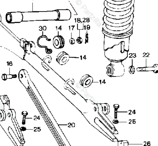

Yes, the originals pipes are usual made from thick rubber, the Hels have a much thinner diameter - pretty much like all braided lines.
Are the grommets you refer to like the ones in the picture below.
If so, I would order them as they will fit the metal attachment hooks. You then need to add something around the Hel line to hold it snug within the grommet - you could try putting a bit of fuel line around to take up the slack and gluing it in place or try to source grommets with a smaller inner diameter.
It might not be strictly necessary but at least it might stop the line rattling around.

@woodyvale -- yes the #14 grommets is what I'm referring to. Since HEL sells the grommets are part of the new brake like I would assume they would already fit correctly, the only question is whether those new grommets fit inside the stock wire hook.

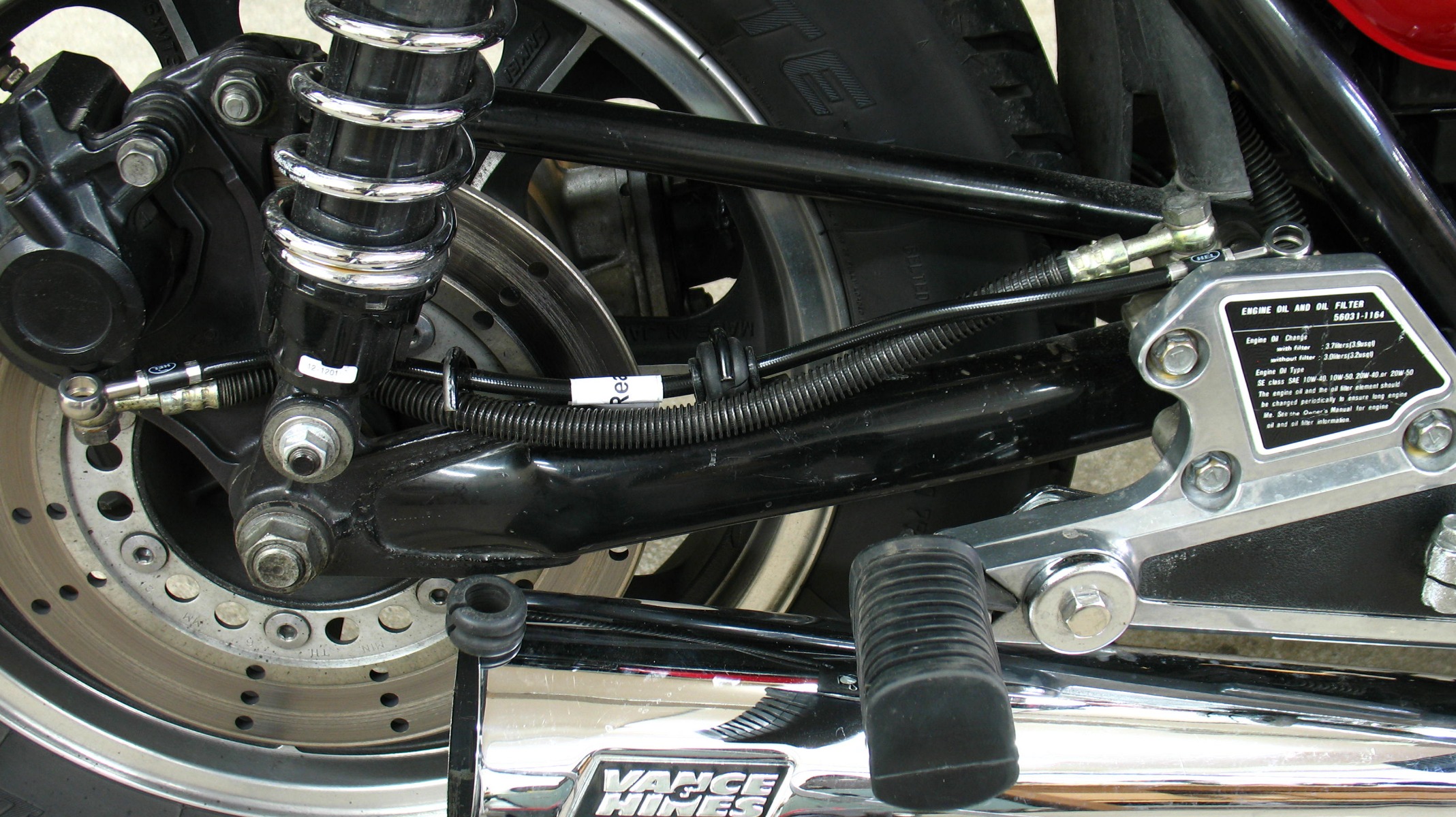

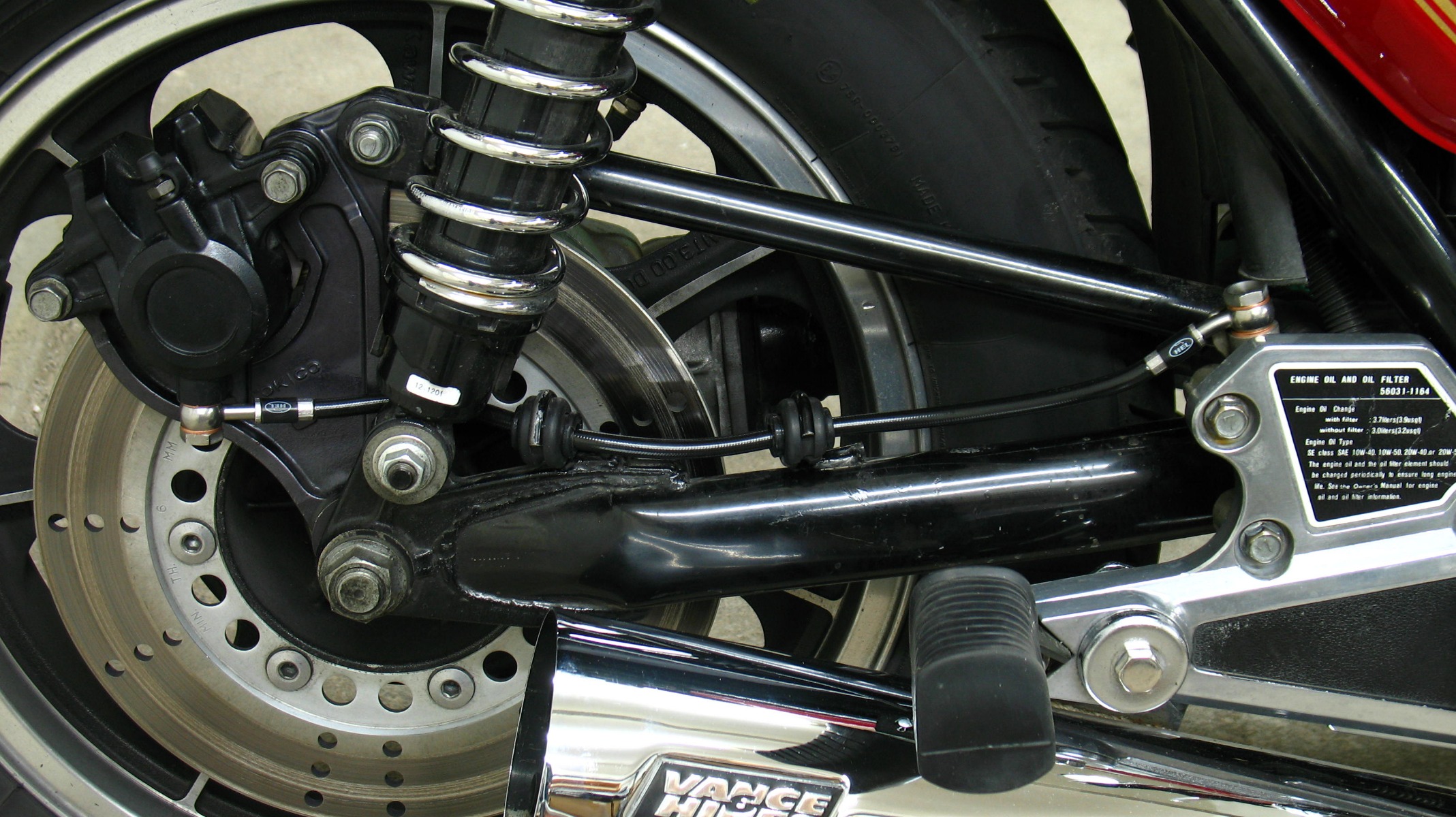

Ordered a complete HEL set for my KZ1100 in 2016. My bike's swingarm has two grommets/holders. HEL supplied one grommet insert instead of two, and made the line an inch too long besides...
When made aware of the issues, HEL without hesitation fixed the length and added the second grommet insert on the brake line before crimping on the new end. The grommet insert fits snugly inside the oem grommet, and has enlarged ends that lock it in place.
HEL contact information as printed on my warranty brochure below:

Oh interesting, I see what you did with the grommets there. I wouldn't have thought of doing it that way! And judging by your picture, it looks like the OEM grommets are actually split? I didn't remember that being the case, but it's been a few years since I built my bike.
I also see you got one angled banjo just like I was planning to do, nice to see it actually fits as well as I hoped.
