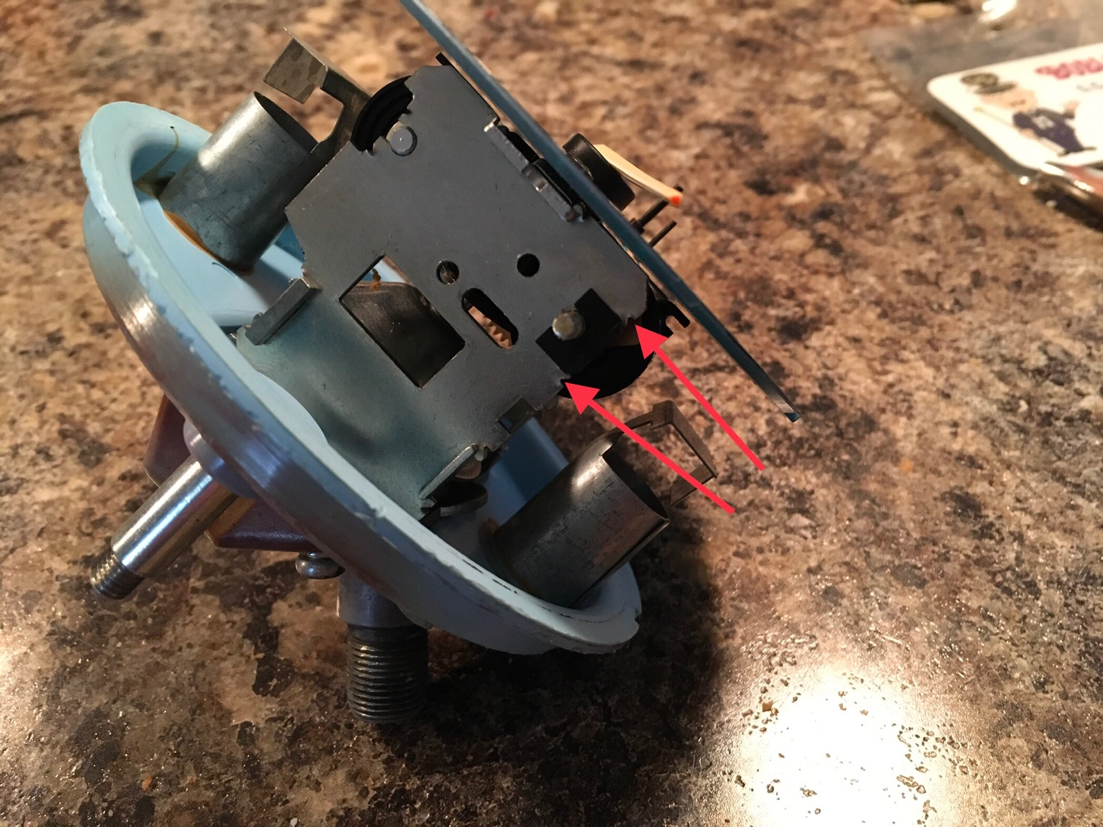

23 Oct 2021 11:17 - 23 Oct 2021 11:17Nessism is correct. I have my 750 gauges apart to freshen them up. Unless your experienced here just live with the ODM reading. You can destroy a good gauge because of a want. See red arrows of stakes that need to be releases to access the ODM spindle.A small screwdriver can be used to carefully pry off the metal band holding the speedo housing together. Work slow and bend a little at a time working around the housing. Once the speedo is apart it is possible to reset the mileage, although I can't describe the exact process. I think you have to further take apart the speedo by loosening staked tabs holding on the odometer spindle. Once those are loose the odometer can be removed and the mileage reset.

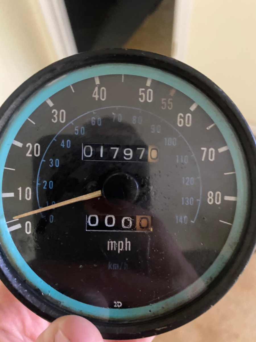

Unfortunately it is not left hand thread. Believe me I wish it was. I attached a set of code grips to the rod on the other side of the gauge housing, then twisted the knob as hard as I could in both directions. It would spin and spin with no avail. Regardless I have achieved what I originally set out to achieve, my mileage now reads 1800 miles. I’ll toss a picture at the end. Now to wait for my LED lights from SuperbrightLEDs to come in and I’ll clean the inside of the glass and button everything back up.

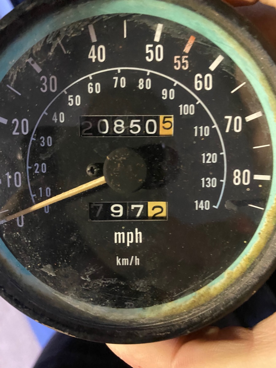

after cleaning
before cleaning and mileage adjustment
after cleaning
