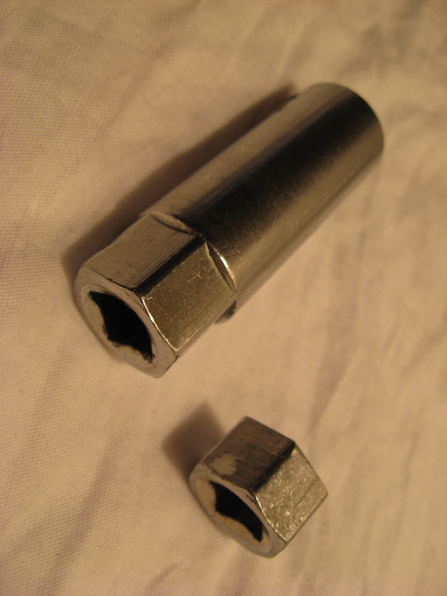

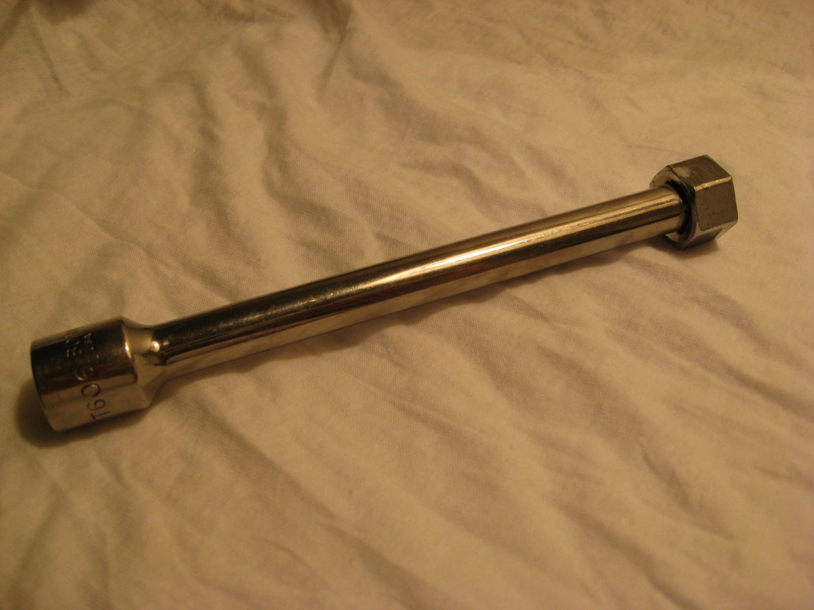

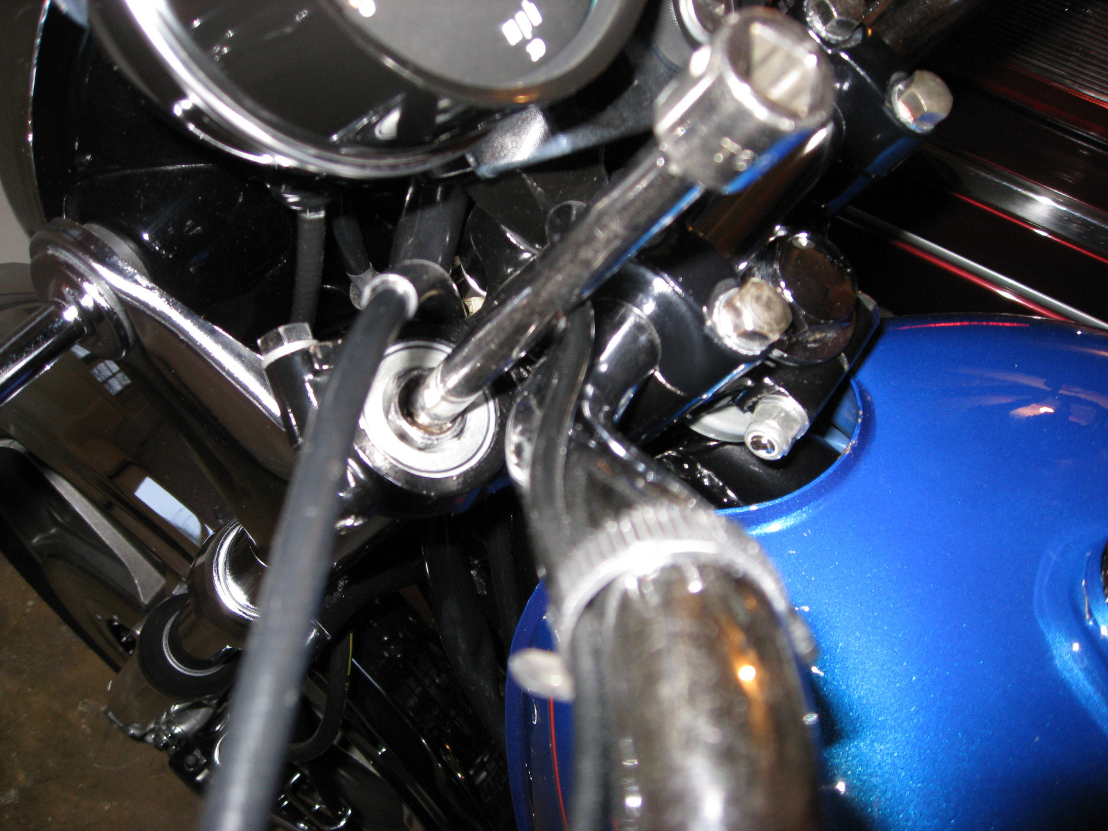

The cap will come out, but be sure to loosen the top fork bolt first or it will apply pressure to the top of the fork and the bolt. Here's what I used to remove mine when I rebuilt the forks. Ed

That fork cap tool is neat. even though I'm not sure what I'm looking at. hee. Is the nut welded to the extension? or just jammed in.

I drilled a rod-size hole through the handle, put the long rod through it, drilled a small hole through the handle and long rod, and then put a steel pin through the handle and rod to keep the rod in place. I guess I had a lot of time with not much to do. :laugh: Ed

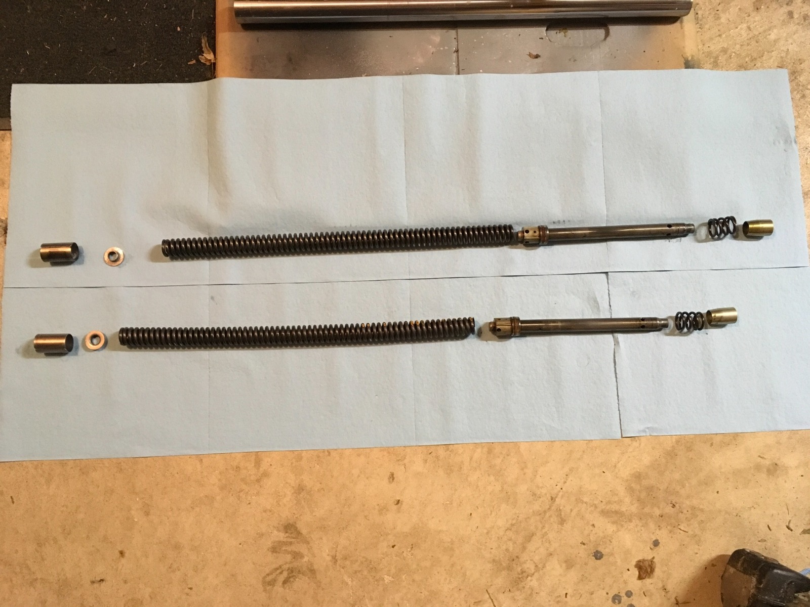

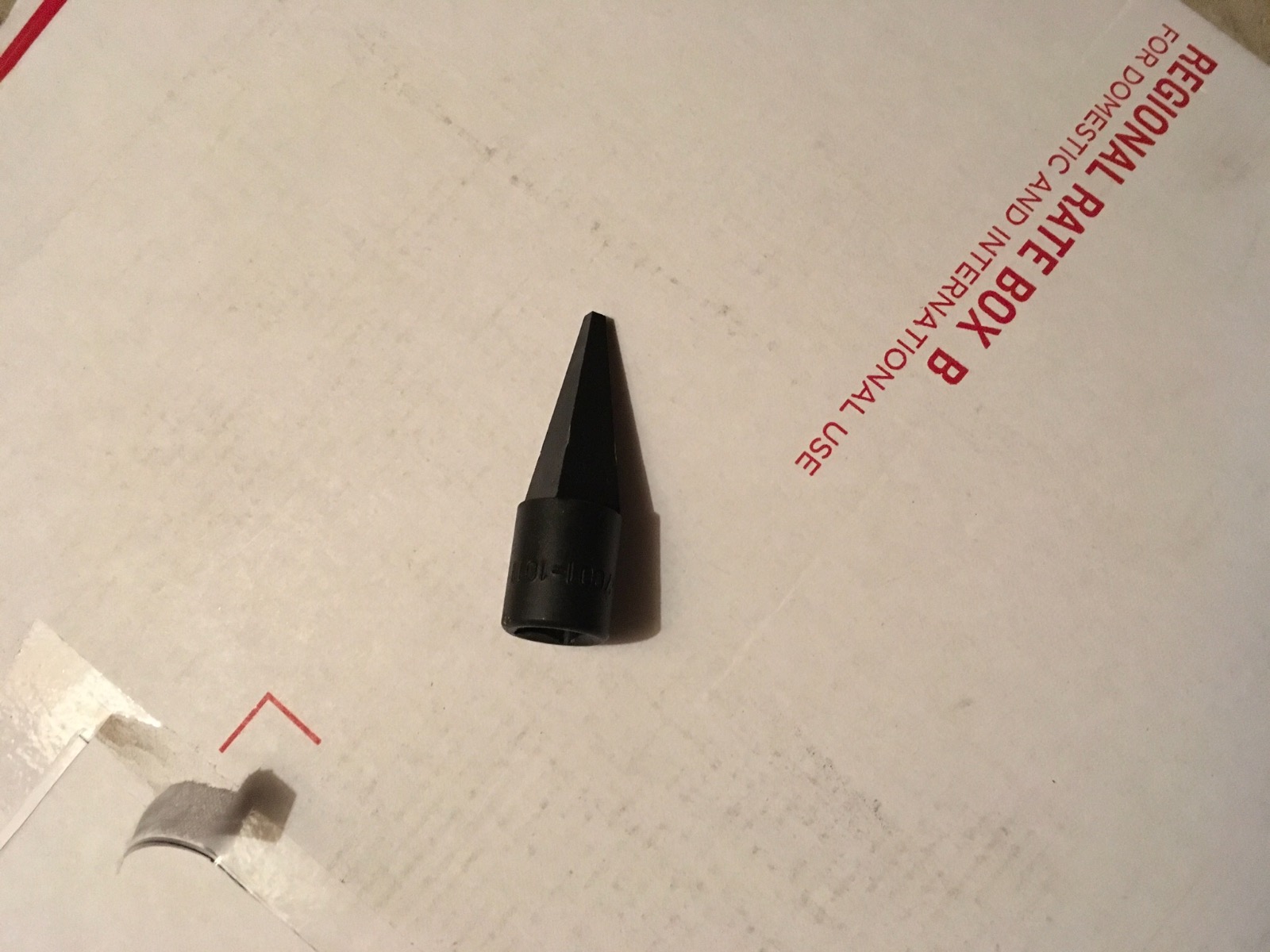

Like 650ed loosen the top yoke clamp. Leave it in the yokes with the lower pinch bolt still tight. Should come out. Put pressure on the ratchet pushing down as you get to the last few threads or the cap could strip out the Last few threads because of spring pressure. Front wheel must be supported off the ground or the bike front end could drop once the spring is released.

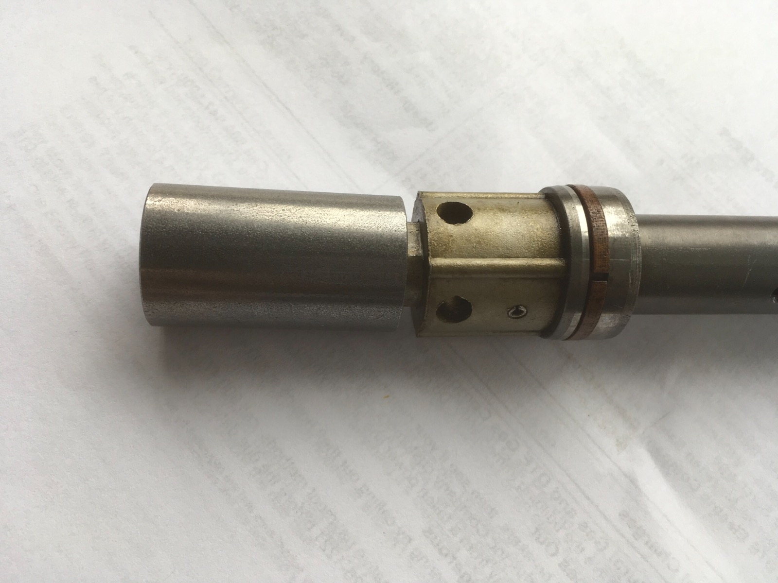

Aslo as mentioned used an impact gun on the damper (Allen) bolt before releasing the spring, not 100% its gonna work but worth a try. Here’s everything inside. They are pretty simple to rebuild.

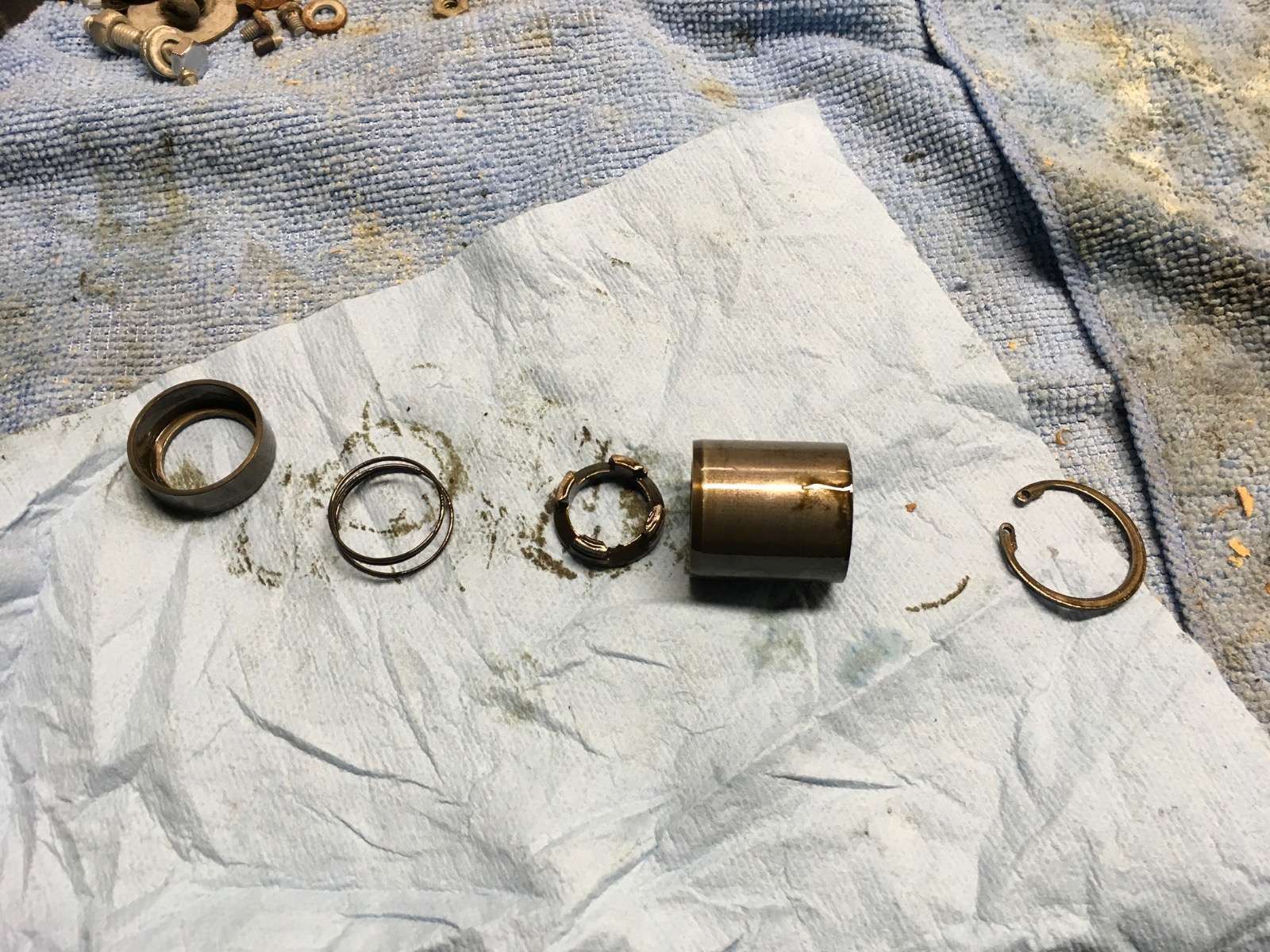

Not sure if yours will have these but the are inside the fork tube at the bottom held in by an internal snap ring.
If you try the rubber tip 650ed recommended and it doesn’t work here is the Kawasaki tool.

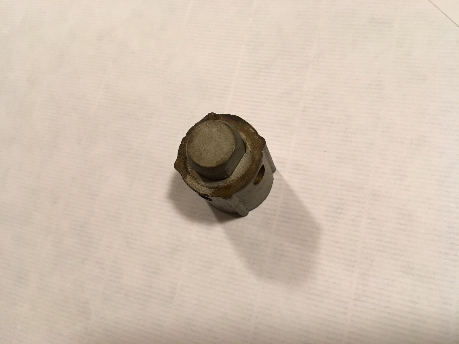

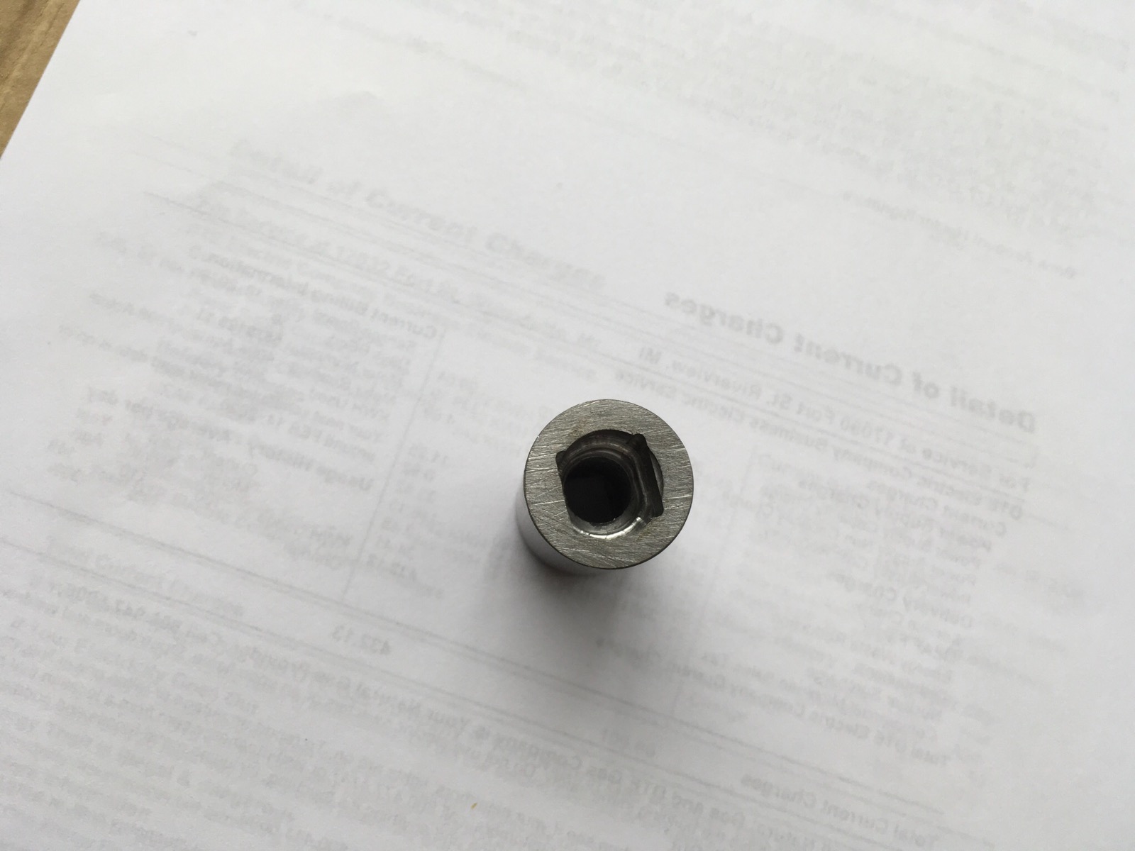

If you look inside and see this.
HardRockMiner found a place that’s now selling a tool for it. I had a machine shop make me one.
