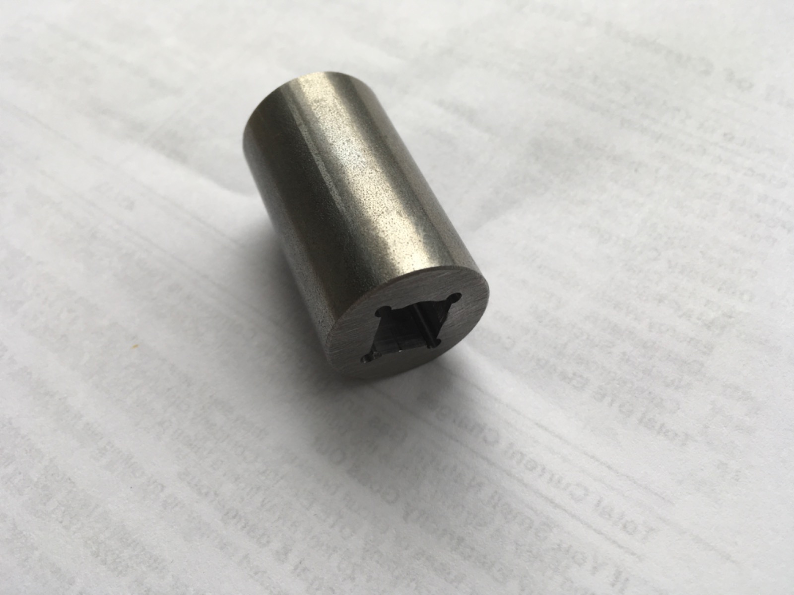

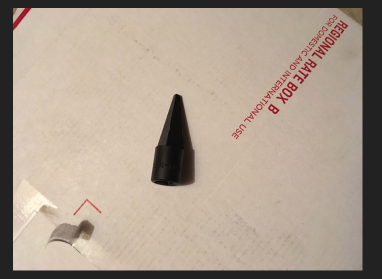

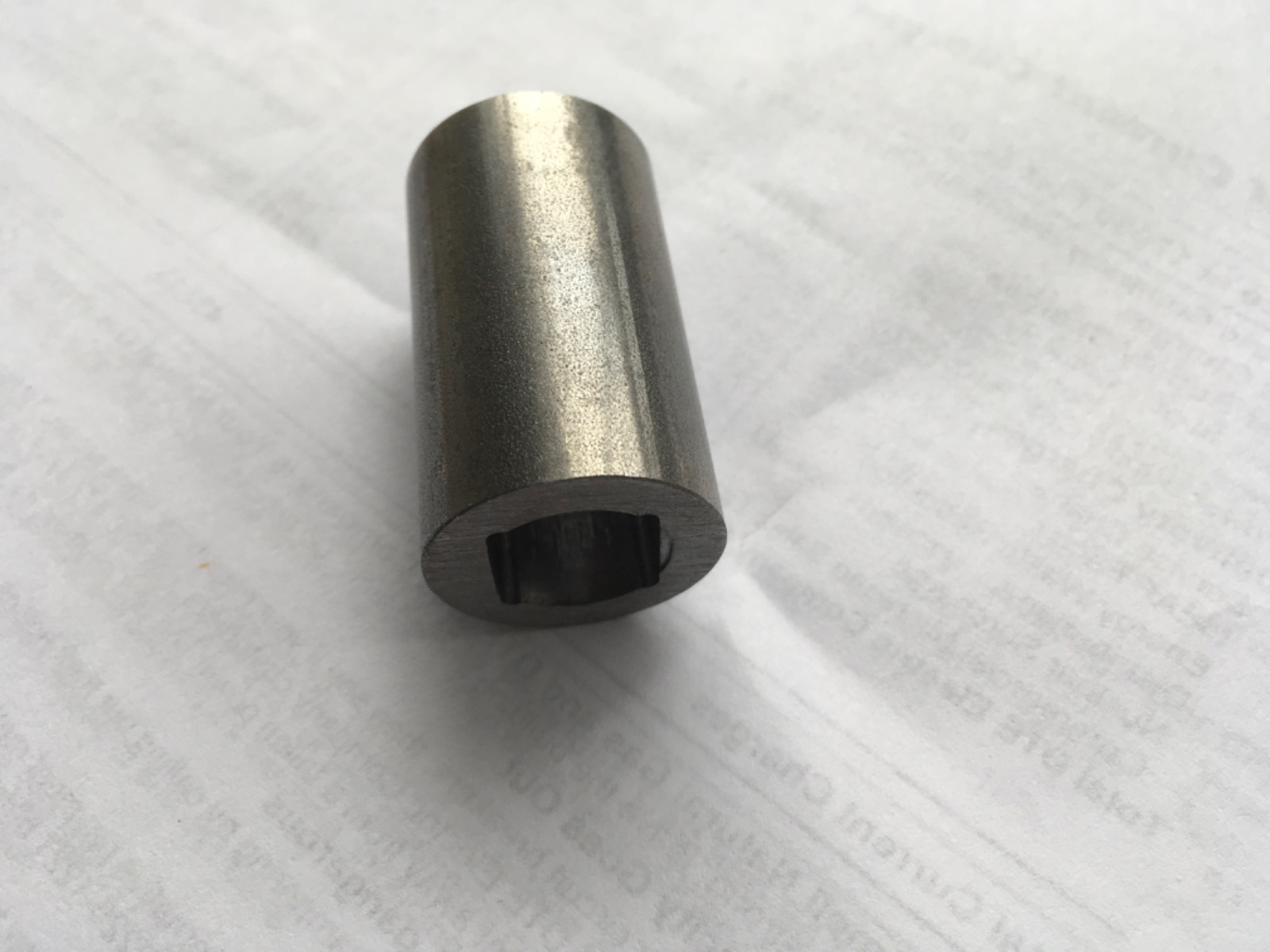

do you happen to have any pics of that tool you  made
I have a stubborn one Im trying to disassemble (77 KZ1000A front fork tube)
Thanks Mike

Mike. I can ship these to you. Promise to send them bacl
