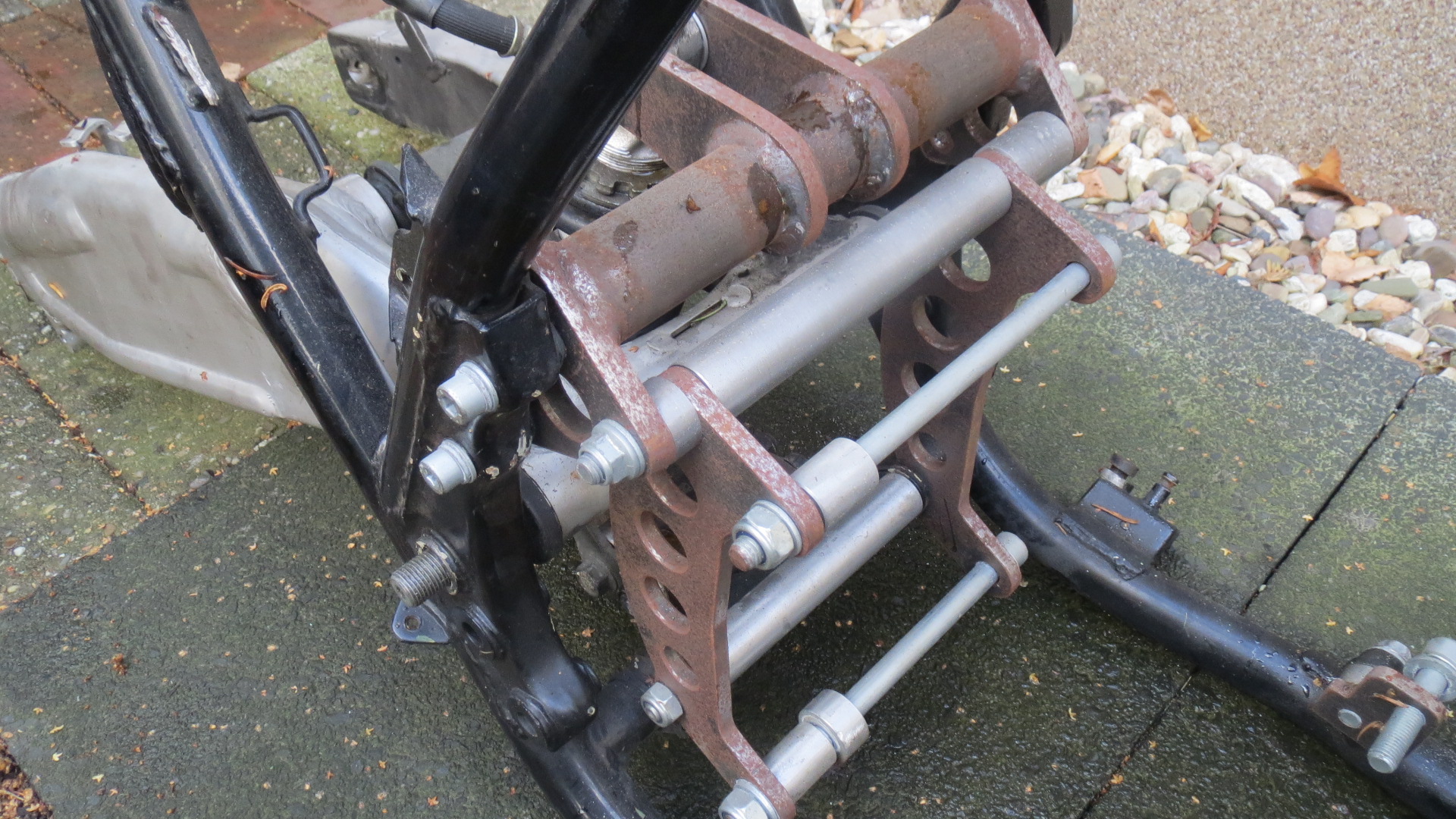

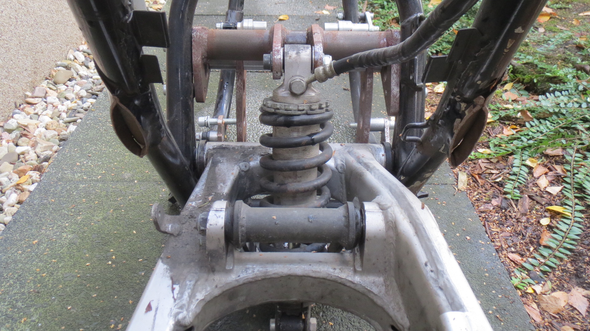

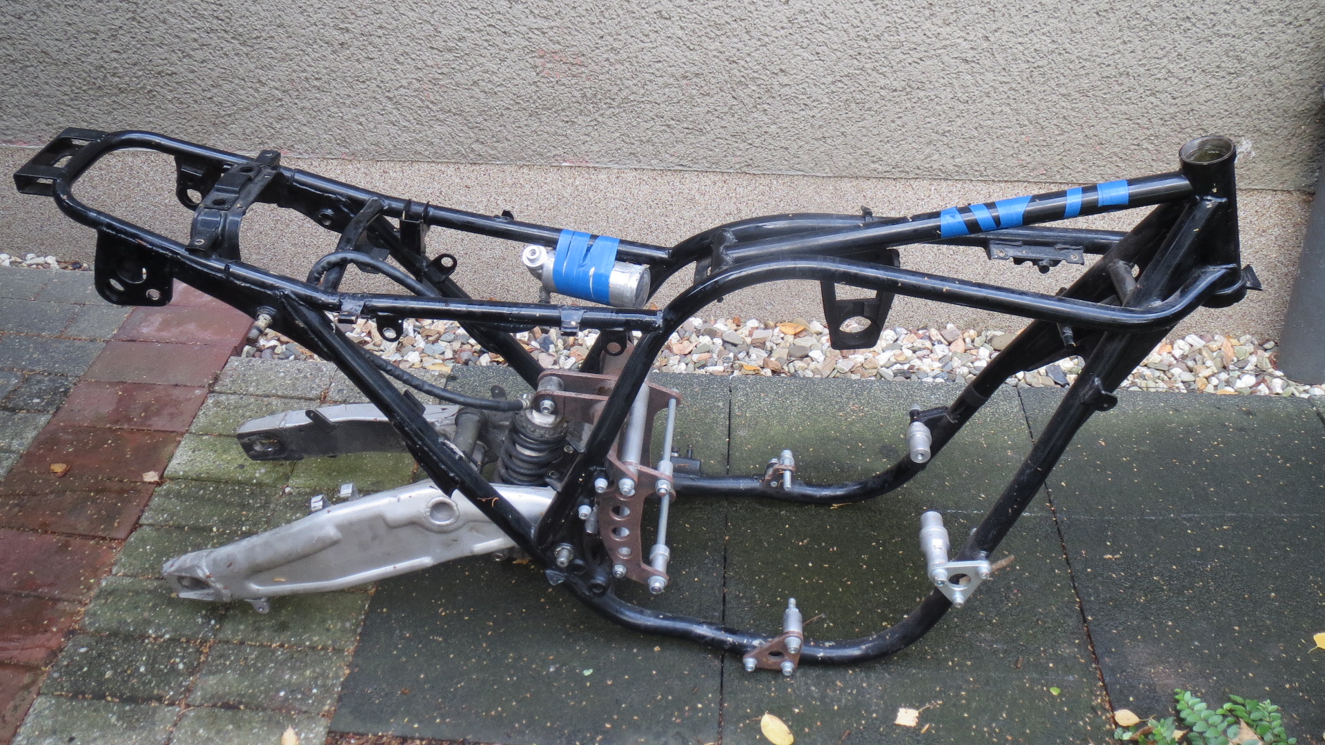

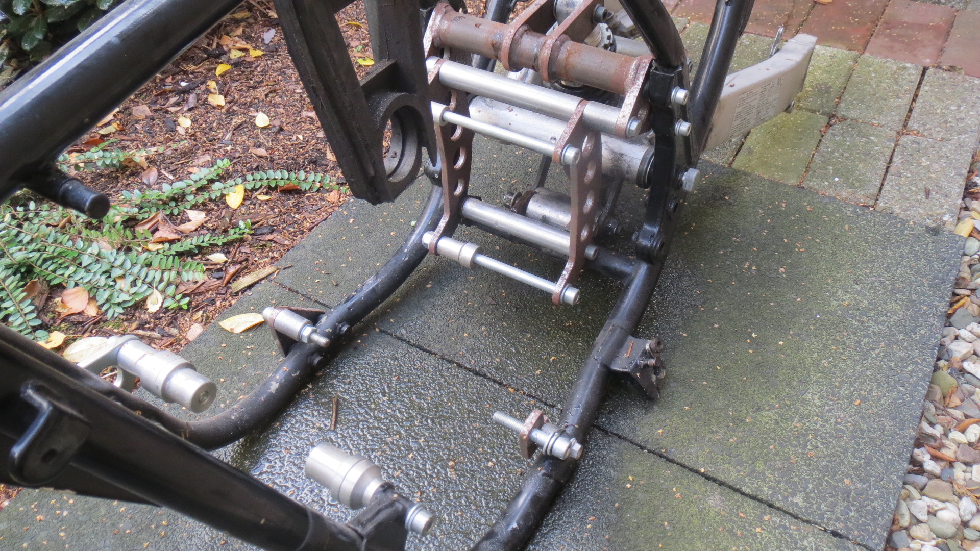

This will be my bolt on mono shock conversion for the next winter. ( GSXR engine swap? )
  • Shame
  • Shame's Avatar Topic Author
  • Posts: 3
  • Thanks: 1
Re: Mono shock and fork conversions
20 Aug 2020 14:10
#833343
That is a nice adapter kit, It does seem that there is something add to help with that torsional load whenever this type of offset tab is used. whether its a lower gusset like the older GSXR or as in this adapter featured below. This adapter looks close to what I had done, With exception of thicker shock tabs but it also seems to me that the torsional load is being transferred forward and back down to the frame by way of the motor mounts plates. Correct me if I'm wrong... PS,I bit those speed hole add a lot of Horse power...JK.
