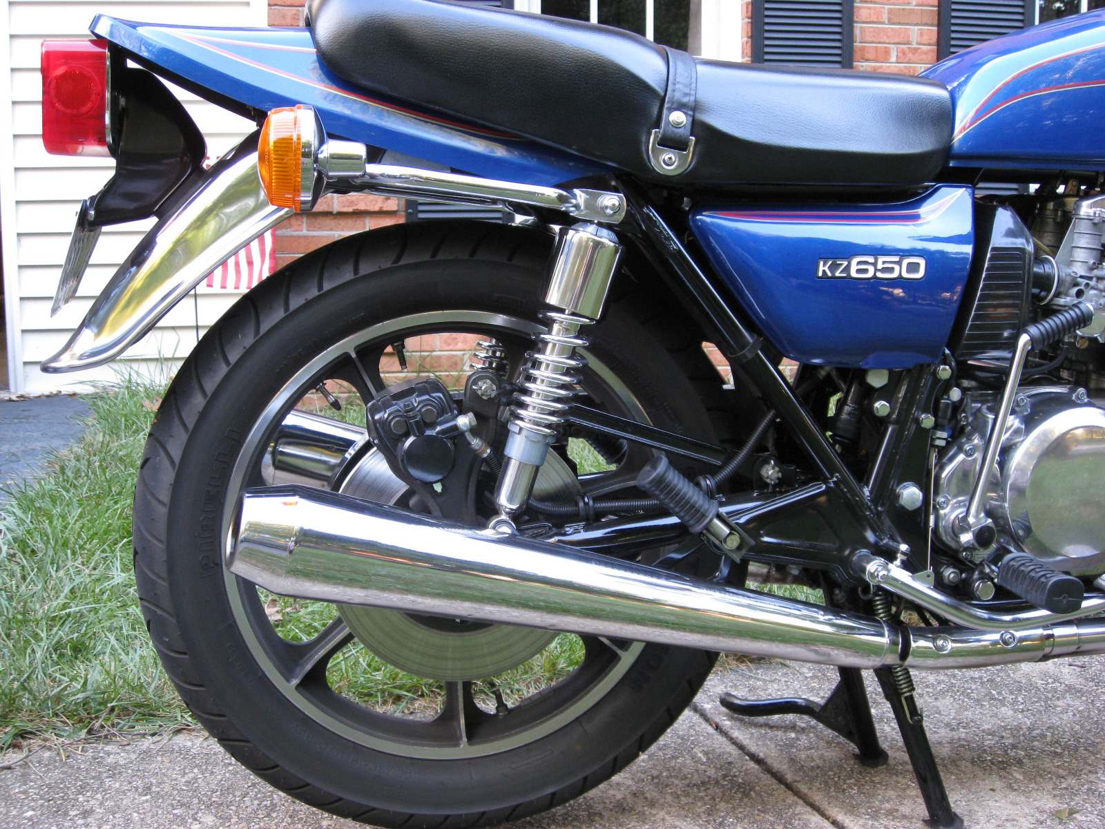

The problem your cousin had with the Hagons seems very strange to me. I put Hagon shocks on my KZ650-C1 13 years (more than 16,000 miles) ago and they still look and work like new - absolutely zero rust or other problems. The eyelets, shock bodies, and shrouds are stainless steel. The adjusters and keepers are some sort of non-ferrous alloy that contains no iron (so they cannot rust), and the springs are very heavily chrome plated. The rods are hard-chrome plated and do not rust. I don't understand how his shocks could rust if they really are Hagons. Maybe your cousin bought knockoff shocks that aren't really Hagons? If they really are Hagons they carry an unlimited mileage, 2 year guarantee, so he probably should send them back for replacements or refund. Ed
