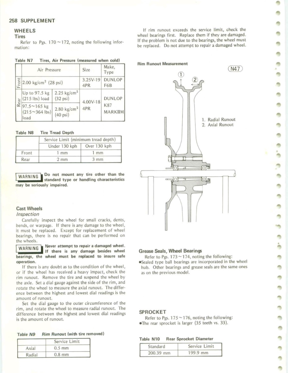

Here is all I find on front bearings. Bluej58 and 650ed have great suggestions also. Hope we armed you with enough info to solve your issue

40 MPH always seems to be a key speed in problems like this. As has been stated, if you can't find anything really wrong with the front tire/wheel don't overlook the rear tire/wheel. It isn't unusual for rear wheel vibrations to feel like the problem is in the front. I assume you have checked the front end for play or movement by pulling and pushing on the fork legs correct? There should be no movement at all when doing this. See picture C9 in Mikaw's attachment. Do you have tapered bearings in the steering head? I don't see any wheel weights on your front wheel. Does it have any? If not I would definitely consider that as a potential source of your problem meaning get your tires and wheels balanced and go from there. You can also examine or replace your wheel bearings at the same time you are getting them balanced. Unless you are reasonably sure the bearings are good I would go ahead and replace them as it is prime time to do so. Again, don't neglect the rear tire and wheel.
