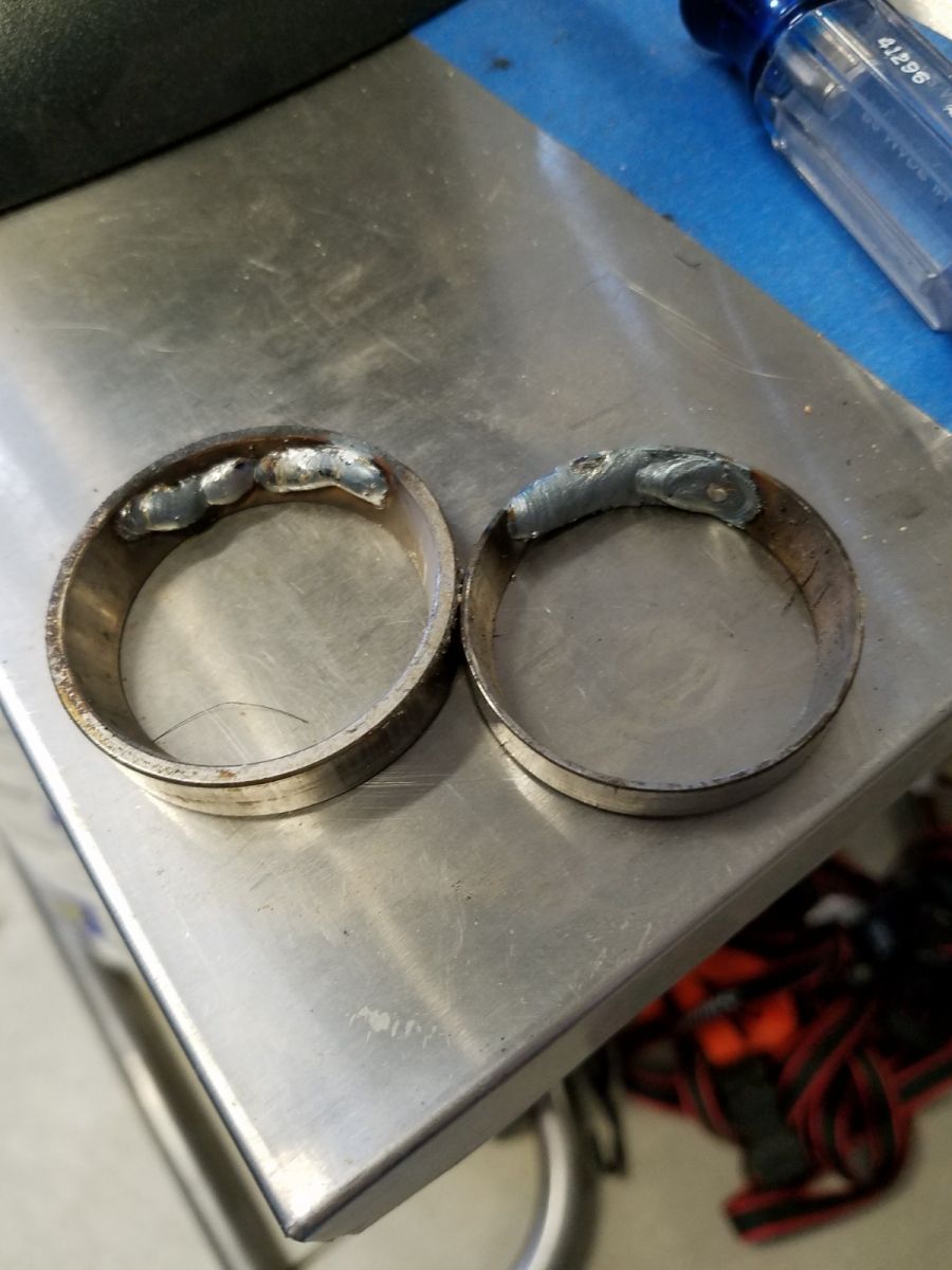

I used my MIG welder, and ran a small bead around 1/3 of the diameter of the outer races. The contraction of the weld when cooling allowed the races to come right out with little resistance. And the heat was not enough to damage the paint or the VIN sticker. Worked like a charm...

welding the races around such as skidmark done works a charm to shrink them and release them.
you can also weld a lil something(flatbar washer etc) across the race and knock them out from the other side with a long punch.
