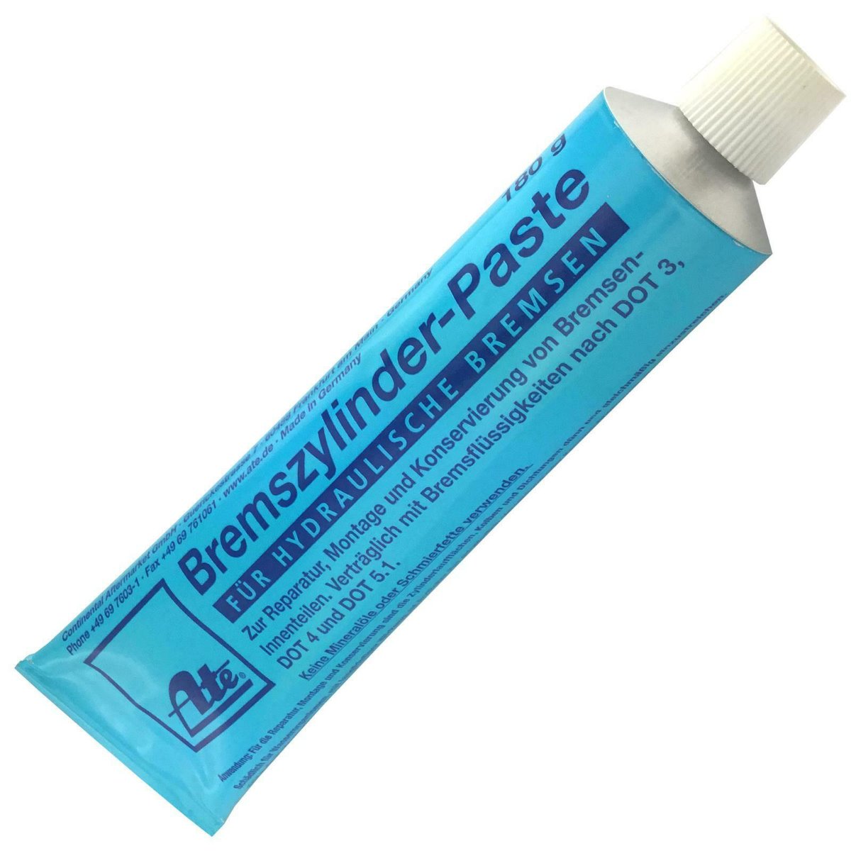

I use ATE caliper grease on every rebuild. It´s a glycol basis grease like the brake fluid and Made in Germany.
You can get it for 5 Euro and it´s compatible with DOT3, 4, 5.1 glycol break fluids.
Do never use Mineral oil or grease on internal breake parts!!!

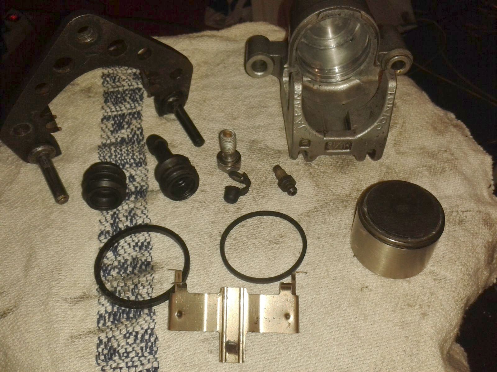

Ordered some Castrol red rubber grease, should be here tomorrow. I'll try that german stuff if im not satisfied with the red rubber grease.
www.amazon.com/GENUINE-Corrosion-Oxidati...-34-04/dp/B01L63SXSU
www.redrubbergrease.com/tips-how-to-brak...ith-rebuild-kit.html
they seem to swear by this stuff like holy water
ill be back with results, chances are where the seal sits isn't clean enough.
Would a brass brush cut up the inside of the bore? or should i just use like a nylon brush?

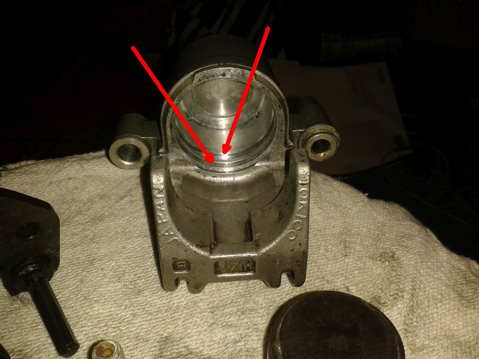

You have to clean the groove where the square shape rubber seal sits. There is a lot of gung build up over the years that put some more Tension on the seal and Piston.
Your caliper Piston will not move freely and will stuck in movement that cause the drag!!!
