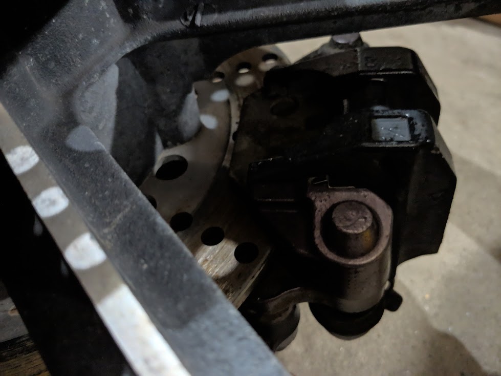

I needed to fix a fork seal so i guess im going to swap these parts in.
As i thought I can use a 750 wheel with two 550 single rotors (10.625" OD) and the 750 dual front calipers. The 550 rotors are required because the caliper mounts are higher up on the 550 forks. The attached photo is with the 750 rotors so the caliper doesnt line up.
