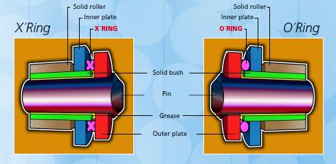

10 Sep 2018 08:58 - 10 Sep 2018 09:13TexasKZ wrote: The only difference between an X ring and an O ring chain is the cross-section shape of the rings. It is not visible once the chain is assembled.
The sprocket carrier bearing is number 601 in the diagram.
www.partzilla.com/catalog/kawasaki/motor...rear-wheel-hub-chain
Good find on the sprocket carrier bearing! I was in a hurry, and didn't have time to look up the part.
Sort of not visible.
This is the difference between the X vs the O-ring chains.

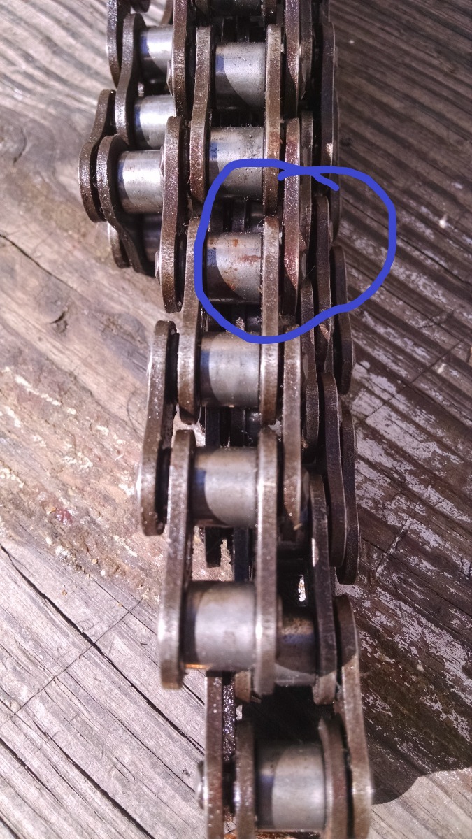

I just noticed this o-ring trying to make an escape!
This is a pretty worn out chain. lol

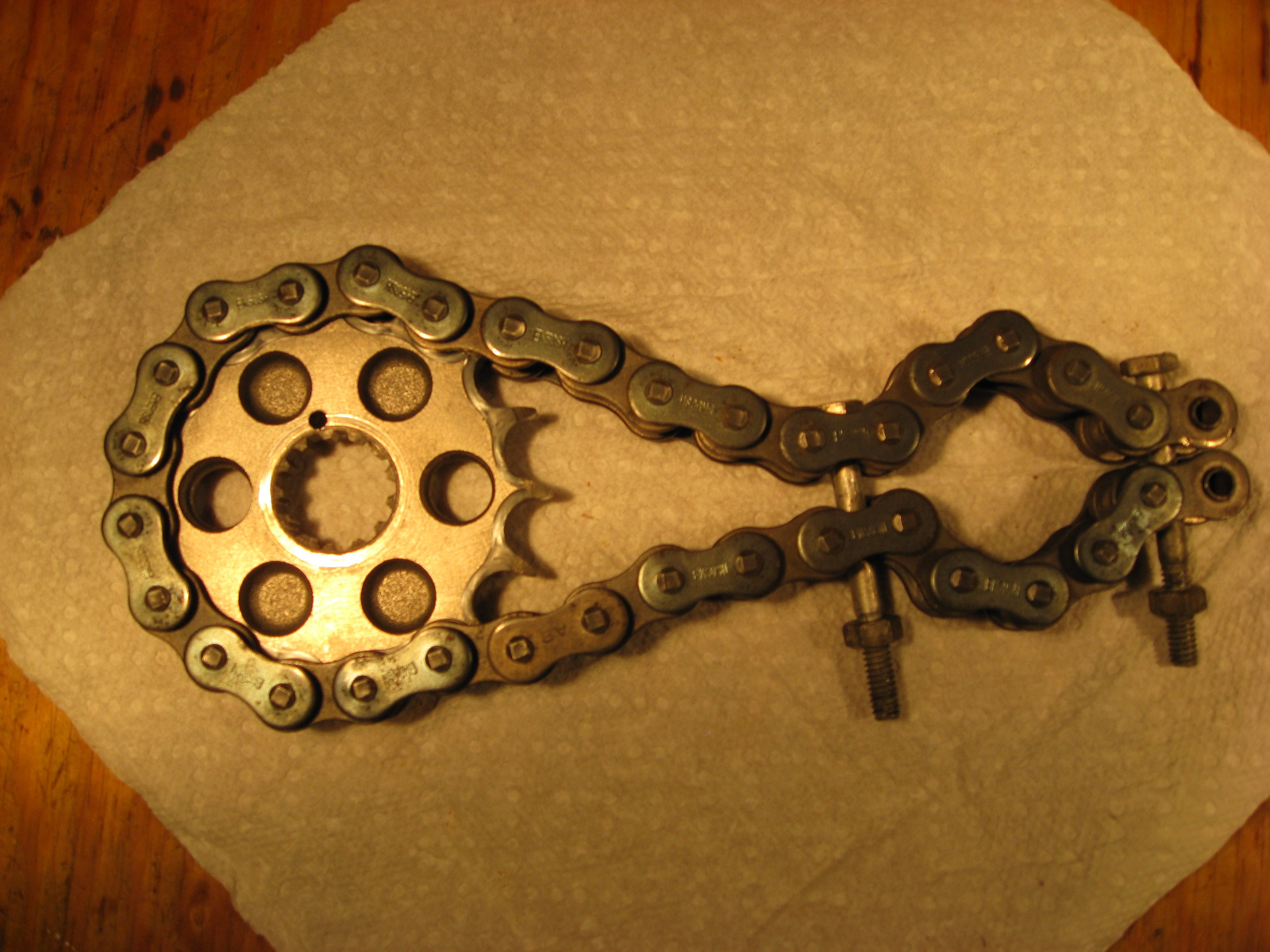

BTW – keep a length of the old chain because use can use it as a tool to hold the countersprocket when removing it.
Here's a cheap way to hold the countershaft sprocket using a piece of old drive chain with 2 thin bolts. Put chain around countershaft sprocket and bolt the ends together around the swingarm pivot. It cannot slip, you won't need a second person to stand on the brake, and you will not stress the brake components. Ed

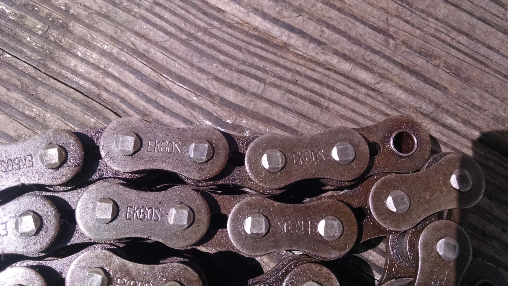

11 Sep 2018 06:30 - 11 Sep 2018 11:43TexasKZ wrote: I think you will find that the really high quality chains from DID, EK and such are well past $200.
This statement is especially true when buying most anything at a dealer. My local Kaw dealer want $150.00 for a chain that was ~$50.00 on eBay . Another local Honda dealer that does not, and would not sell junk parts, wanted around $250.00 for a off brand chain. (I personally know the owner and his main mechanic)
While I try to help support local businesses, I also have myself and my old kaw to support. My original "endless" (no master link) 630 EK60S chain came on the bike . The chain I bought off of eBay is a EK SRO 630 chain . It cost me ~119.00 with free shipping.
