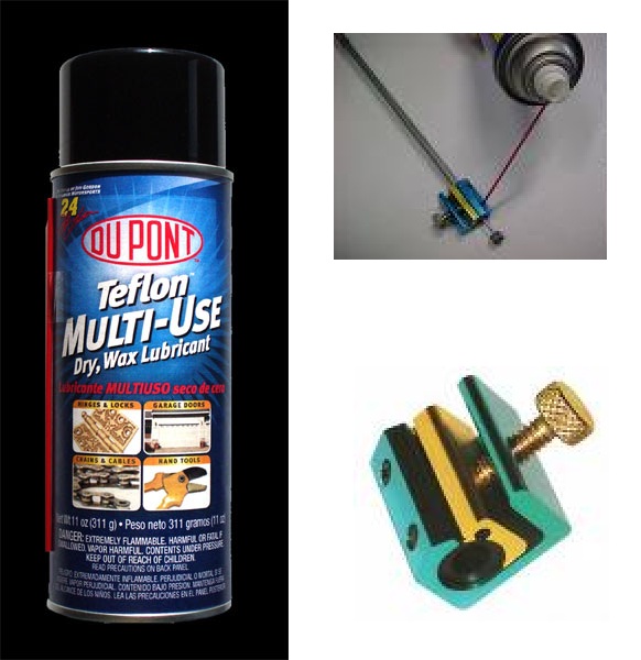

23 Jul 2018 19:47 - 23 Jul 2018 19:53I like the Dupont teflon lube because it's inexpensive, clean, and lasts a long time, And also serves as a fine chain lube with minimal sling-off.
I also use it on my chainsaw chain, and many other places where spray lube is useful.
If the cable is full of gunge, any spray could be used initially, such as carb cleaner, WD40, Liquid Wrench, etc., to help remove a lot of the gunge before re-spraying with your lube of choice.

Patton, I see that you like the Teflon Multi-Use, but I was wondering if you know whether or not Dupont now recommends the product for the drive chain? In a WebBikeWorld article from 5 or 6 yrs ago, Dupont no longer recommended the teflon multi-use when they changed the formula & said to use teflon chain-saver on the drive chain instead. Then I saw another wbw chain lube article comparing the multi-use to the chain-saver which was thicker. I use Liquid wrench chain/cable lube which is pretty cheap but have been thinking of switching to a Dupont product to reduce or eliminate chain sling. Thanks.
My cable luber. clear tubing shoved together & into the yellow funnel & fitted onto the cable, then hung from the eaves w coat hangers w some masking tape to make sure it stays together. the funnel helps to redirect any excess back into the cable. kind of red-necky, but it works.
